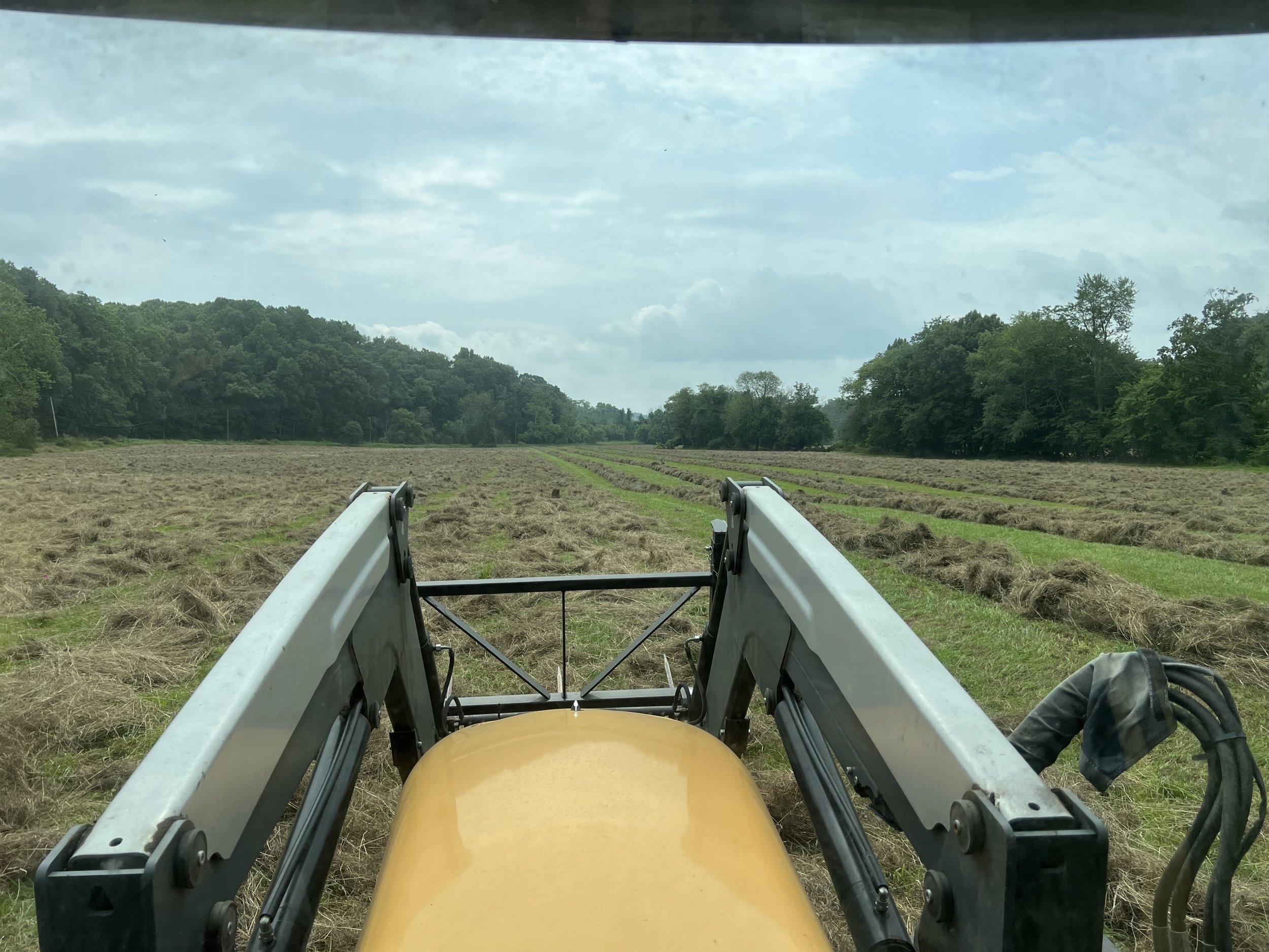

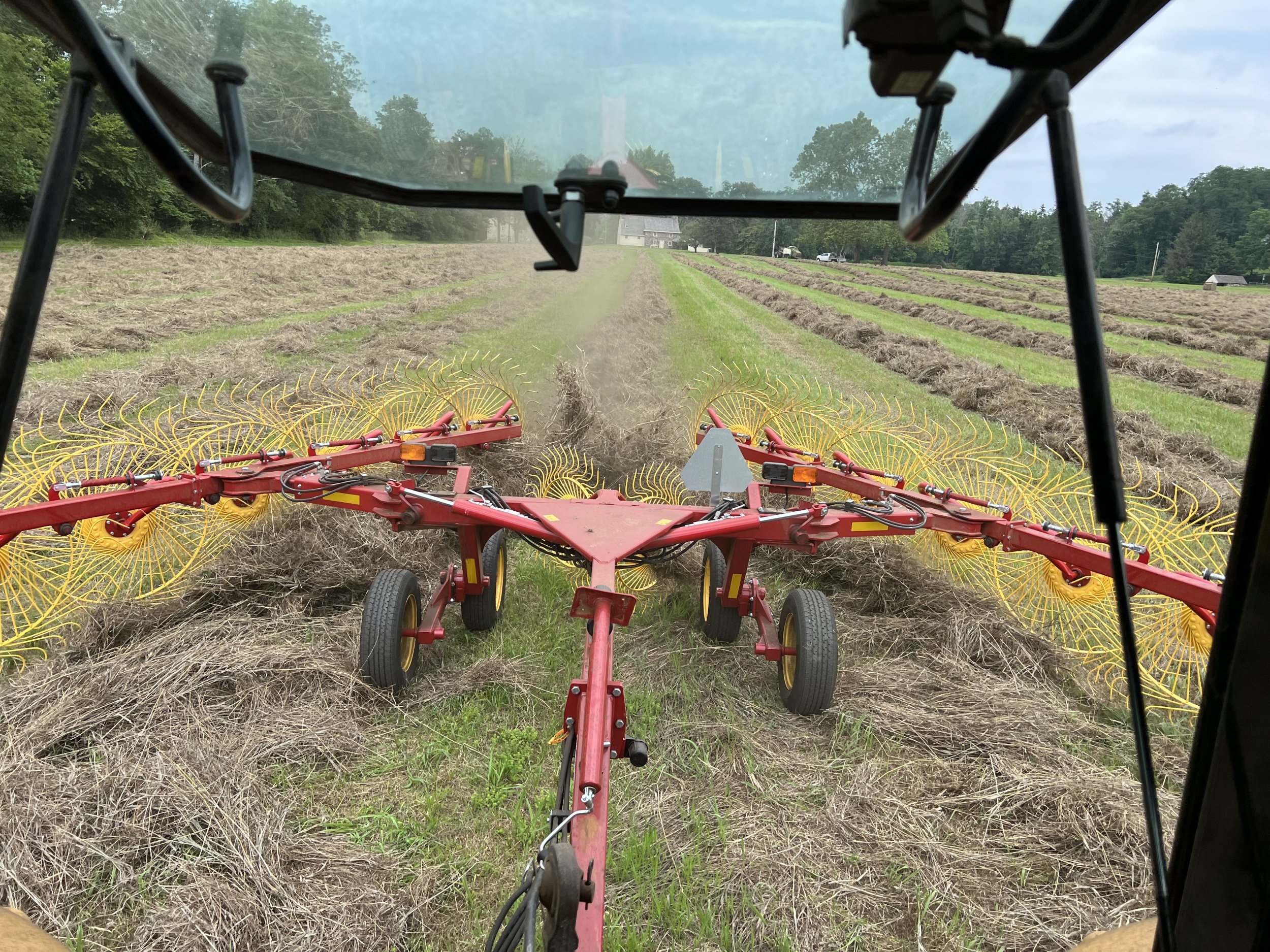

Sometimes you get caught with unexpected rain and it turns a normal haying job into a rescue mission. Teddered from 8-10 AM. Broke out the rake at 10 and started raking. This wheel rake is so fast, it makes one-man raking & baling of large acreage possible. My son took a well needed vacation with his girl, so I’m on my own through the 4th.

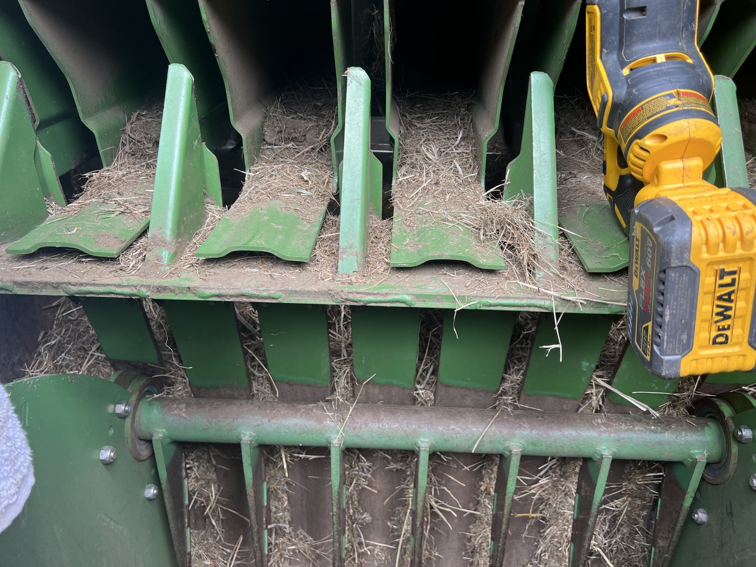

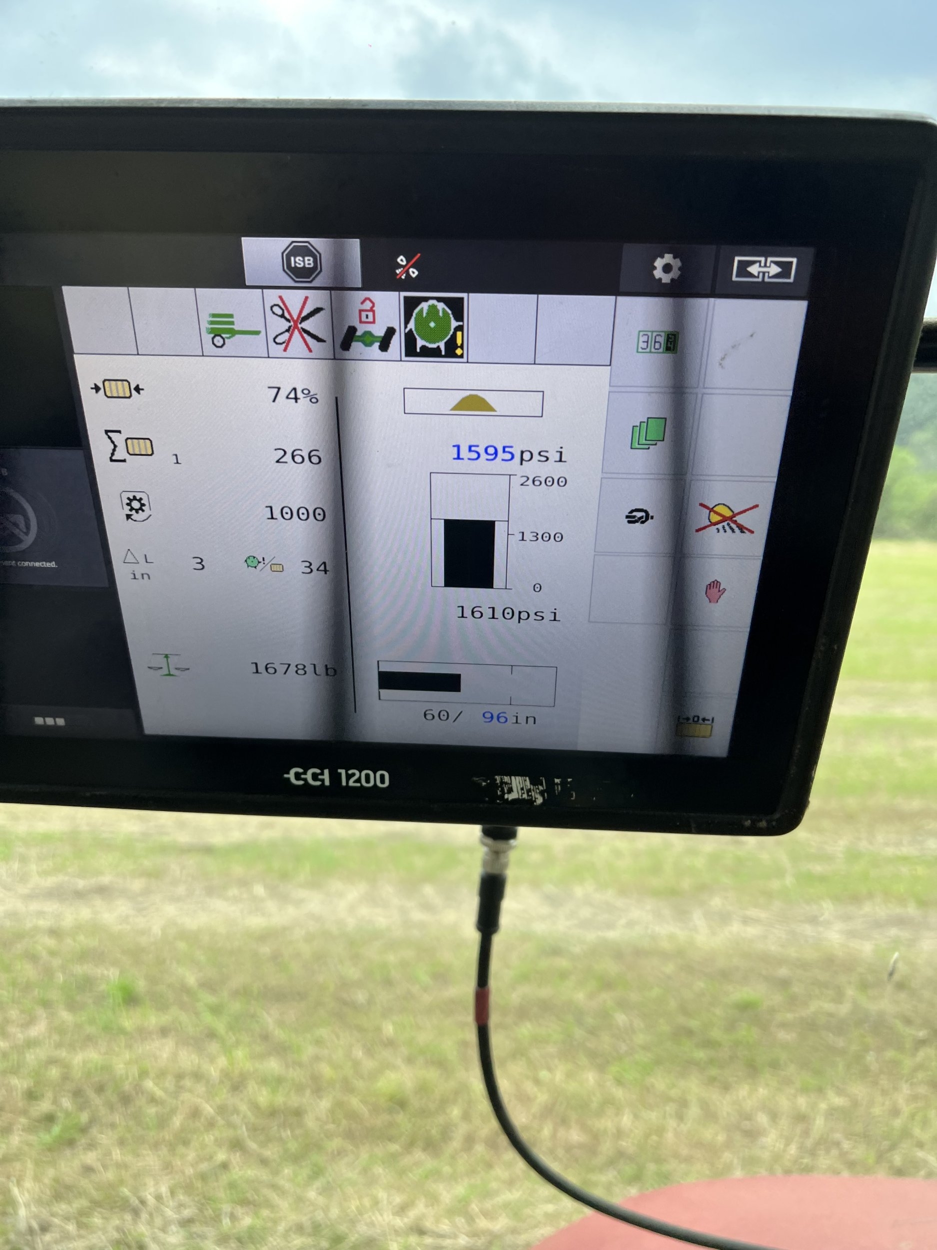

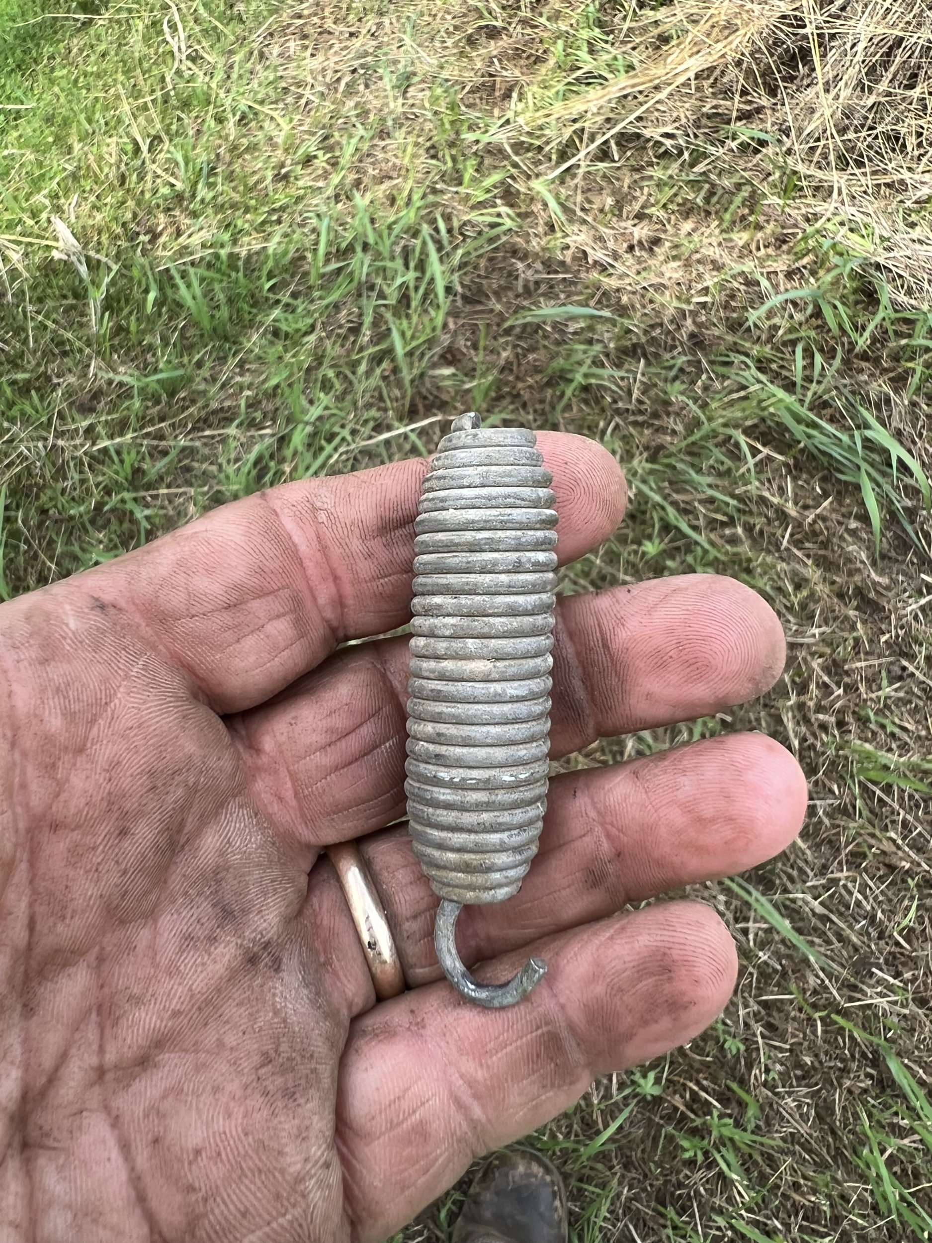

Made about 30 big bales, then the forecast changed to rain in a few hours. I was about 5/8ths done. Started to hurry and while baling the perimeter last outer edge (damp & crappy) I plugged the baler and the slip clutch warning went off. Packer fingers jammed and the slip clutch hammering away. Also broke off 2 springs (happens in bad jams like that sometimes).
With no parts available, I went a few miles down the road to our locally owned amazing mom & pop hardware store. Still open Sunday at 4:45! I could not believe I found 2 roughly comparable springs. Took them back and installed them, busted up some knuckles trying to stretch one to hook on.

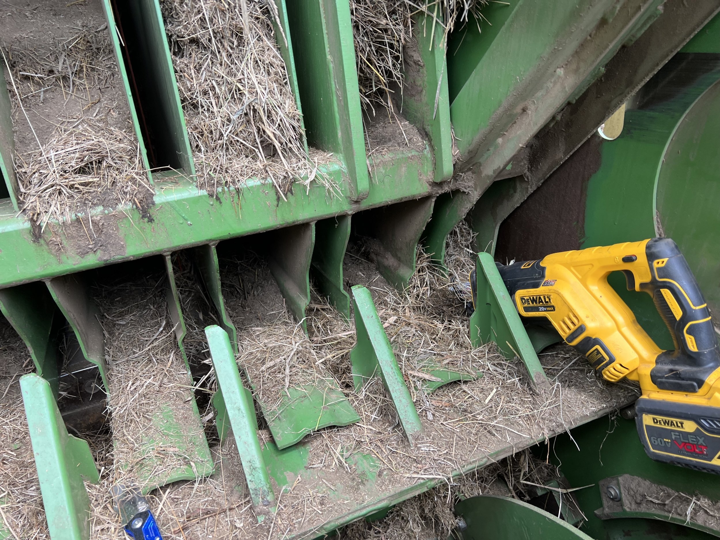

Thought I still had a chance to finish up, but the baler was still jammed. I climbed down inside the baler and began the hot & dusty task of unclogging. Fellas, you aint never seen how jammed a baler can be until you jam a Krone big baler. It takes a LOT to jam one. That’s what I get for hurrying before the rain. I took a sawzall and a 10” blade and actually began sawing the plugged up mess, then the rain hit.

I have a hand full of springs in my truck that look like the would be perfect for that. They are used on a ADS conveyor dishwasher. They hold the centric blocks against a cam follower bearing. Definitely a bear to hook back when one breaks! Surprised the hardware store had one. I have never had good luck finding one at a hardware store.

#167
So back to the plugged baler.
Took me 11 HOURS to clear the jam from the baler. Hay packed in like concrete. I used a sawzall with a 12” blade to cut the hay out a little bit at a time. Imagine a 4’ x 4’x 12” thick flake of hay packed in at 1400lbs/sf. It’s like cutting wood.
Worked inside the baler chamber. Hot & dusty. My hands & forearms look like I was in a street fight.
I also opened the hatch on the bottom of the baler and cut upwards with the sawzall. After about an hour, I’d get in the tractor, reverse the flywheel then try to “bash” the stuck wad of hay.
After about the 10th try, listening to the banging of the slip clutch, it finally pushed through at 5pm.
A lost day. I could have baled an entire field, but had to give that up to make repairs. I did make about 12 bales from 5:30-7.
Then you guessed it, it rained again….
