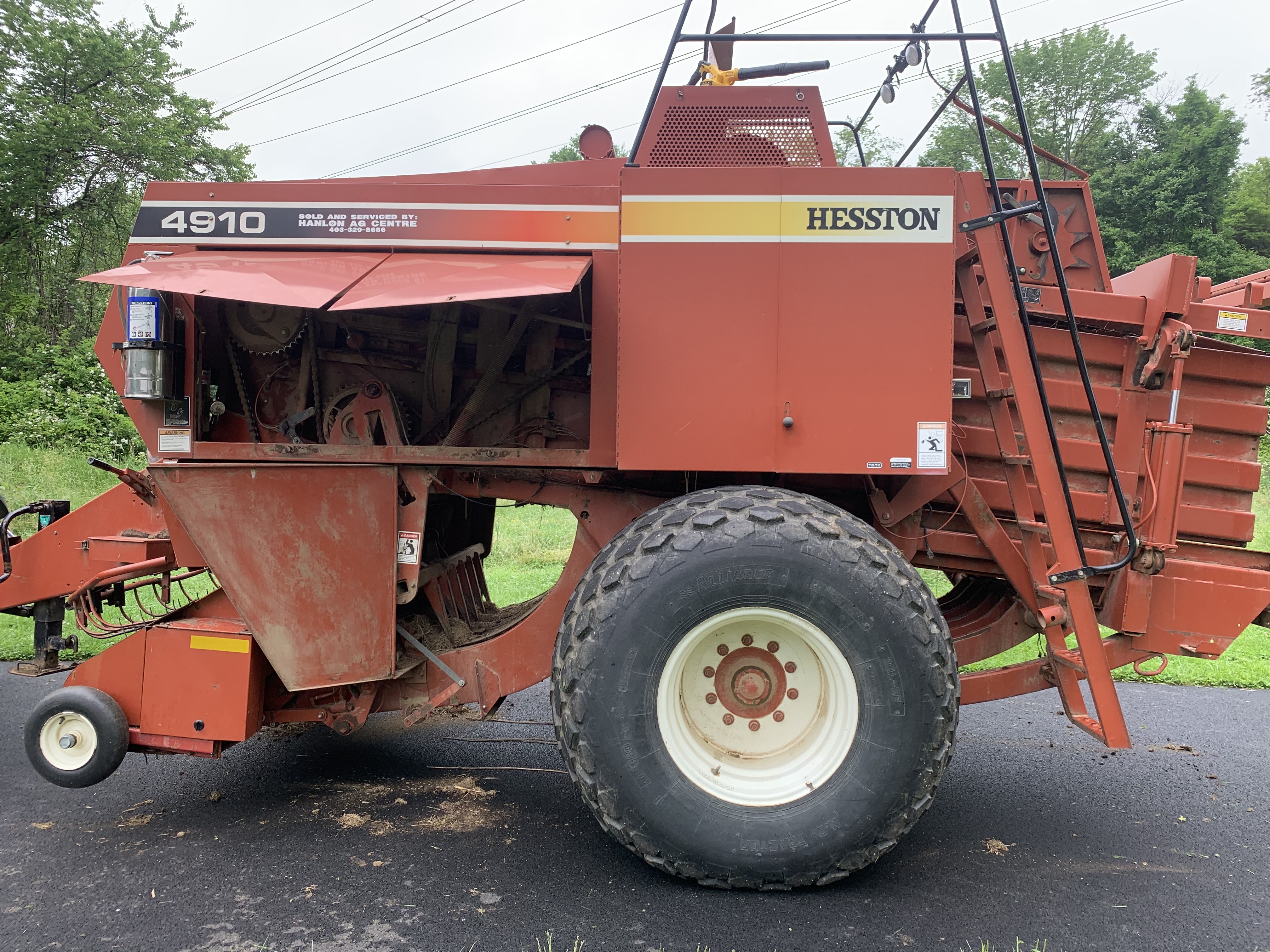

Here is my former Hesston large square baler I paid 12K for it in 2019 and it was unreliable by the time I traded it. Knotters were in need of extensive work. Pretty simple & easy to work on though.
Up here $6,000 would maybe buy you a parts baler.
You need to spend at lest $50,000 to get a reliable baler ready to go into the field, and it could develop extensive problems at any time.
