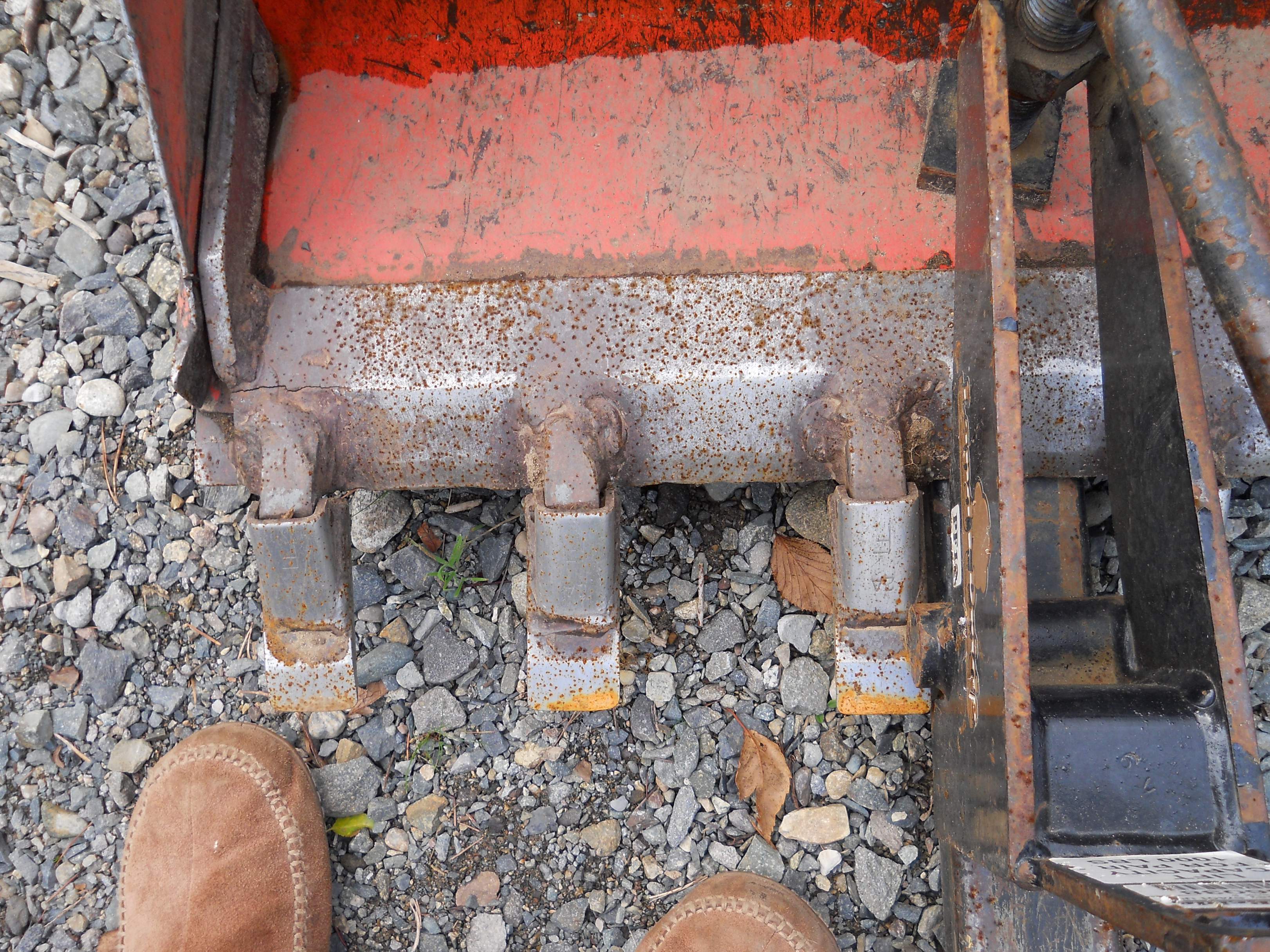

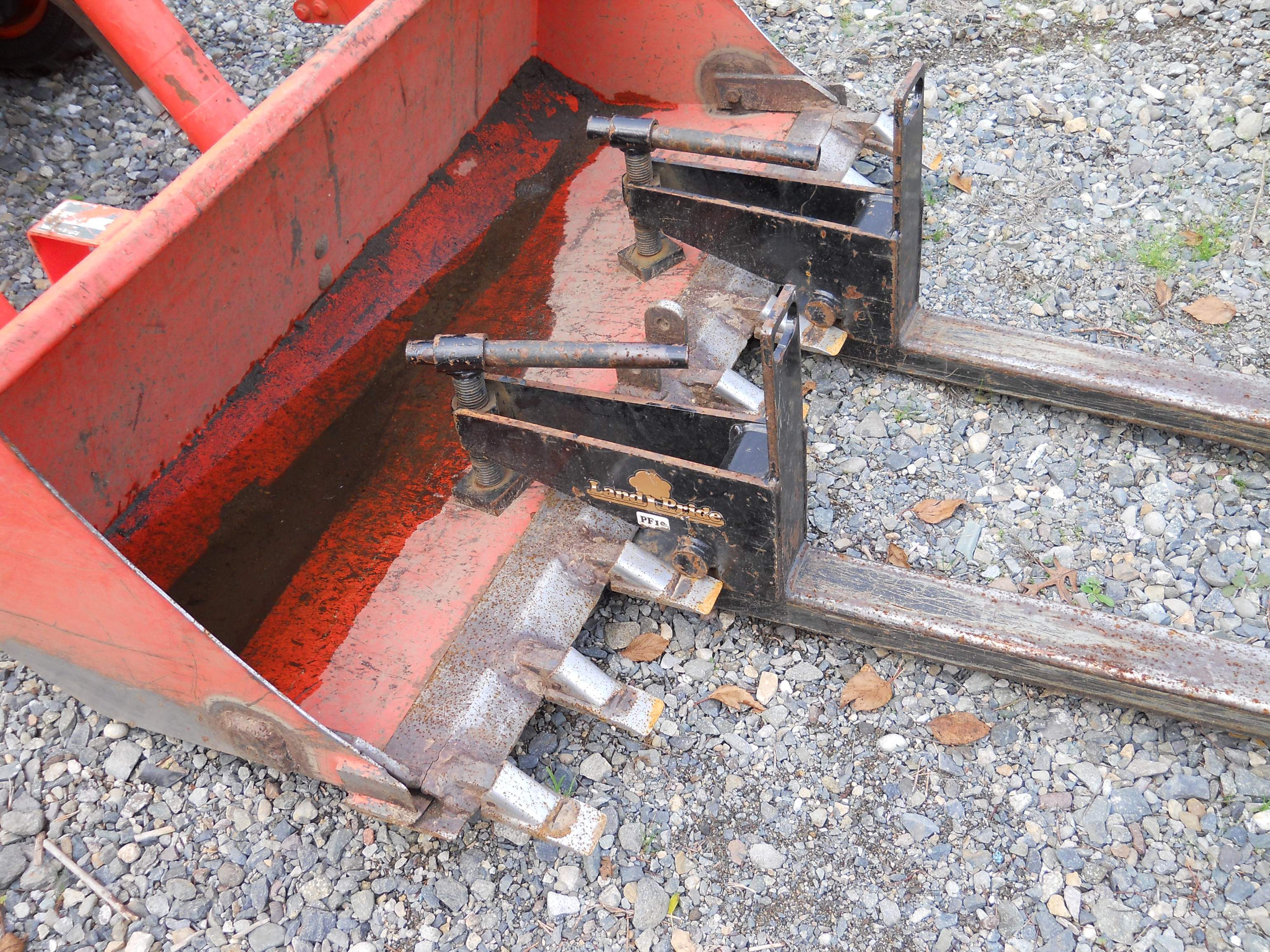

All the rocks are below the black humus. We have plenty so keep yours. Below in this area is glacial till. I swear the rocks breed faster than mice. The "rings" are where I attach my hitch receiver attachment using a long 5/8 hitch pin. I also spaced the teeth so I could attach my clamp on forks w/o removing the tooth bar. One space is perfect for 40 X 48 pallets.

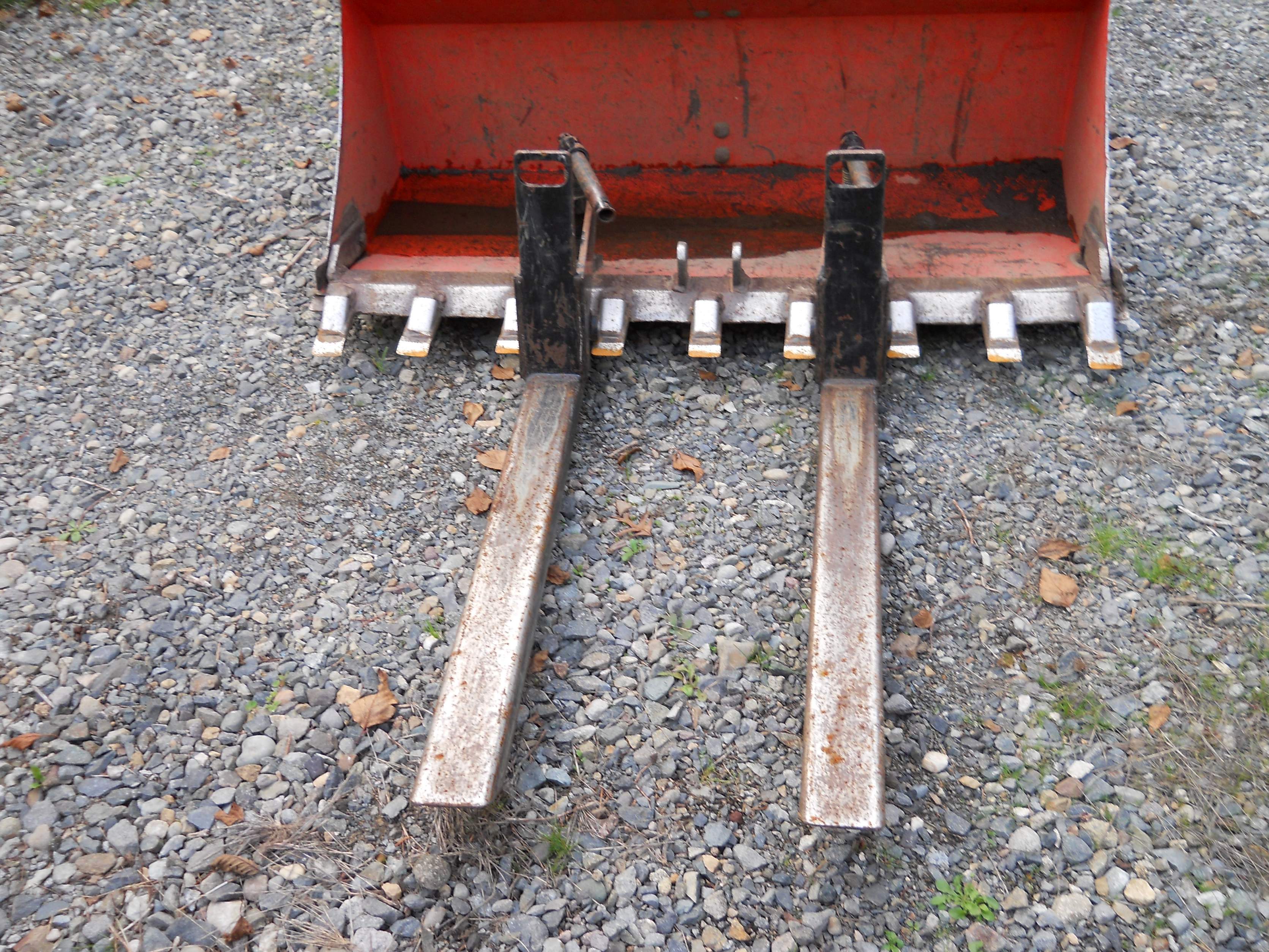

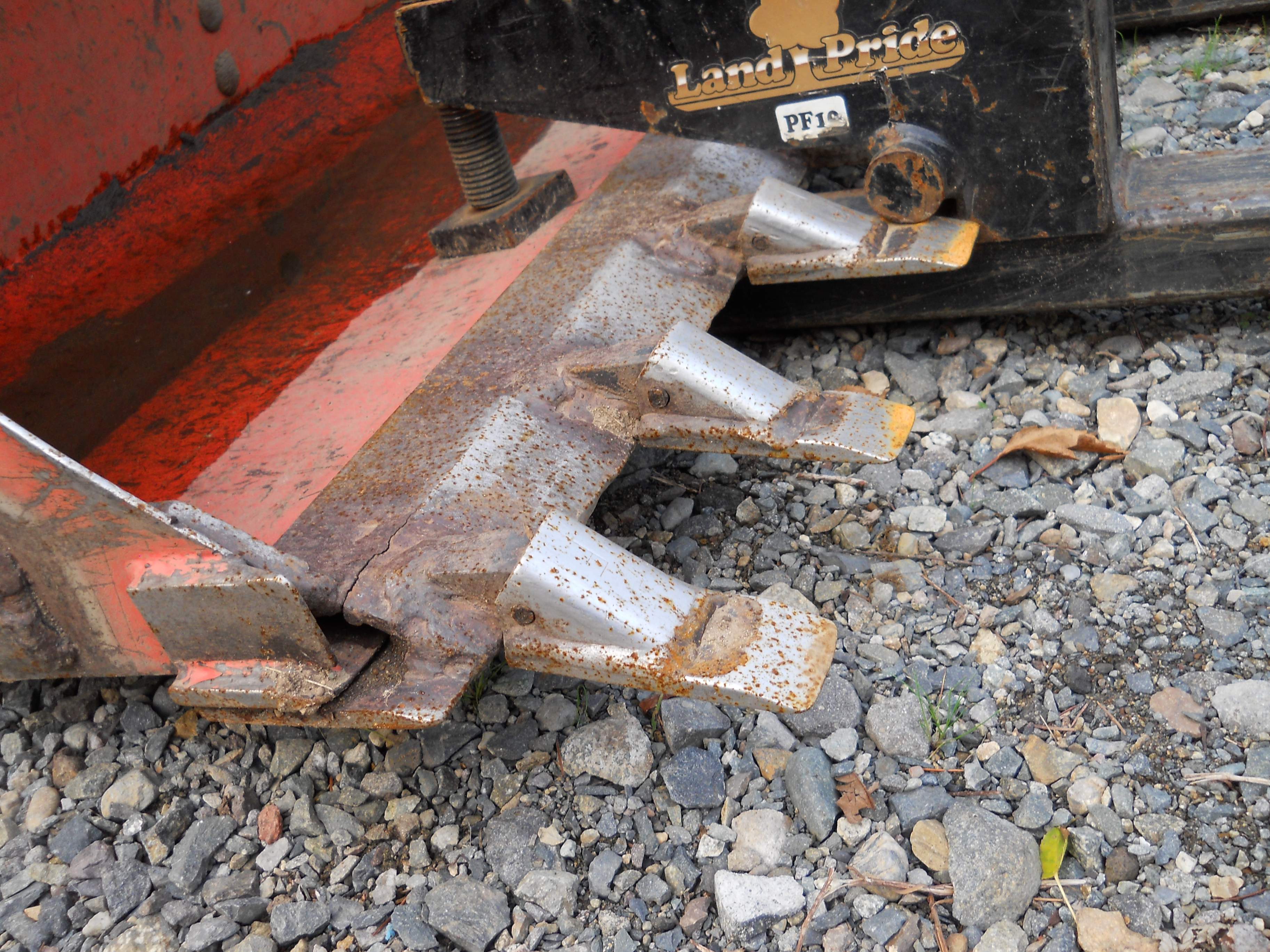

Here you are: DSCN1242.jpgDSCN1243.jpgDSCN1244.jpgDSCN1245.jpg
Sorry it took so long. Note I spaced the teeth so I can install my bucket forks between. I have four forks I use for brush handling
Ron

Thanks for that, now you have me thinking about some forks!
So did you make the tooth bar complete, is that small crack on the end a crack in the root between 2 pieces of flat bar?
