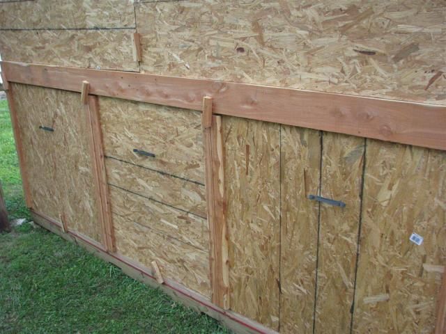

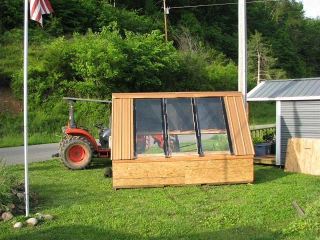

Kiln is done except for flat black paint:

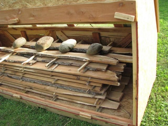

Cherry loaded on stickers to dry:

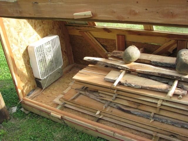

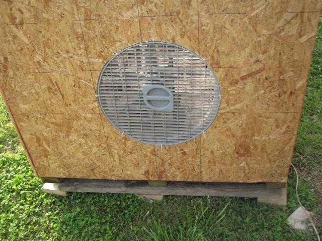

The rocks are for weight to help keep the boards straight. Exhaust fan installed:
   / The Log house Project begins........
#1,184

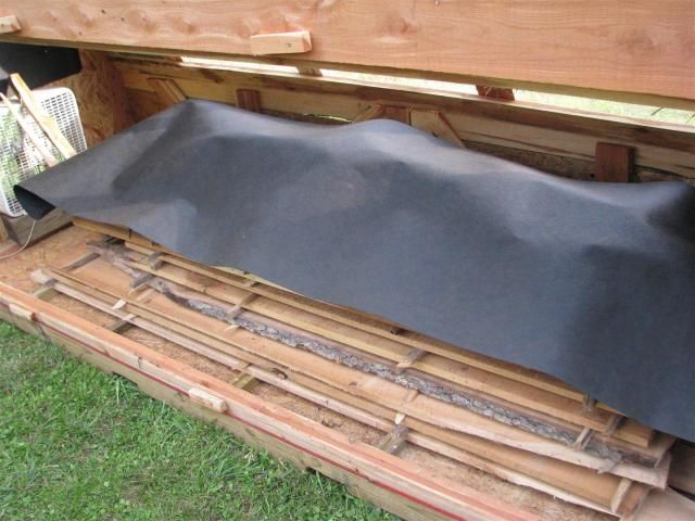

Tar paper to help with heat buildup:
All buttoned up:
Rick,
About how long before it will be "cooked" and you can stick a fork in it? Will you finish with a clear coat or something different?
hugs, Brandi
#1,186
Rick,
hugs, Brandi
Brandi, it's been drying in a shed for over 2 years, so I am guessing if we get a couple of weeks of full sun, that should run any lingering moisture out of the wood. I need to stick it with my moisture meter...not a fork:laughing: and record the moisture content.
This cherry was courtesy of a rare tornado that skipped through here tearing up a barn, a few roofs, stands of trees and power lines. Well, Lesley is thinking a pale green stain that is opaque and shows the grain. I'm even ok with painting it since we are in "woodgrain overload" everywhere else. But, I am going to build the cabinets first then let her decide if and what she might want to color them with.

Paint? Painting cherry would be a grievous sin and you would surely be banished to the dark side forever.:confused2:
Nice job on the kiln. I assume that you are manually controlling the fan. You may want to consider a snap disc thermostat in the future.
http://www.ebay.com/itm/Solar-Panel...854?pt=LH_DefaultDomain_0&hash=item3cc6196d16
Are you going to monitor the temperature inside the kiln at full sun? Im wondering about the amount of airflow.

Pacer I've run the gamut....everything from a Fire Pole to No Stairs to a Ladder;). I really want the spiral, so I am just going to take my time, do some other things and see if some money cannot catch up to me. I might even build them myself...might, since it would be a huge undertaking.
Mike, I hear ya....yes PAINT
. But, I'm still thinking a translucent stain, or just doing the frames, or doors or vice versa. Gotta get 'em built first, then step back and decide.
Yes, I will be sticking a digital thermometer in their asap.
   / The Log house Project begins........ #1,190
The wood gods might forgive you for translucent stain but not paint. :) A mix of stained frames and oiled doors might look nice. Concrete counter tops would top it all off.
One advantage to a kiln that most people do not think of is the high temperatures kill the creepy crawlers. :thumbsup:
Let us know how high the temperature gets in full sun.
