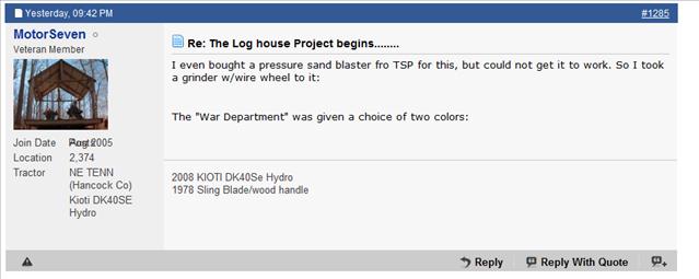

I even bought a pressure sand blaster fro TSP for this, but could not get it to work. So I took a grinder w/wire wheel to it:
The "War Department" was given a choice of two colors:
M7,
Your pictures are not showing up on my PC (Windows 7 IE 8) using the new Forum Software. I can see the pictures on my Android using the Android TBN app. I have posted a screenshot of what it looks like now.
Obed
