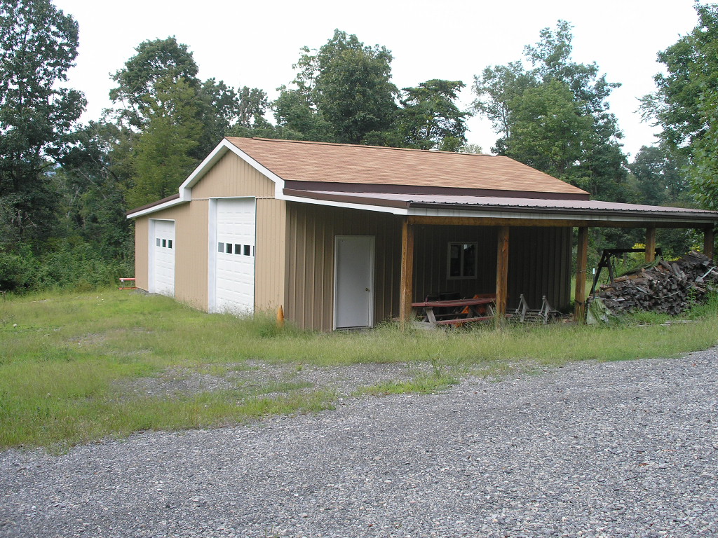

I'm not sure if this will help in any way. This overhang has a simple metal roof over open rafters and I get lots of rain under it. I haven't paid much attention to the conditions but I have noticed that sometimes there is frost on the underside of the roof. The overhang is pointing east and as soon as the sun peeks over the mountain the rains begin.
