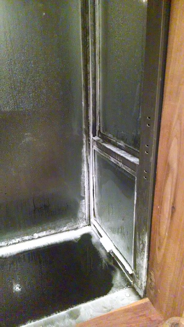

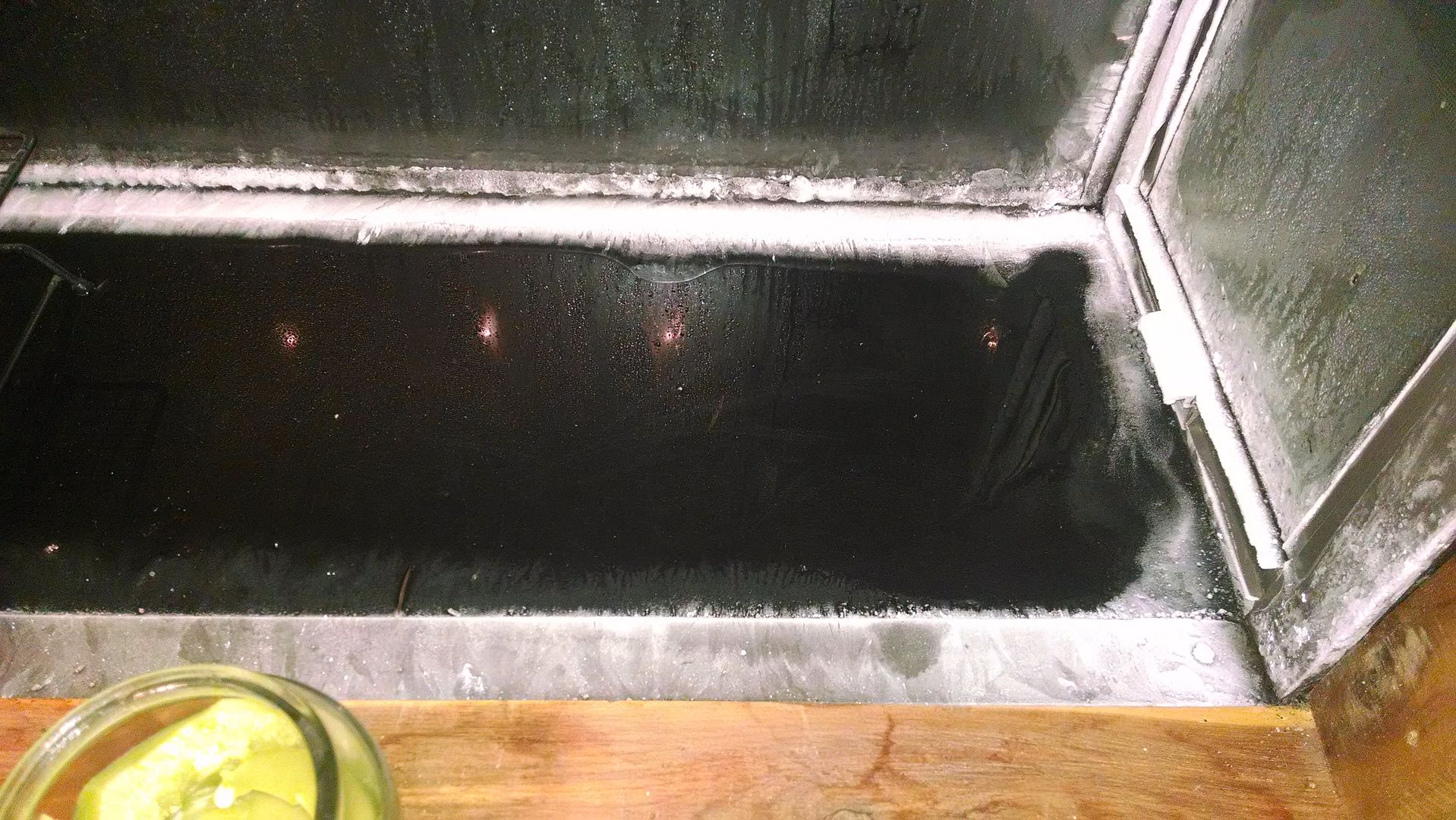

-2 this AM, just re-loaded the stove. I'm kinda glad for the cold snap, it has let us know where all the air leaks are in the house. The biggest culprit is the 3 French Door thresholds.....I completely forgot to seal them underneath from the outside with foam, then put on a cover board and run a bead of caulk where the flooring meets the inside threshold. I also knew that the garden window was a poor design for cold weather but I didn't expect it to freeze like this. Yes the panes are double insulated, but the blastic bottom is not so I need to add soe of that 2" high density foam to it:
Les thinks a heavy curtain that could be hung on hooks across the opening would help out and I agree. Yesterday/AM the whole bottom of the thing was a solid sheet of ice.

What is your indoor humidity level?
Are you running a humidifier?
We heat with a heat pump forced air system. Of course the heating elements in the inside unit are doing most of the work at this temperature.
We do run a humidifier to keep the moisture up. With the outside air being so cold relative to the inside, our inside gauge still only shows 34 % this morning relative humidity to the indoor temperature of 73 deg. Normally it is 40-50%.
Even so, on the bottom edge of the double insulated window panes and even on a routed lifting recess in the wood
frames of the glass double hung style and fixed style, a line of ice about 3/8" up on the glass forms similar to
what you show in your pictures. At warmer outside temperatures if we get the inside relative humidity too high this will be water droplets.
Ours is a result of condensation from the indoor humidity against the cold glass surface rather than an air leak.
In the flower room where my wife raises orchids there is an indoor fountain to add even more humidity to the room
so the icing is a little worse in there.
Your garden window bottom is bound to collect moisture from the inside air. We don't have one, but I know people who have to sponge mop theirs a lot in some weather conditions.

It's at 43% right now & looking at your pic, we have some of that light frosting on some of the windows too. We have pretty wet winters here, so any air leak is just contrubuting to the problem. As soon as it warms up a bit I am going to do some caulkin' & foamin'.
