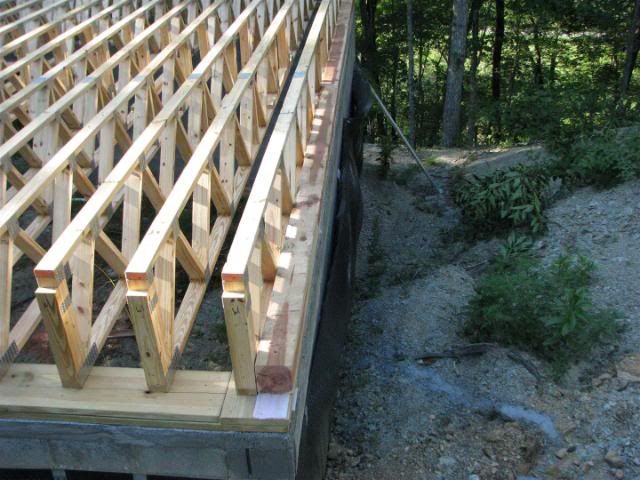

Done( the double and the reinforced trusses are for a future river rock fireplace):
   / The Log house Project begins........
#232
The 2x8" strongbacks go between the trusses in 3 runs the length of the building. The 2x4" boards go in that cut out at the end of each truss. The Advantage lifetime warranty 3/4" T&G plywood will get glued and screwed to each truss:

I got half of the Sub Floor down and 2 of the 3 2x8" Strongbacks in place. I have to say those Strongbacks are a pain in the arse to screw in...lost of twisting and bending.
