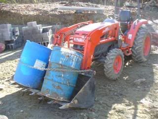

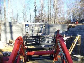

Finally....TRACTOR pic's:
Haulin water for the block layers
Fixing to set the 12' load rated Lintel
And it's set
