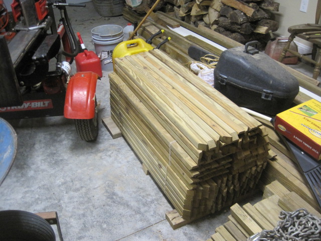

Hey, I've got some pressure treated wood filling up half of our garage we don't need. We could let it go cheap if you're interested.

Can't you return those spindles?

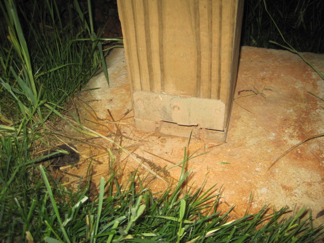

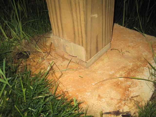

Tomorrow I will cut the 6x6 PT piers that the 6x6 cedar beam will sit on. Tin arrives tomorrow evening too....
M7,
Are you going to put anything under the piers to keep them off the concrete to prevent rotting? We used the hardware in the pictures to keep our porch posts/piers off of the concrete. If any water puddles or condensates on the concrete, the bottom of the posts will stay dry.
I just took the pictures in the dark so I hope they came out well enough.
Obed
Nope. We just asked the building supply company and they said no. They claim they are now using a different vendor so they won't take them back. They've been in our garage over a year so I don't really blame the building supply company.
