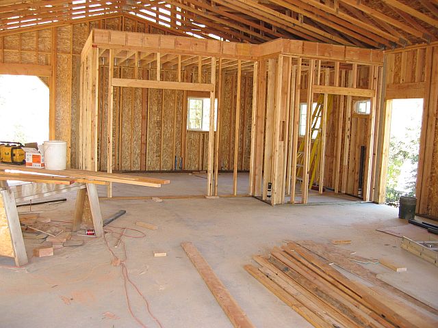

Inside frame view of the office and bathroom. Notice the arch truss roof system. Gets more that 12' clearance in the center 1/3 of the building with 10' outside walls. Allows for car lifts.

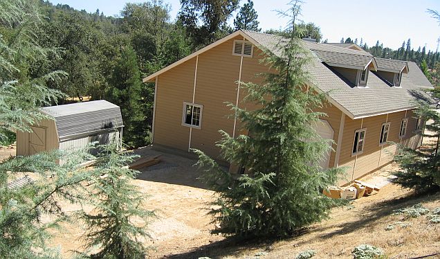

Back wall view. This is best view I could get and the small back garage door is still partly covered by trees in the way.
