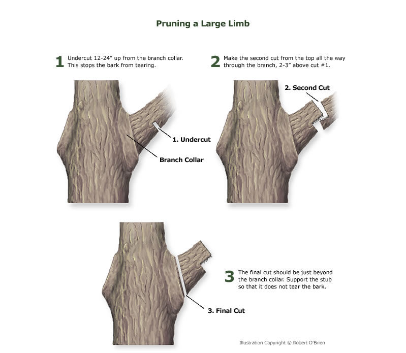

In your video, we notice many times you start your cut from the top, then the branch starts to fall and hangs. Then you have to mess around with trying to release the hanging limb without pinching your blade.
As others have mentioned, you can almost entirely eliminate that issue if you do a small undercut first, then do a downward top cut an inch or two outboard of the undercut.
Doing it this way, the branch will just snap off and drop 99% of the time VS swinging down and being held by the outer cambium and bark.
Here's a picture of what we're talking about. I never knew about it until I read my chainsaw owner's manual many years ago. I tried it out and it works great. Give it a try. You'll like it. (y)
You'd only be using steps 1 and 2 unless you want to remove the branch entirely from the tree. Then you step 3.

One wrong step and you will be in the ER or a hospital bed. No safety gear (eyes, helmet, harness, etc), no safety platform to work from, terrible trimming technique (make a small cut on the bottom side of the branch, then cut the top to keep them from peeling).
