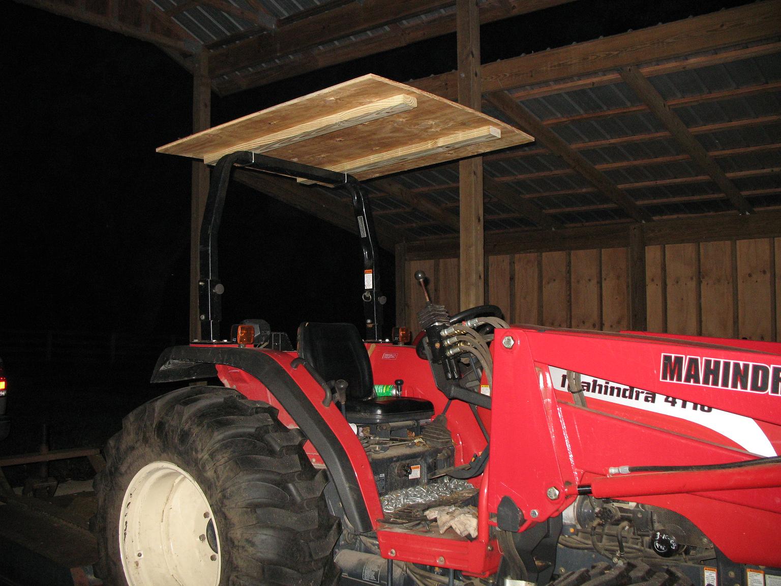

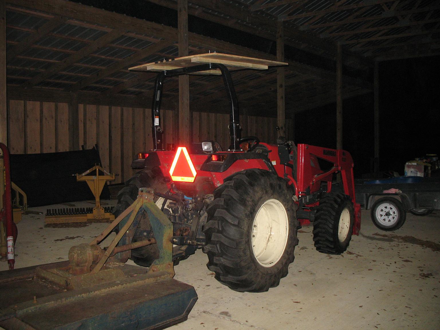

I made this for my dad's Mahindra 4110. Not finished in these pics (need to take a couple more). Since this stage I added diagonals, rounded all corners & edges, sanded it as needed (aka minimally, painted the whole thing fence coat flat black, cut off any extra U-bolt length & put caps on 'em.
Cost was a piece of 5/8" plywood, one 2x4, 2 lag bolts, 2 few little wood screws & four square U-bolts. Probably 50 bucks total.
Making this same roof for my L3940 is #2 on "My List" right now :thumbsup:
This outta help with the sun baking, at least some.
(I've been meaning to take a couple more pics now that it's done; Posting these un-finished shots outta prompt me to do so now (I don't think I had already posted these, anyway?!?)
