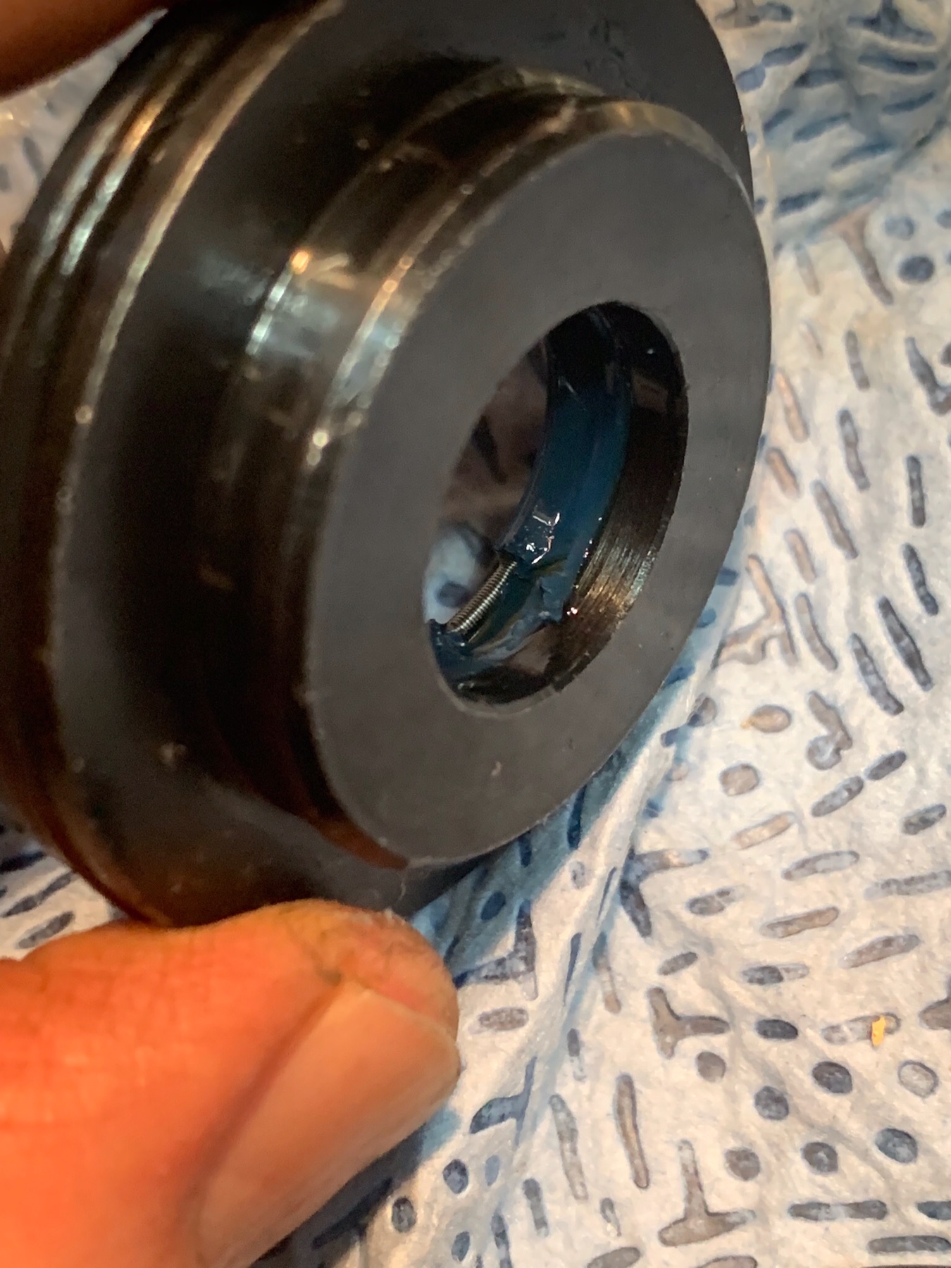

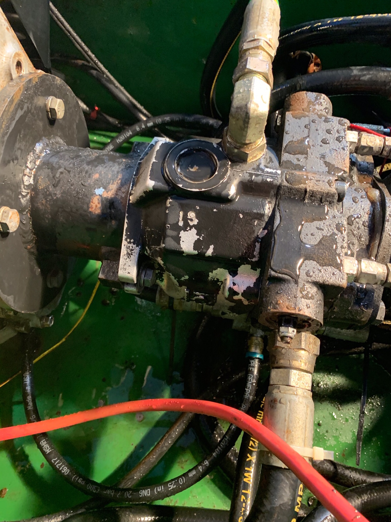

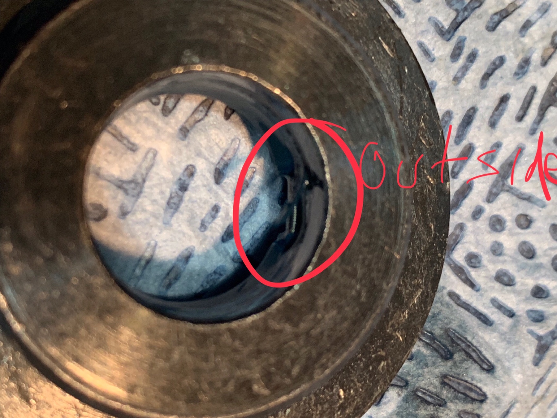

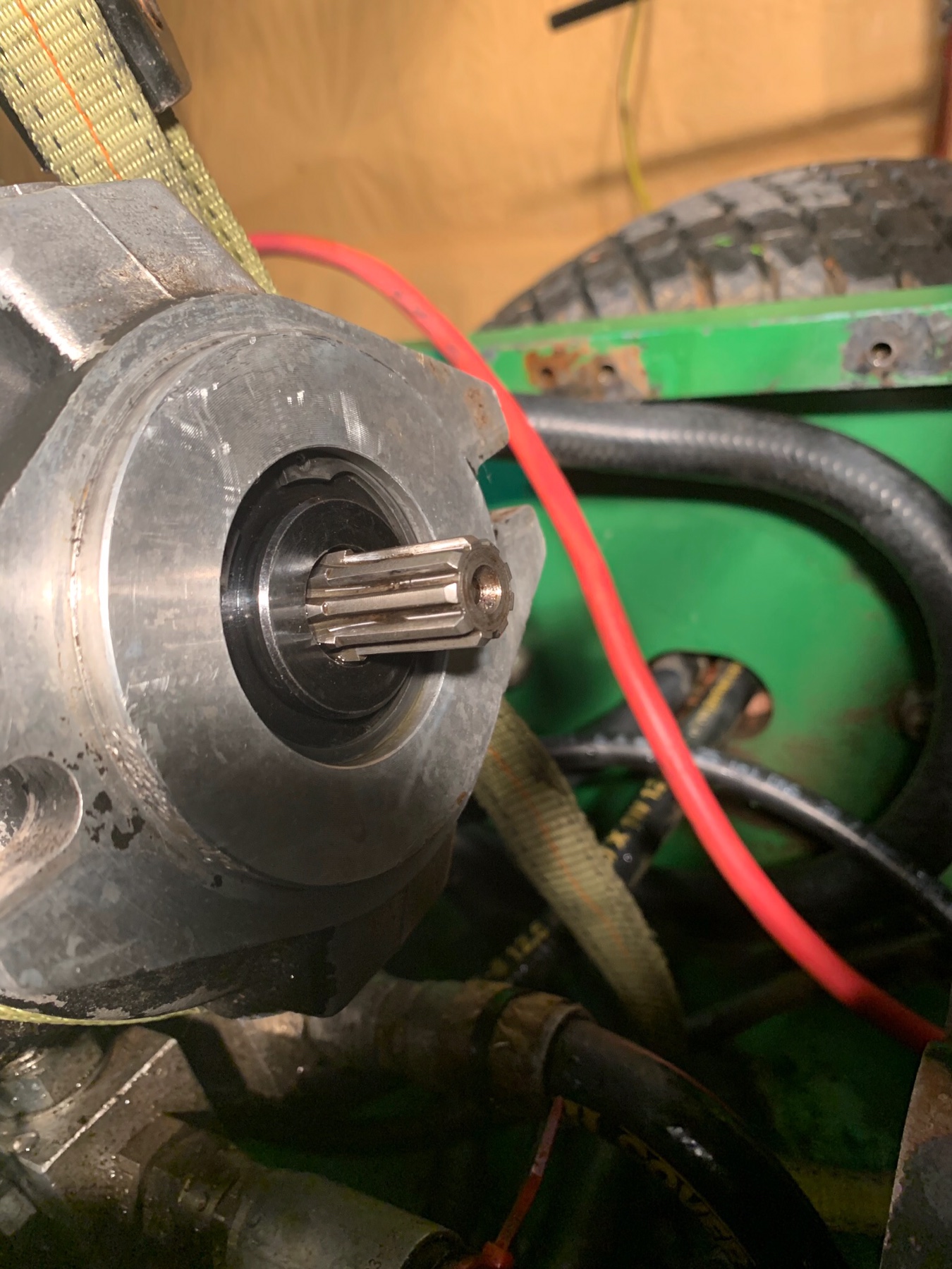

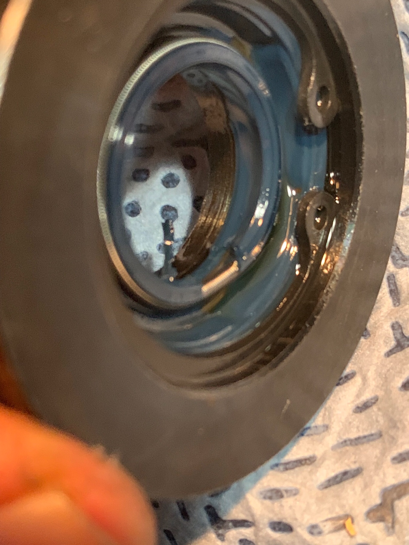

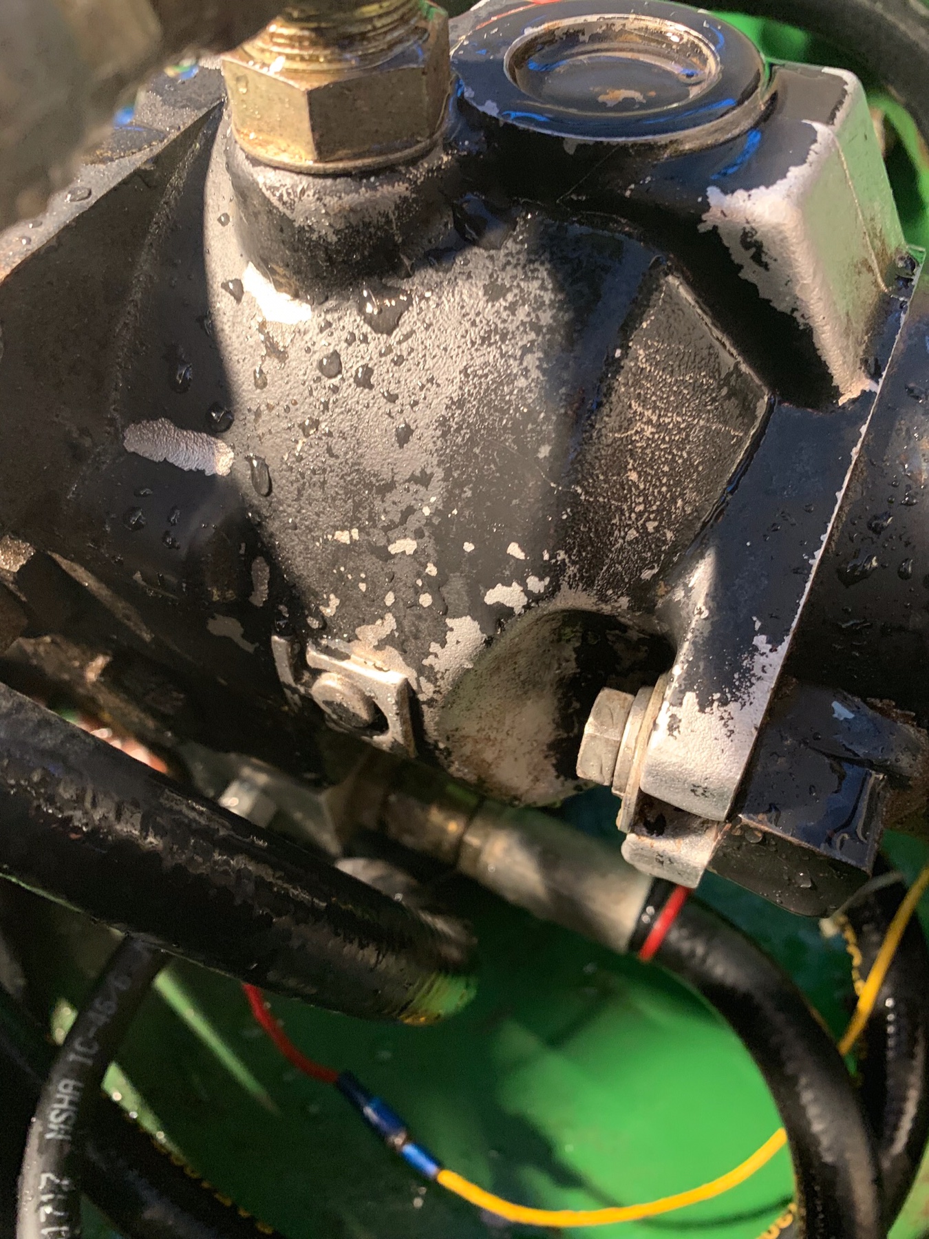

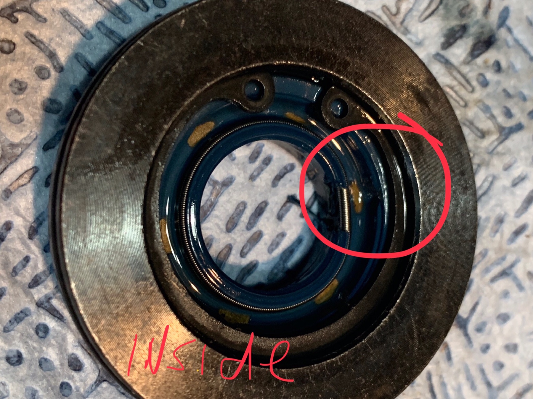

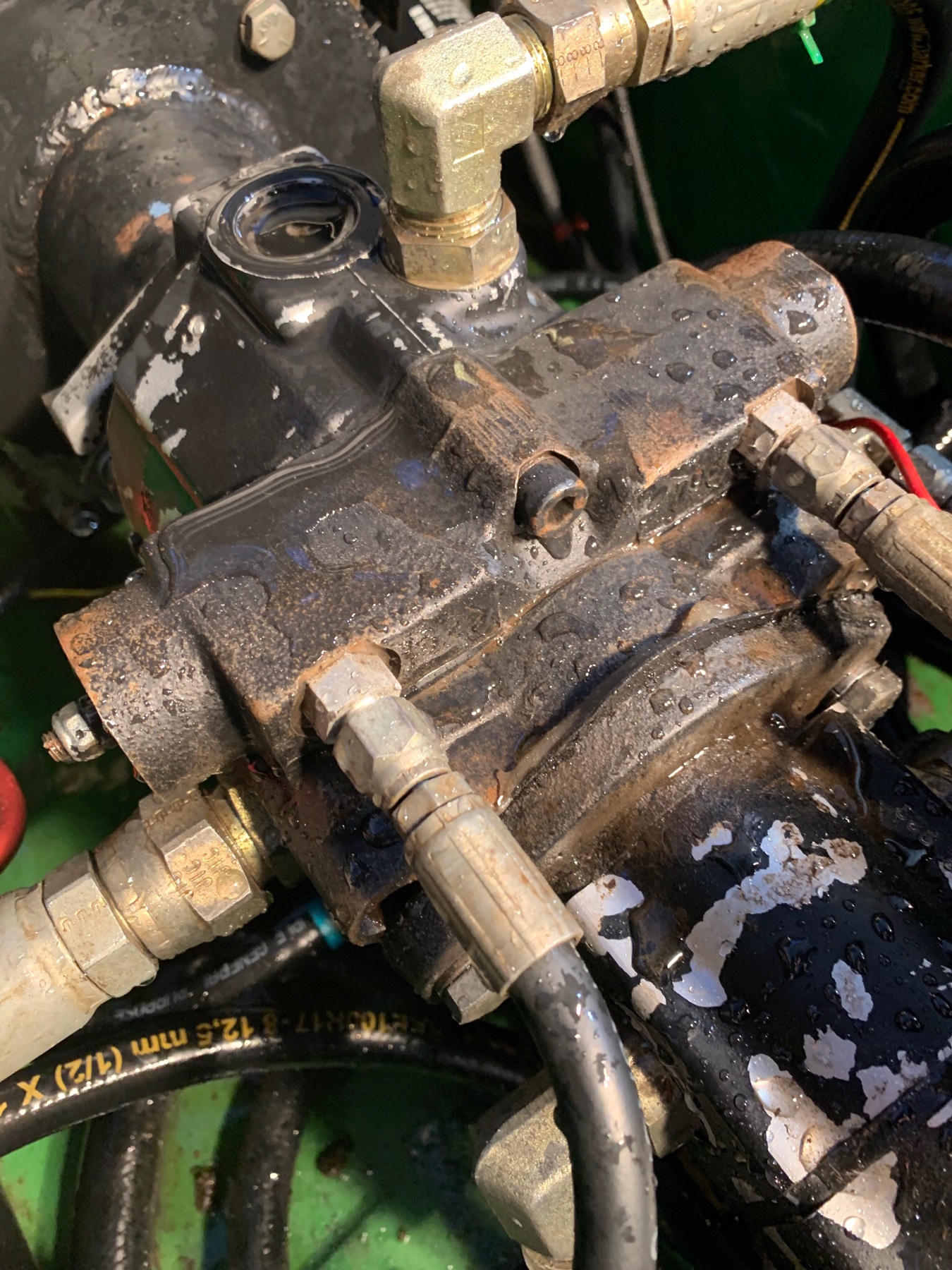

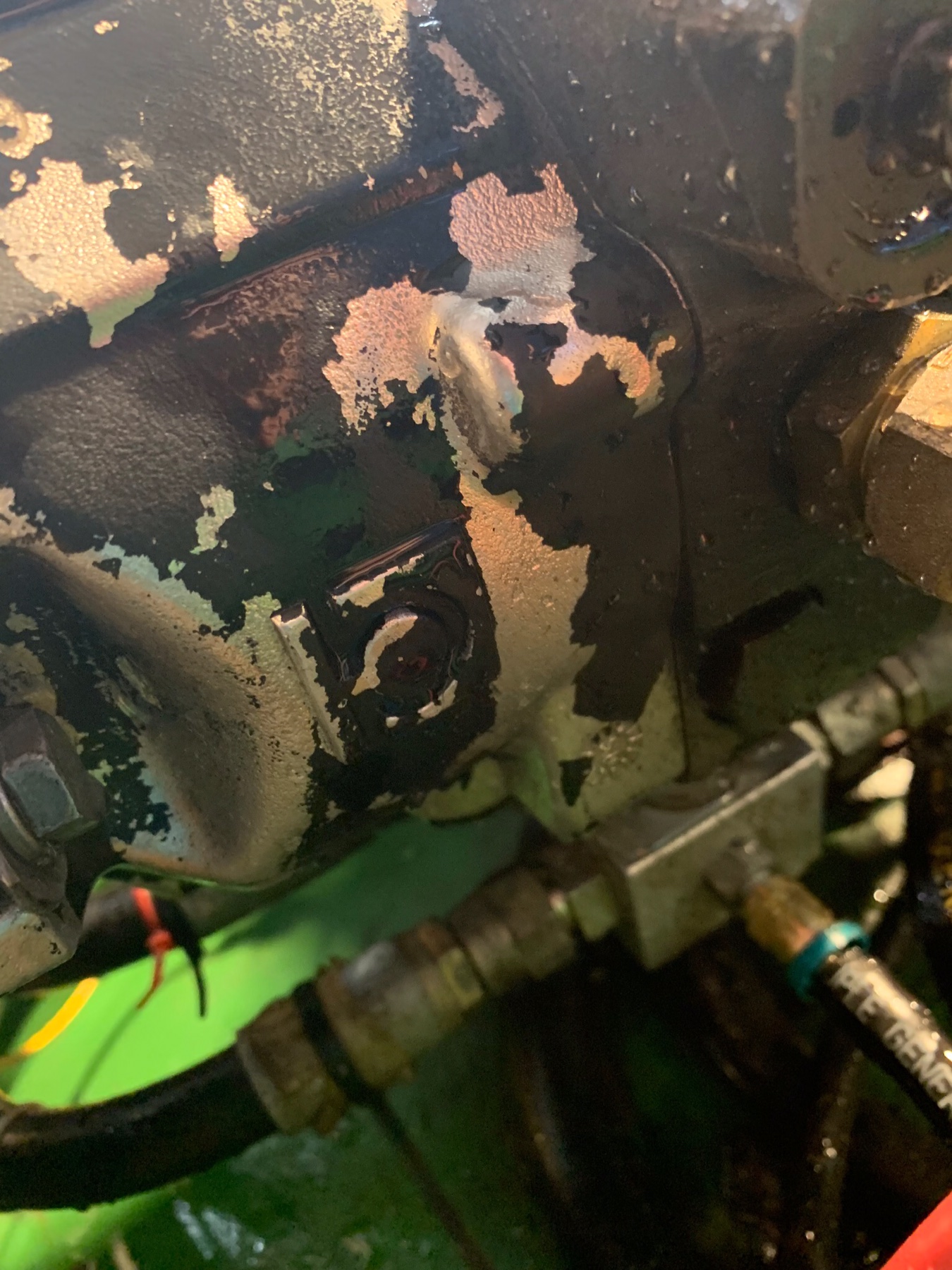

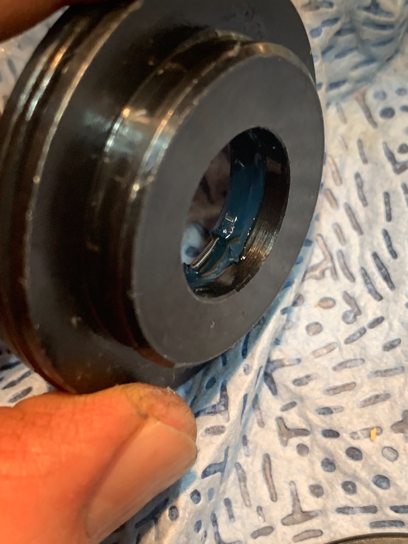

Hi guys, I got the PT towed to a place I can work on it. I disconnected the 2 bolts that mount the tram to the bell housing and supported the pumps with some straps and my engine crane. Pulled the coupler off. Not sure if it is a coupe or a lovejoy. It has two metal pieces that come together with rubber piece in between. The metal part on the pump shaft slides off easily to reveal the seal around the shaft. The couple part will not go back onto the shaft enough to hit the seal. I have included some pictures of the damaged seal. I labeled a set as inside facing and outside facing. The others should be self identified after looking at the labeled ones.

Yes, that is a catastrophic seal failure. It looks to me more like a bad seal rather than something caused by alignment, because there are chunks torn off rather than abrasion of the rubber. Is the rubber noticeably hard to the touch, i.e. overheated or “aged”. I wonder if you want to try to replace it locally to get a different manufacturer or lot of the seals.
I have only seen seals in this condition on 50+ year old equipment, and even then only a few times.

Since you show your picture that says the damage is on the outside of the seal, not the inside of the seal...
- Would that suggest the problem is not debris in the fluid?
- Would it suggest an air buildup in the pump blowing the seal out?
- Would it suggest debris on the outside gouging the seal?
I'd guess, at this point, that if the seal is blowing out, air is building up in the pump and pushing the air out the seal, blowing it out. If it was debris on the outside that was large enough to gouge out the seal, I'd think you'd see damage on the metal around the seal as well. I didn't see any scratching on those areas.
If air in the pump is the culprit, it's either not getting bled properly after the surgery, or something is introducing air into the system during operation. This is called aeration and/or cavitation.
So think back... when moving the machine, do you ever hear noise that sounds like gravel in the system. It's pretty evident to the ear. Sounds like gravel rolling around inside.
Is your hydraulic fluid foamy during operation? Open the reservoir lid while the machine is running. It should not be foamy.
You may have an air leak in a hose or fitting or at the filter.
Anyhow, lots of causes and effects on air in the system, if that is the problem at all. I'm just grasping and most obvious to me straws.

It almost looks that it's building case pressure and blowing the seal.
Does the case drain line have a free flow path to the tank? Nothing blocking?
Also, that looks like just a regular seal that seals a shaft on something that doesn't have pressure.
Pumps and motors uses a better seal with much harder rubber that can handle higher pressures.
   / The mystery of the failing tram seal #20
It would appear that the seal resides in a removable housing; pull the snapring from the pump, remove the seal and housing, remove the snapring on the back of the housing and remove the seal. From the looks, I would strongly suggest that the splines in the shaft might be nicking the seal upon installation, as it appears that the step isn't chamfered as one would expect on a shaft of this type. Without seeing the shaft sans seal, it's only a guess on my part.
If you can post any number that might be on the seal, I can look it up in my big book of seal cross reference and hopefully find a bunch of alternative numbers to look for in case PT has a bad supply.
