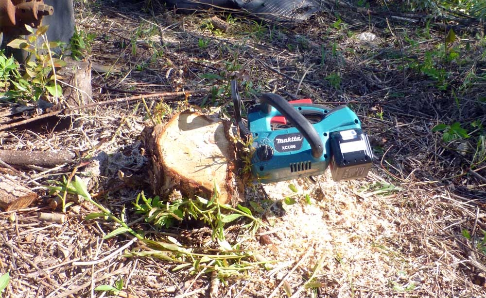

Small (12" bar) top-handled chain saw. Always seemed like too much money for a little bitty saw. Then I bought one to use when rope climbing trees and now use it all the time. Probably 90% of the wood I cut is 3" or less, brush clearing, pruning, etc., where it is perfect for the job.
Much lighter and easer to handle.

Small (12" bar) top-handled chain saw. Always seemed like too much money for a little bitty saw. Then I bought one to use when rope climbing trees and now use it all the time. Probably 90% of the wood is cut is 3" or less, brush clearing, pruning, etc., where it is perfect for the job.
Man, you got that right!
