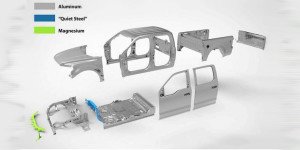

My impression is, that only the outer panels are aluminum, the inner structure, i.e. cab, bed floor, is still steel on these?
No, the inner structure is all aluminum as well, with the exception of the firewall. Supposedly, the 'quiet steel' does a better job of dampening noises than aluminum so they left it steel. There is an image showing just what is Al and what remained steel. I will try to find it...
BTW, the frame is still steel.
Here is one image. Not what I was looking for, but I will see if I can find the other one.

Okay, well that inner-structure is going to be a while different ball game.
I would be surprised if any of that stuff is glued.
Most of the time it was only me an another guy carrying them, so I sure would have rather carried my side of an aluminum pick up bed in and out of the spray booth, instead of a steel one.

I'm not sure on how much of that is glued and riveted, but I do know there is extensive use of glue and rivets throughout the truck. I couldn't find the other image and can't remember where I saw it, but this gives you the basic idea.

We were never allowed to use glue on structural parts, in the past.
