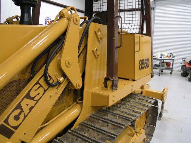

I worked in my father's shop starting when I was 10, we did both body and mechanical. I have painted about 30 cars. I have one to post that was painted entirely by my wife with a brush here in my home shop. (Tractor that is) Check out Garage Journal with my same user name, they have a place for albums. You can veiw the home shop and boat project. You are right about the prep work, I get carried away, while people are saying it's just a tractor I'm still sanding.

Here is just one picture of her brush paint job. I posted the rest under Case/IH

   / The restoration of a Ford 445A w/ Gannon Scraper box #16
"while people are saying it's just a tractor I'm still sanding. "
That's a good like right there.
Sure can not tell it was brush painted from the picture. The paint must have been mixed hot. I'd keep her around.
