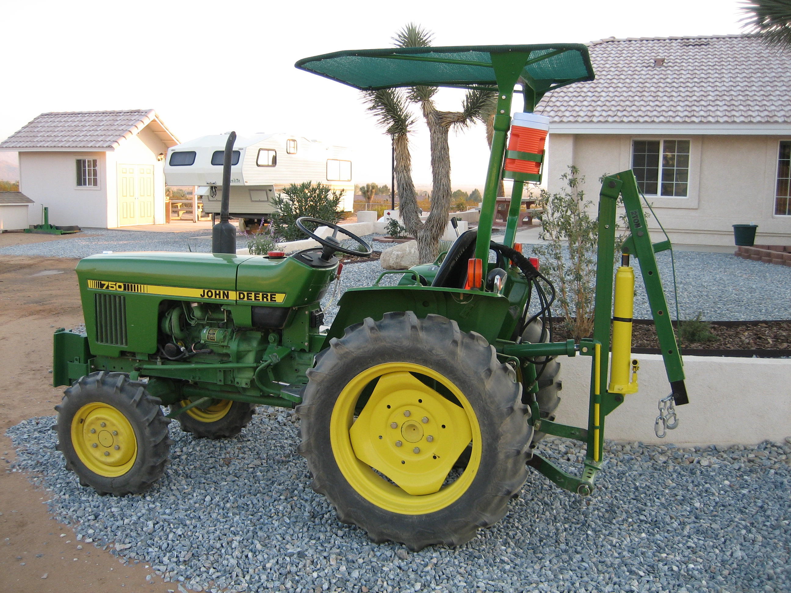

no just convert that cylinder on the shop crane to hydrolics to run off your side link control and there no annoying pumping that has to be done!

This is the hydraulic boom lift I made for my powertrac 180. It works great, but my lift arms are only rated at 600 Lbs, and the 2" bore x 14" stroke boom cyl will lift a lot more than that.
Now that's what I would call a real cherry picker. Nice job!
Had thought about that. It would make it alot more versital. I knew I should have bought a 3 spool valve. :( The side link control works great in moving your load sideways about a foot each way.

Here is a picture of the crane put to bed.

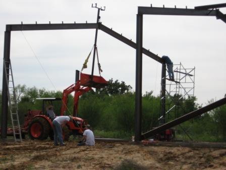

Again, thats a great looking place. I really like the three point boom idea and I almost made one of those and then decided to go with a little more height instead of lifting capacity. Here is a picture of the boom I made for my FEL. The boom is 14 feet tall so I can get about 24 feet of vertical reach. I used this boom for putting up the columns, trusses, and purlins on my shop. The boom is pinned in the bucket and then I put ratchet straps just to stabalize the boom.
