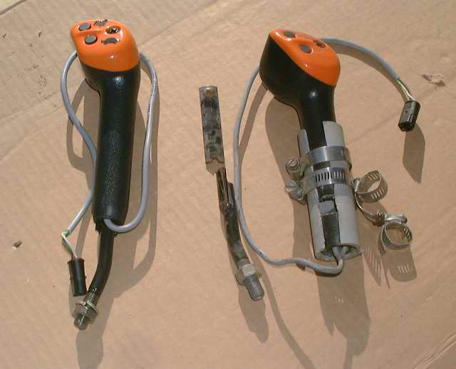

So what do you do when your loader joystick breaks off on the job? Improvise of course! :D

hey.. a splint with a hose clamp has fixed many a thing. good job!
   / The show must go on! #4
RD, you can read my full (and very long) thread about the No Joy Joystick that started in March of 2001. I finally replaced the joystick with a new one that has a much improved design and have had no failures since. I've attached a photo below that shows we are "brothers" in southern engineering.:laughing:

I followed your link Jim. Seems that New Holland learned nothing between 2001 and 2006, which is the year of my TC35D. I tightened and replaced screws forever, finally was only able to use one screw, then none. The shaft came loose a couple of years ago at the bottom. I "gently" wacked the snot out of it downward where it stuck like glue. I used a one-hose-clamp splint for the last few months after I saw a crack developing where it broke yesterday.
Fart - You'll be happy to know that duct tape is indeed in play (for the time being.) Three metal brick-tie splints, two hose clamps, a strip of rubber insulation and black duct tape to cover it up will have to do for now. I had a job today and I'm booked next week. Can't let the customers see my "Southern engineering"! ;)

RD, the "damage" is not too bad on a whole new joystick assy including the shaft, plastic handle, and rabbit/turtle switch. Messicks.com shows it to be part number 86400438 @ $136.90.

Shoot...I have half that in "rigging" on it now! McMasters quoted me $148 and change this morning, so I have one coming in on Wednesday. It's supposed to be raining, so maybe I can get it replaced. I've been busy and repairs are stacking up! I haven't yet tackled the leaking fuel pump deal. That one has me a bit nervous!
