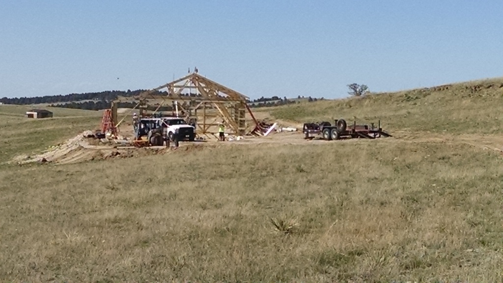

one of the things i've been eagerly awaiting is the construction of my barn. this is very likely the only barn i will ever have built, and i really wanted to watch its construction. so naturally, when barn construction started, i was on vacation. i'm back now, and i'll go out tomorrow and see what's up. my wife took this picture
and now you know as much as i do.

   / The Slow Motion Retirement Plan #179
Looks like they know what they are doing.

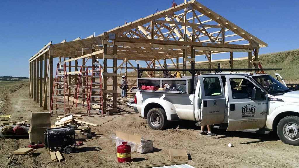

hmm, that's irritating. i saw the double post, deleted the second one, and now the deleted 2nd post has returned. how rude.

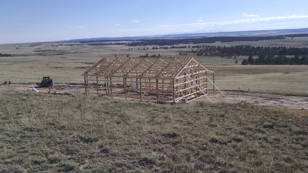

i went out to the property today and spent an hour looking around. things are progressing nicely; yesterday they started with some of the poles loose in the holes (see the picture above) and after two good days of work they are almost done with the basic framing.
they do indeed.

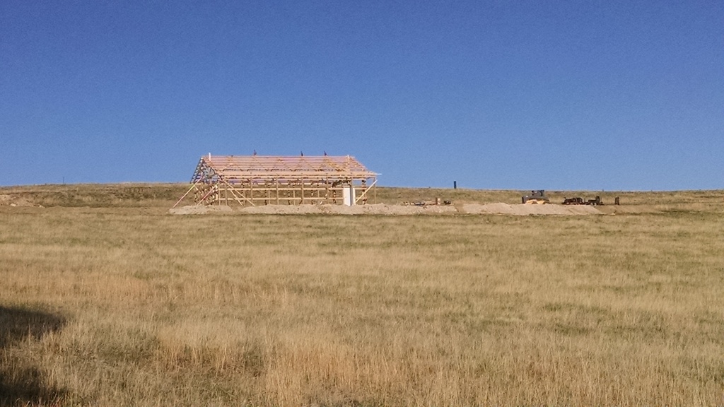

this is the view from just below our gate. it's kind of interesting how little of the barn can be seen from the road. i wasn't sure they had been working on the barn until i was right up on our gate.

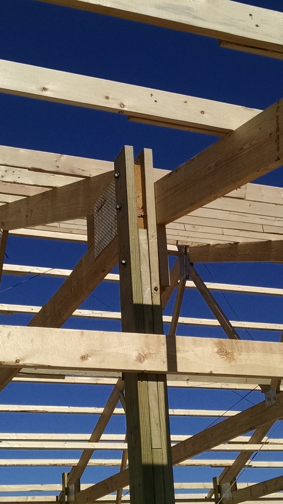

this shows one of the 'posts' cleary uses. these are 3 2' by 6' sticks of pressure treated lumber that are nailed together to create the post. the center stick of the posts are cut short and non-pressure treated lumber is used something like 7' out of the ground. the center section is then custom cut to make sure that the roof trusses meet the posts at the proper height. this also allows the truss to: 1) sit on wood running down to the cement footing 4' in the ground and 2) be supported on both sides by the other sections of the nailed together post.
here is some of the detail of how the roof truss sits down in the center of the nailed together post. i like this detail; this is what tipped the balance in my selecting cleary.

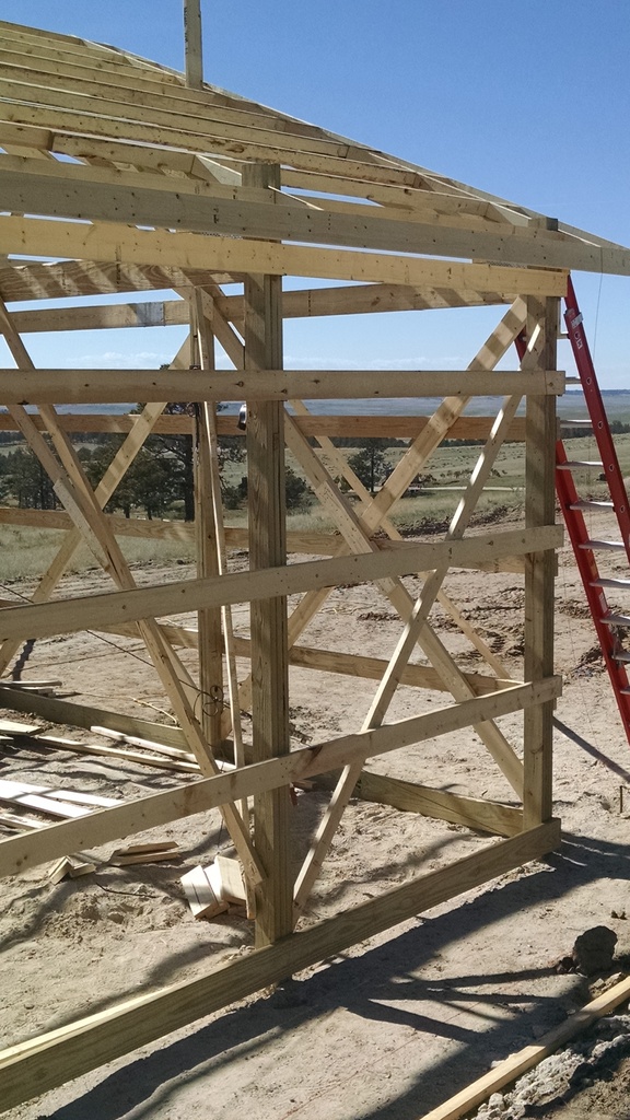

the x-framing in the end wall assists in keeping the building square during wind loading and the like. the other end wall is mostly two garage doors.
