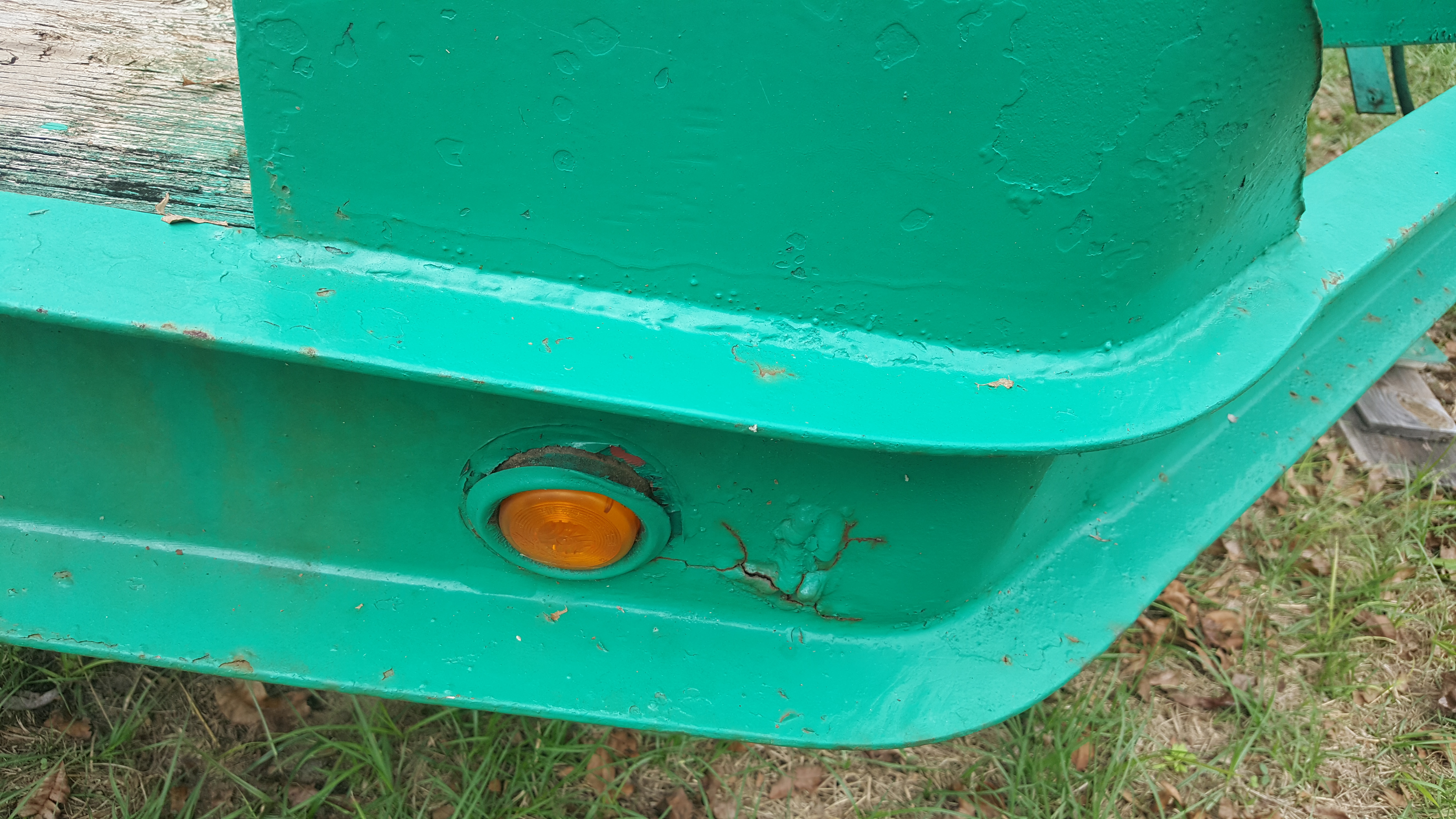

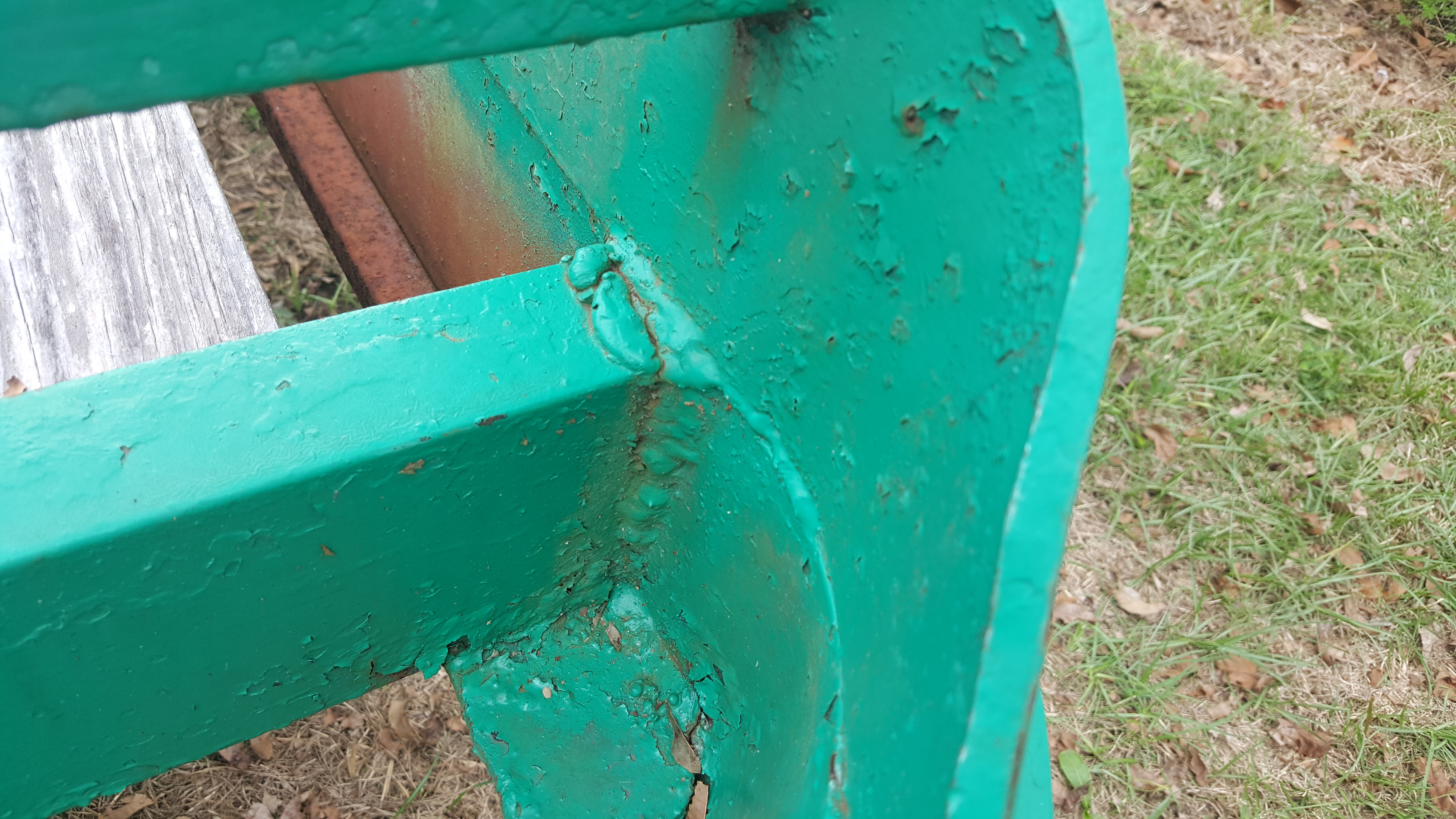

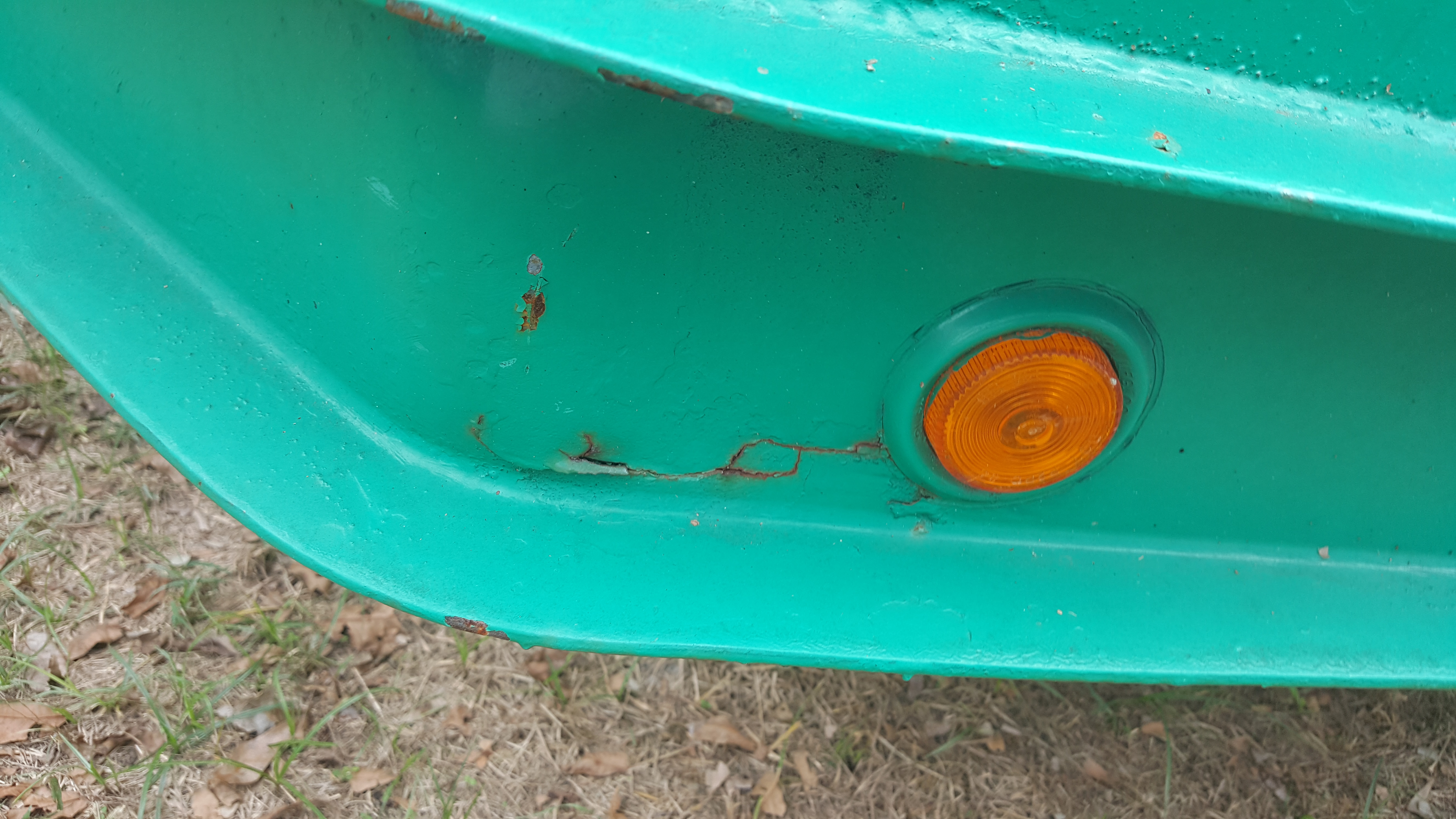

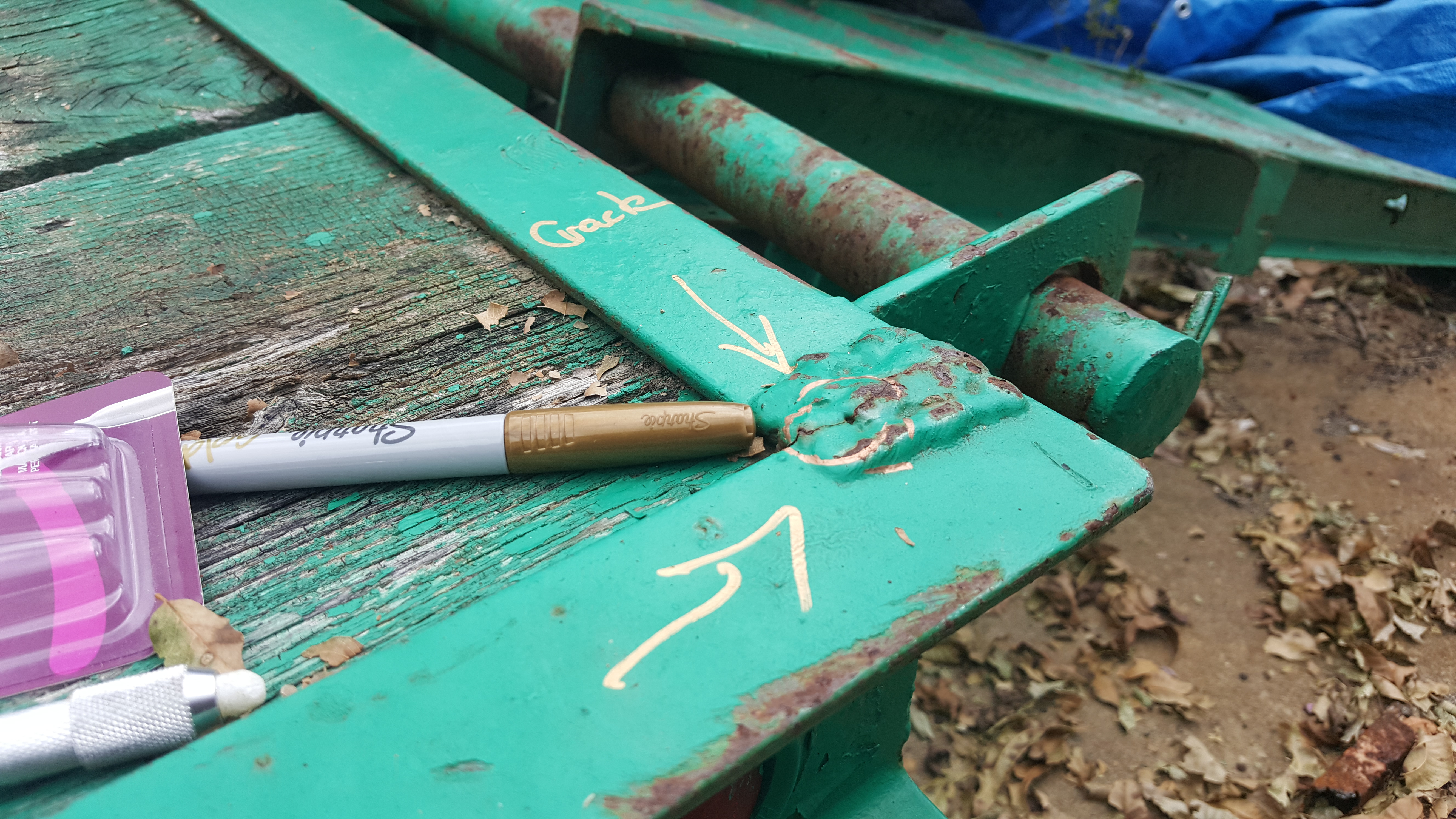

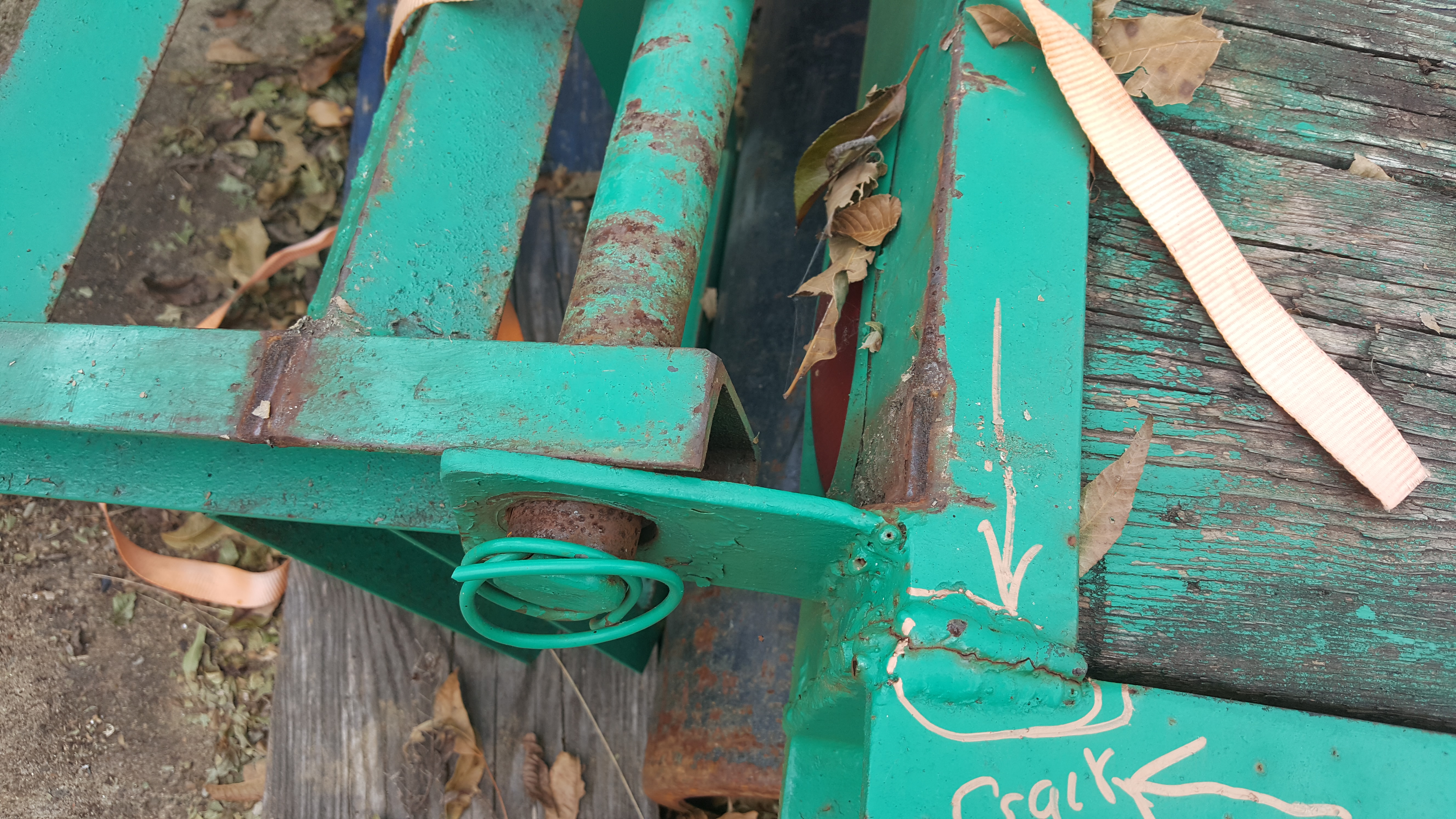

Getting back to the information promised. Having excessive hot weather and a hurricane and work related projects interrupt me, I am now back on the case.
Upon inspection, I found many cracks all around as well. Case of poor welding. And a prime case for those naysayers about the importance of proper welding techniques and welding rod handling to take note of.

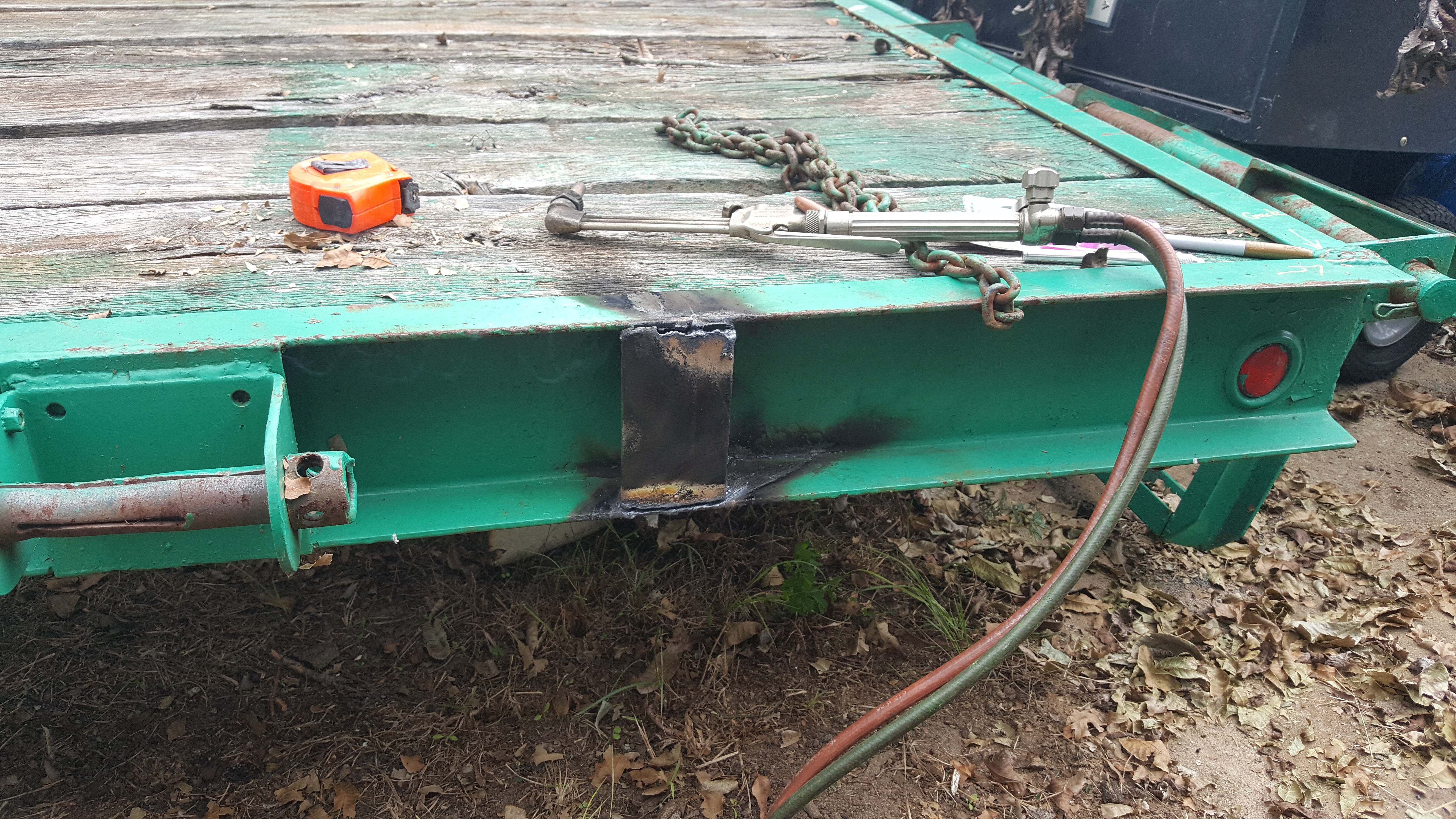

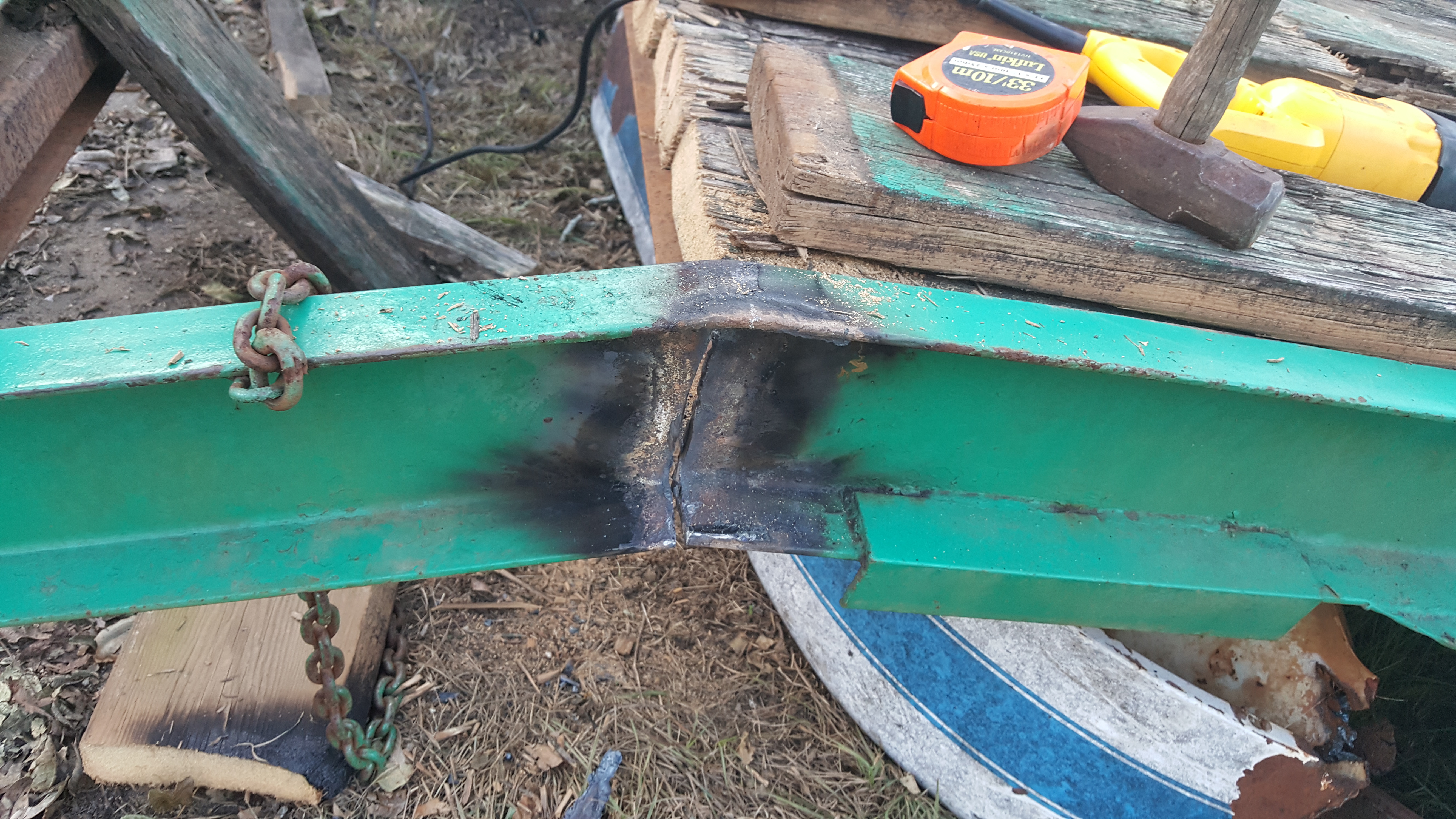

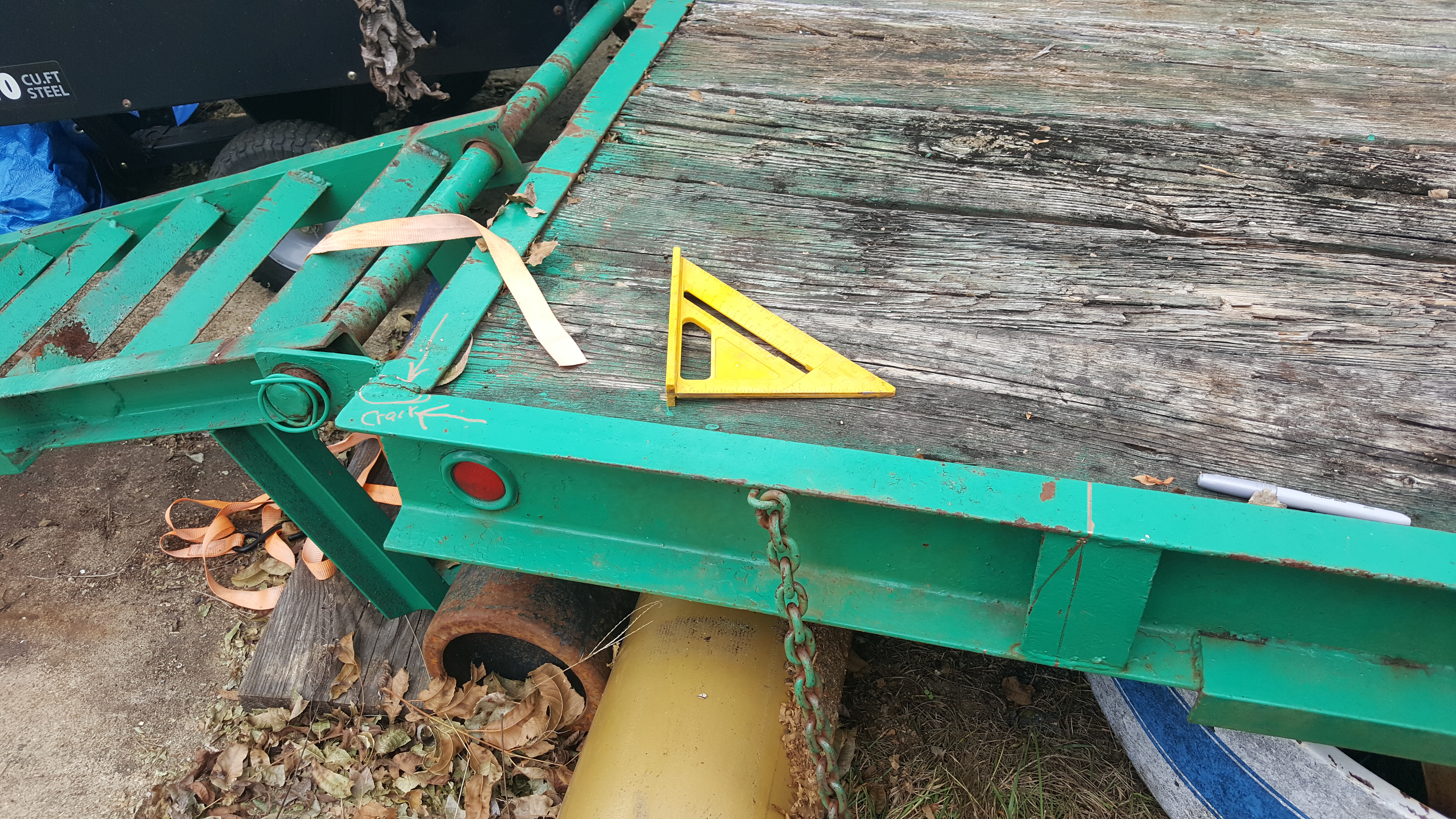

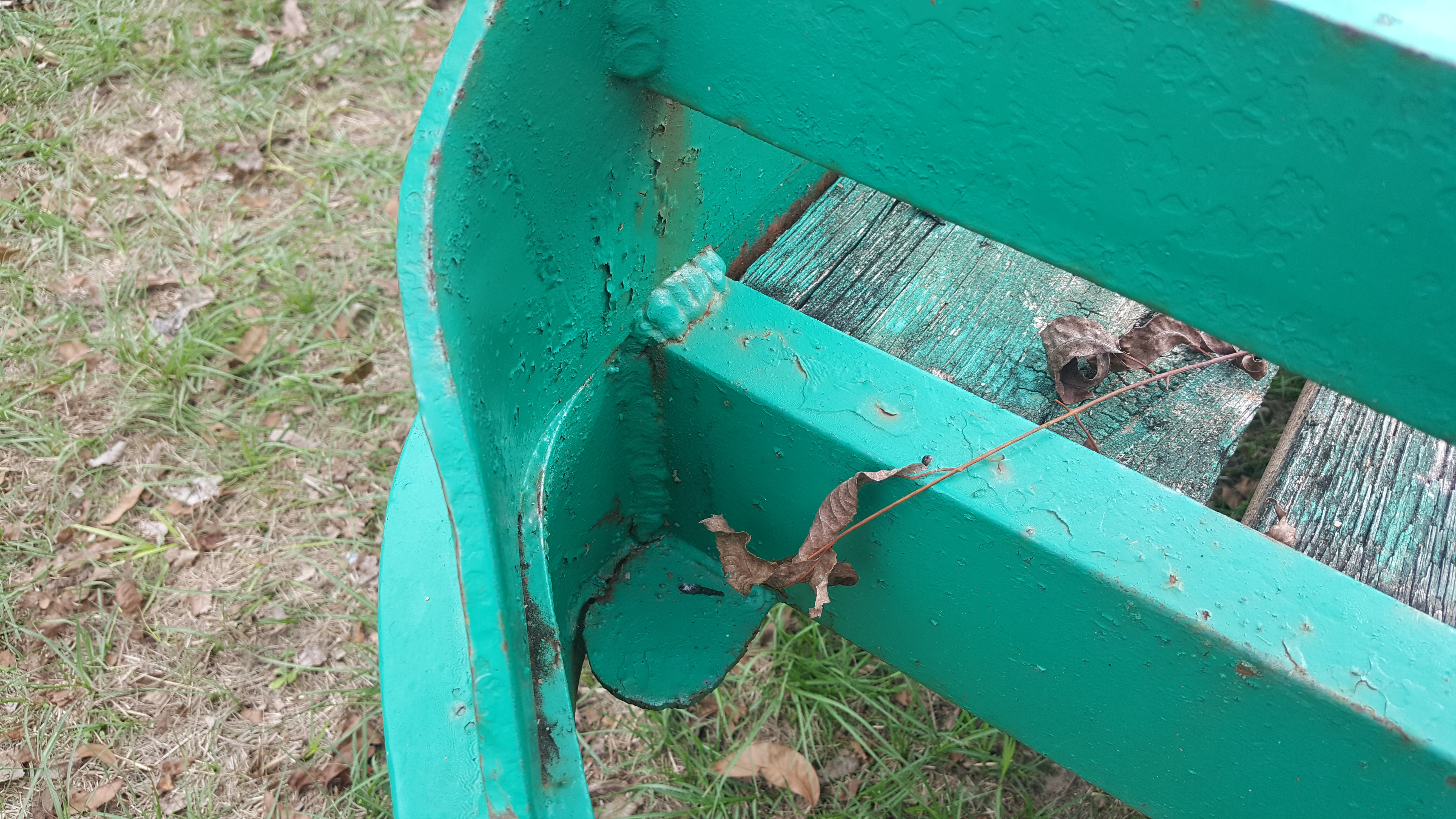

This is the beginning of the repairs
   / The Summer of the Trailer Repair #30
Hope you have a Needle Scraper?
I have had a couple of the HF smaller ones and they are perfect for those repairs.
I hate bird poo welds, especially on commercially sold equipment.
