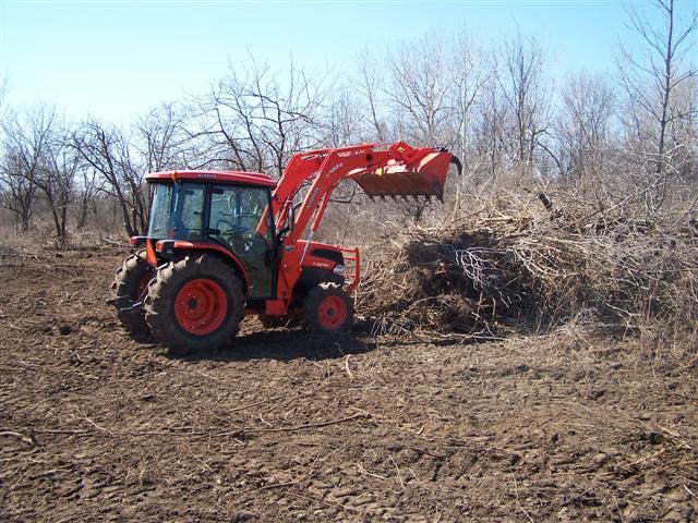

I considered a "thumb" for my bucket but decided to go whole hog. I'm glad I did. I can't imagine anything a thumb can do that my grapple cannot but my grapple can do much more than a thumb. I cleared groves of saplings from overgrown property and clean up after the '09 ice storm was a breeze.
What brand & model grapple is that?
I've been looking at the Construction Attachments "root grapple" that prices out around $2000 for the 60". Always interested in checking out alternatives...

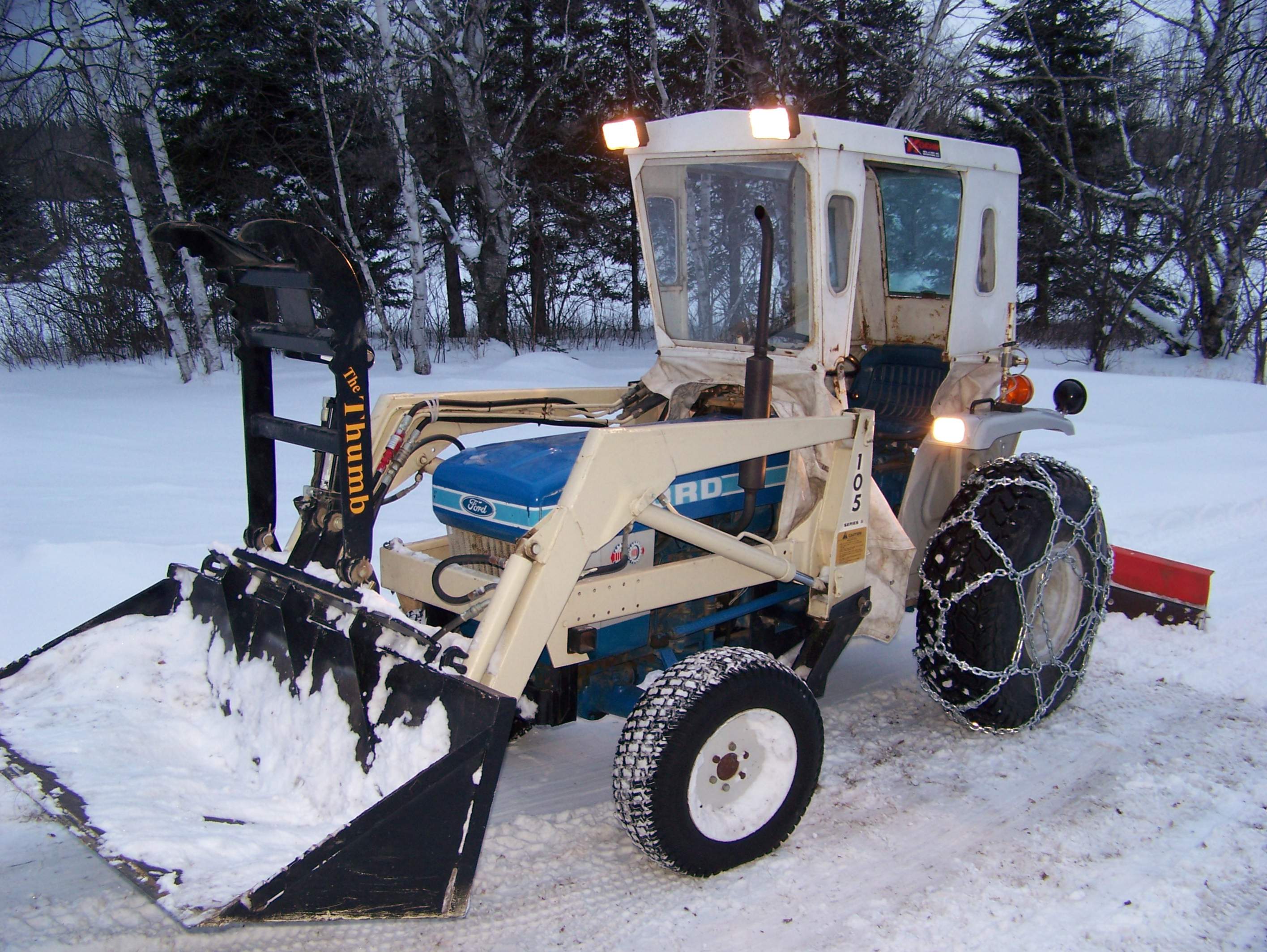

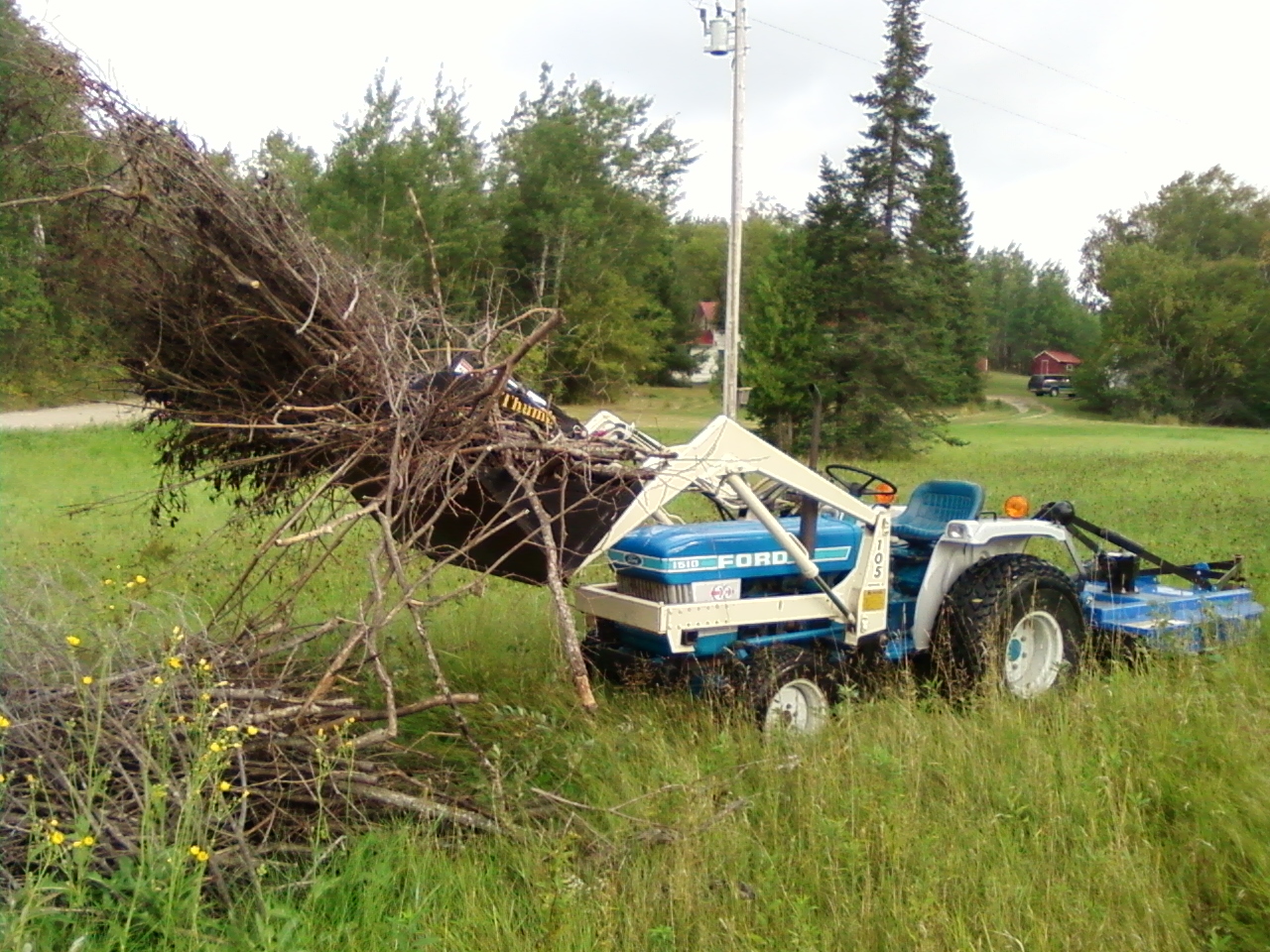

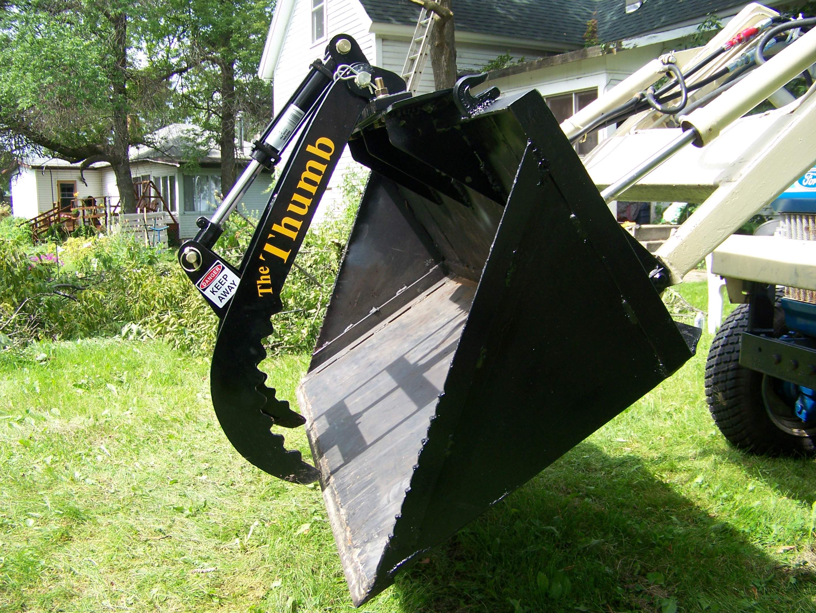

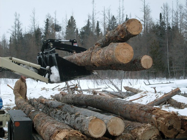

I have "The Thumb" on my loader and love it. It's built very well and should withstand just about any abuse you can dish out on it. They make it in several sizes, so it should fit pretty much any bucket out there. My over-sized bucket was home made so it has a huge capacity, as you can see in the pictures. (32" I think.) I am, unfortunately, unable to help you in that department. Hopefully there are others with similar rigs to yours who can pipe in with some measurements.

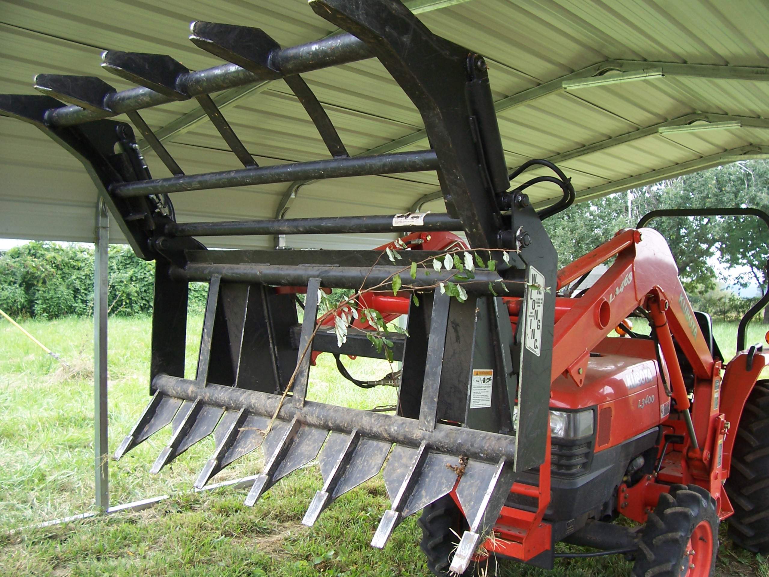

Thanks, but I was asking about the grapple shown by Milton Burro.
The Grapple says WR Long on the side. I've heard good things about WR Long.
