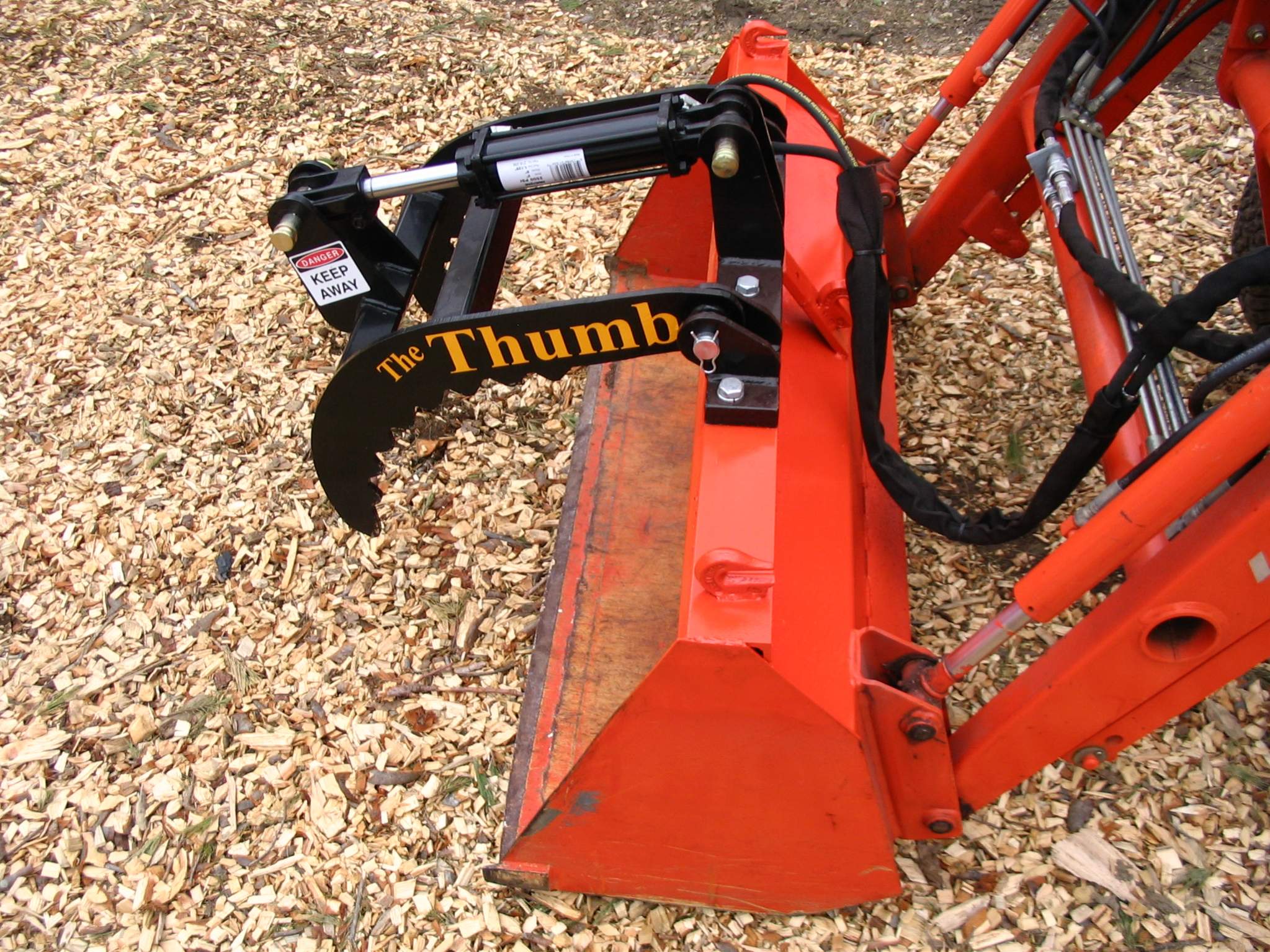

Love my "Thumb" :thumbsup:
solid, inexpensive, does a great job for logs, firewood, mulch, brush. No need for a full width grapple for what I do...

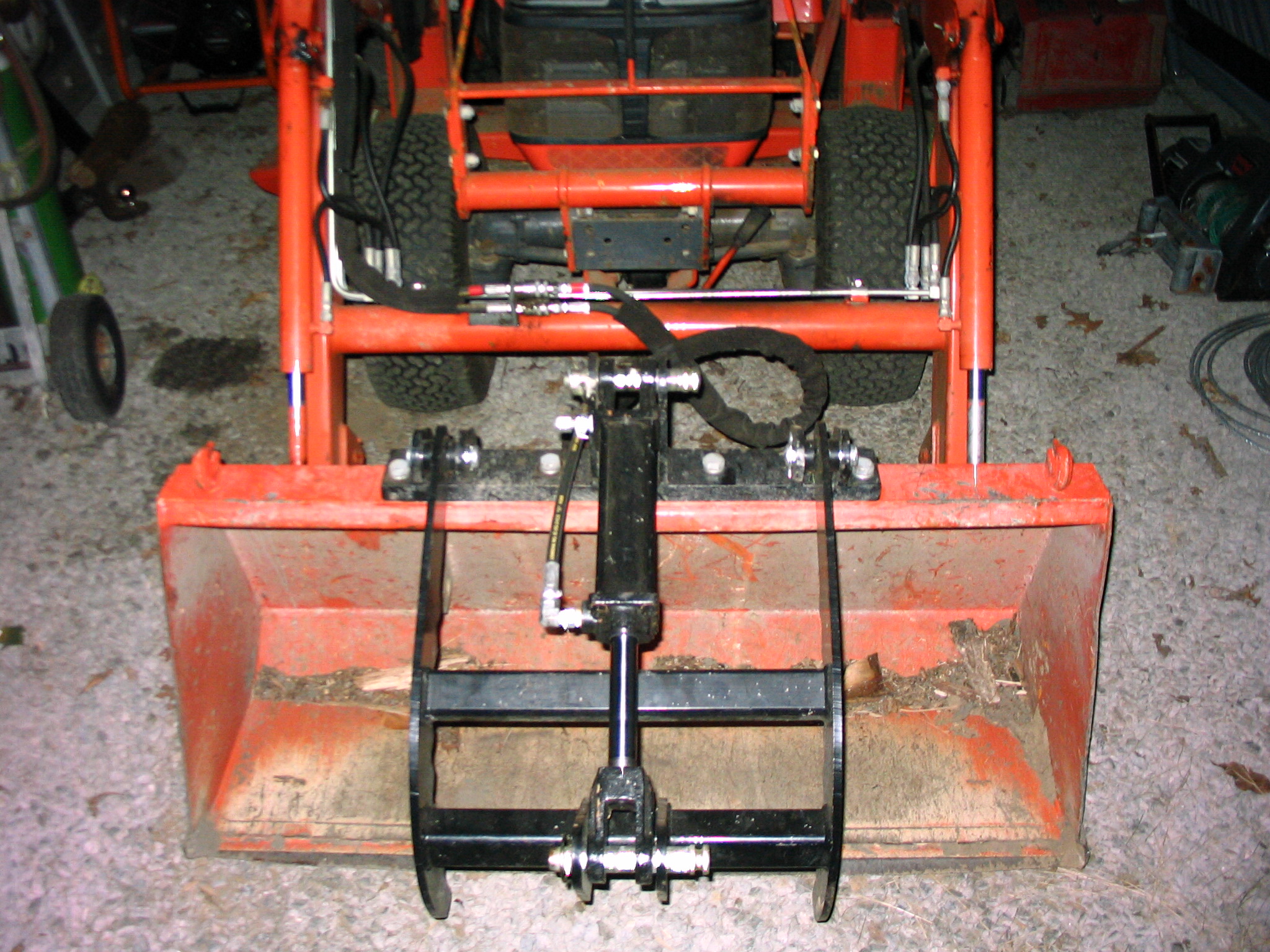

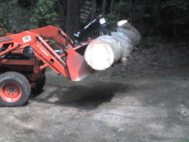

I have seen someone mount 2 "thumbs" side by side...

With the Thumb, the top of your bucket will need to be reinforced... can you weld? Mine is WR Long that bolts to the side of the bucket... but it costs more. I got mine used for $350 (which is about the price of the Thumb)
The Thumb - Shop Online
