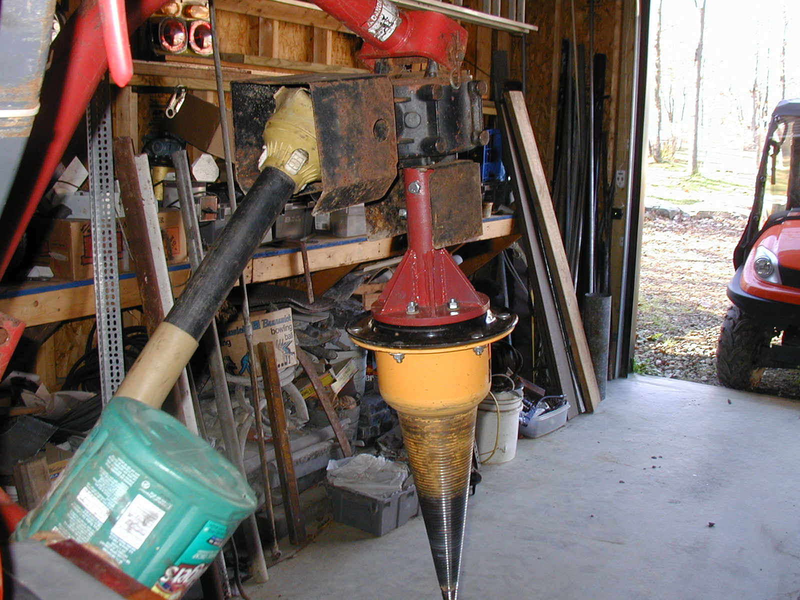

I welded a piece of rebar with a cork handle on my auger so I can place it right where I want right from the tractor seat. I do it solo and wouldnt really want anyone around while I am doing it at least the splitting part.

Reading through past posts on TractorByNet it seems the two most dangerous attachments are the post hole digger and the stickler screw type log splitter.
Since I own both I decided to combine them.
Works great.

Also have the handle for the post hole digger and I plan to attach it.
Latest pic.

this is a great idea. I need both a phd and a log splitter...this would solve both needs. If I could find a used phd locally for a good price I'd be set...time to start looking!
