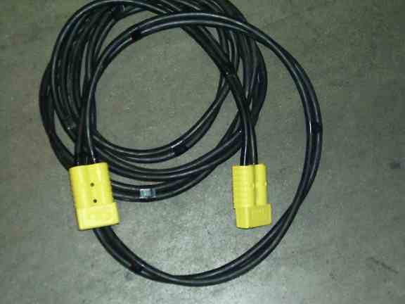

We have 7 vehicles at work...two airport tugs, two forklifts, two skid-steers, and a Cushman utility truck...and, thanks to Murphy's law, the batteries always seem to die at the worst time. We have some 2/0 welding cable salvaged from an old project, so I decided to add a power connector to all of the vehicles, and have some B.F. jumper cables to go between them. I ordered battery connectors from Mcmaster-Carr:
McMaster-Carr
and made some jumper cables.

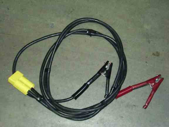

I also made a set of "adapters" that will clamp onto the baterry of a "non-compatible" vehicle.

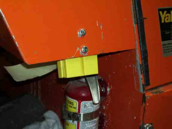

Here is a picture of the connector on one of our airport tugs...I tucked it up out of the way, sorta under the "dashboard."

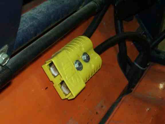

And here is the connector on one of the forklifts...hidden behind the seat.
