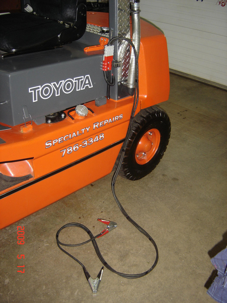

I did the same thing this spring when I finished restoring my old forklift. Good system and works well.

If you want those neat red or gray battery connectors, go to a forklift shop. They sell them by the hundreds. They are known as Andersen SB connectors. The model is the amperage rating. You want the 350's. The 175's are too small. They also come in blue, yellow, green, and maybe a couple other colors. The colors are not supposed to interchange. They are made different colors so that different machines in the same building can have different voltages without getting batteries, chargers, and machines mixed up. The different colors have absolutely nothing to do with the quality. They have everything to do with keeping different voltage machines from getting hooked to each other. Traditionally, in the forklift industry, 350 reds are 24v, gray 36 volt, blue 48 volt. This is just the way I usually see it done, it's not any kind of regulation. Usually a 72v machine is two 36v batteries in series.
