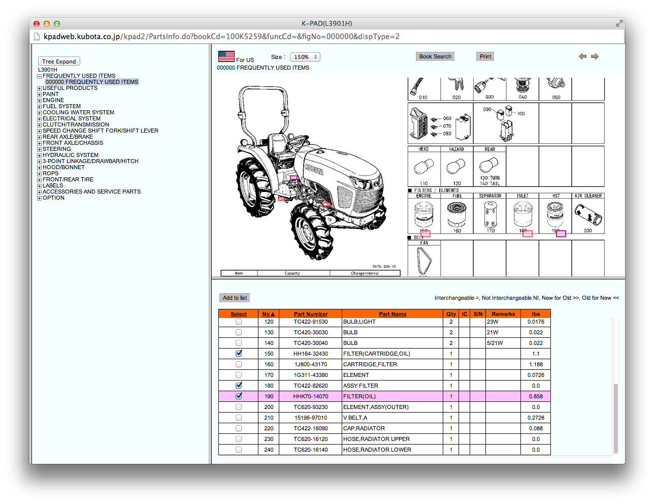

Here's the info:
http://kpadweb.kubota.co.jp/kpad2/PartsInfo.do?bookCd=100K5259&funcCd=&figNo=000000&dispType=2
Filters:
HH164-32430
HHK70-14070
TC422-82620
