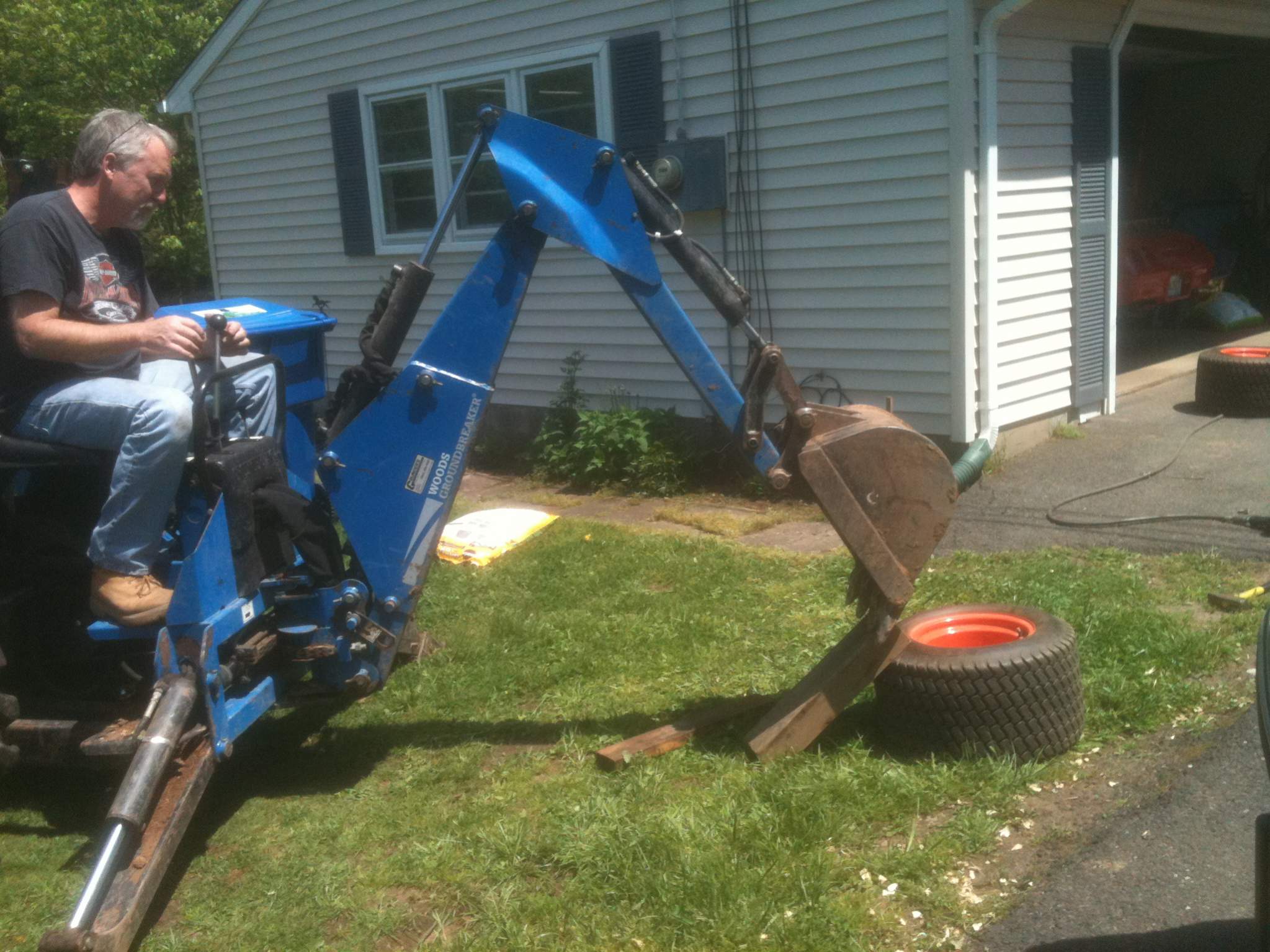

Recently I had to replace the valve stems on the BX1500 because they were cracked and dry rotted. Using the backhoe and a block of wood was the only way we could get tire beads broken, I'm sure there are other creative ways to do this.

I had some 8" tires on my golf cart I changed a few weeks ago and used the pallet forks on my tractor to stab them to break the beads. I have also flattened the tires and run them flat till the beads popped, but these were all tires that I were not to be reused.

Dad and I used to break the bead on tires (haywagons, baler, rake, truck, etc) with the hydraulic drawbar on the back of his Farmall 200. The fast hitch generates plenty of downforce- just place the tire to be "unmounted" flat on the ground centered under the drawbar. Place a block of wood (~12" 2x4) with 2 square ends at the edge of the rim and up against the underside of the drawbar. Slowly lower the drawbar and the sidewall will be pushed away from the bead! Be careful not to use too long a block of wood or keep pushing after the bead is broken as you will raise the rear of the tractor off the ground with the hydraulic!
