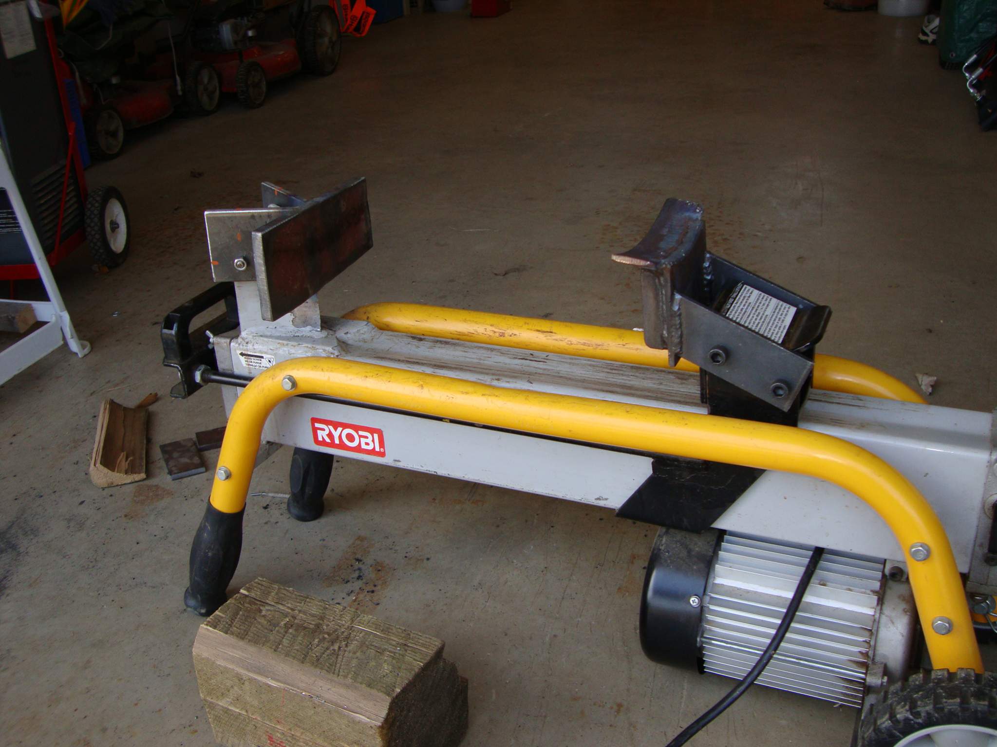

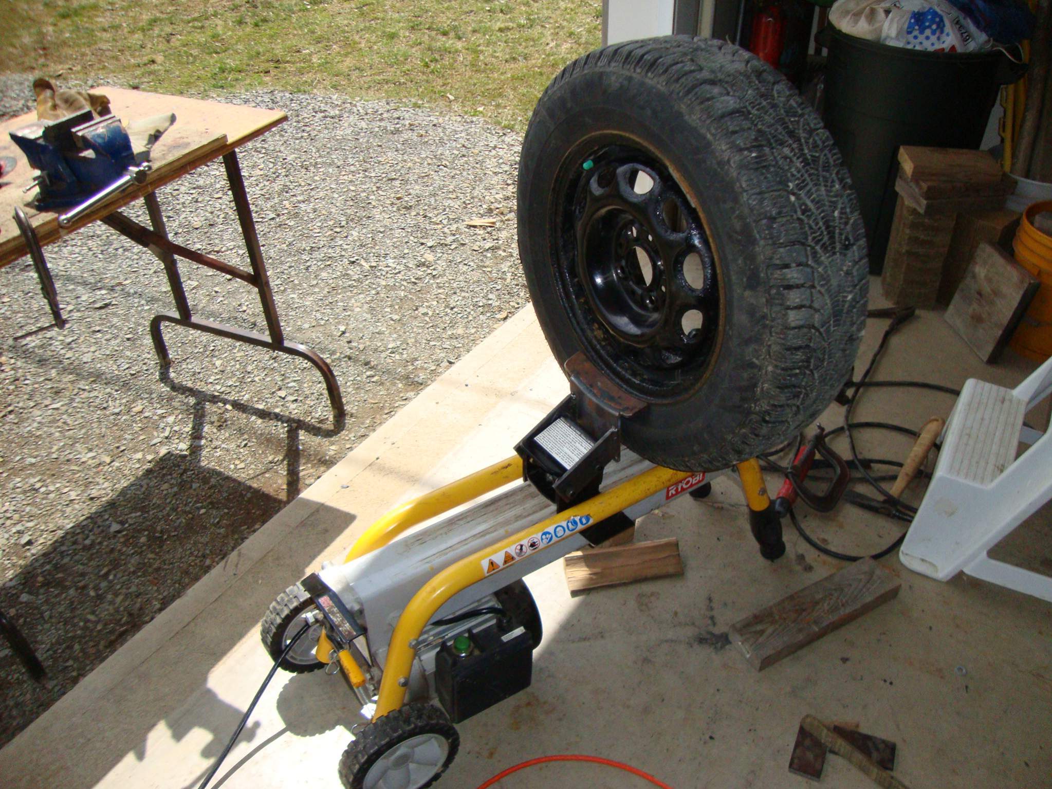

I use an attachment I built for my woodsplitter. Works like a charm.
