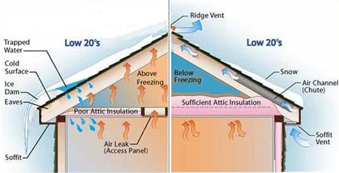

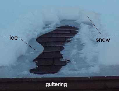

Those with snow remaining on the roof probably have a type of ice dam, very little is known about, and water is entering the walls of the structure. In this case on my house, the complete roof had a layer of water under an eighth inch layer of ice topped by a foot of snow. The water at the walls had head pressure ( about 6' ) from the building line to the ridge. As soon as the ice was broken from the eave to the building line in a 2inch wide area, the head pressure was relieved and water ceased dripping from the windows.
More insulation may lower your heating bill but it doesn't prevent ice dams and water entering the walls. But it will change when it occurs as the outdoor ambient temperature changes.

ice dams are usually associated with poor ventilation, vapour barrier and lack of insulation.
   / There's snow on the roof, who care's #13
What happens when air above 32°F enters the vent system and supposedly travels the under side of the sheathing to the ridge vent while that insulating snow is on top? There are many people that don't understand the last sentence I wrote.
If it's just ambient air circulating the roof will be the same temperature.
   / There's snow on the roof, who care's #19

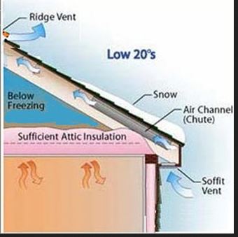

If the house is insulated properly...Nothing. The roof should be a cold roof in your example. Conditioned space should always be surrounded by insulation. If conditioned air is being allowed to come into contact with a roof, ice dams occur.
There is a science to insulating a house. Its amazing how many suppose it contractors have no idea on how to properly insulate a house.
   / There's snow on the roof, who care's #20
With living area heat loss, bath vent ducts through the roof, sewer pipe venting that's above freezing, dryer venting duct in the attic, outdoor air above 32F entering the soffit and directed along the sheathing, keeping the attic below freezing is a lot of wishful thinking.
I'll be providing an escape route for the liquid hidden under the snow and ice and everyone else can do whatever they deem necessary to keep water and potential mold out of their walls.
