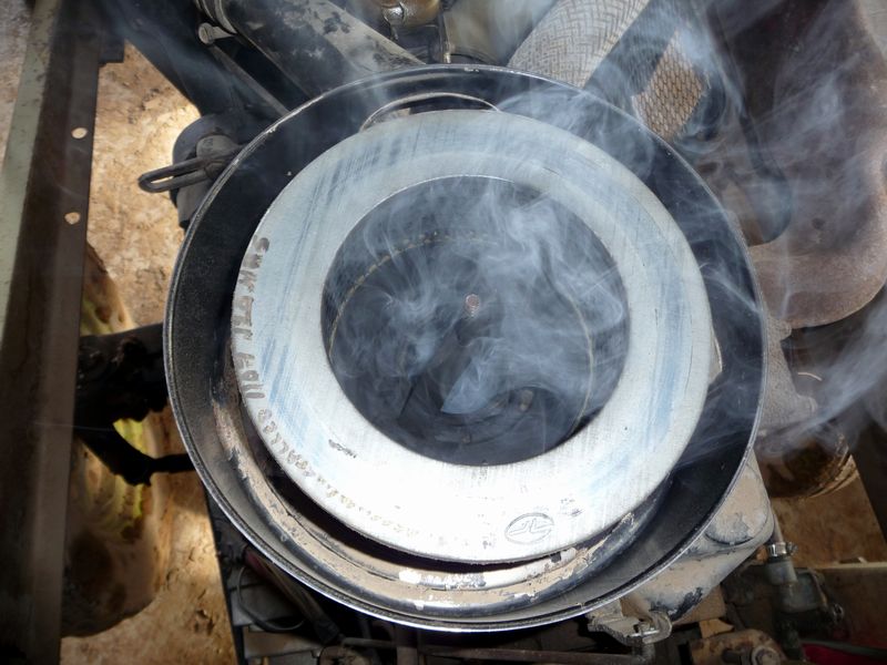

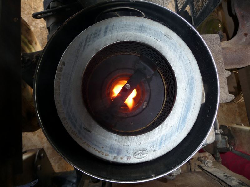

By popular demand, (Well I think it is interesting :D ) I just took these photos.
Incidentally this was with the key in 'Start' position but with the clutch safety switch preventing cranking. I was testing to see if TS operates in Start position as well as when the key is cranked left.
Vapor seen before flame starts, and for a moment after letting go the key.
After holding the key in TS position for a few seconds the TS element, similar to a car's cigarette lighter, starts to glow. Then diesel vapor fills the intake. At about 10-12 seconds the vapor ignites.
The initial flame was higher, up to the top of the air filter. I kept the camera away until I let go of the key and the flame dropped down to this level.

And that is why the Perkins A/AD3.152 is LEGENDARY for it's cold starting ability - the Thermostart!!
