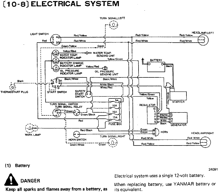

Tim had to go look. The GRN. wire that is connected should go to your ignition switch A with a jumperwire to the same terminal from B if you turn the key backwards or Left your Water Temp and ALT. light should come on. you are giving the TS. power. You also did me a favor Thanks. After seeing your picks all I need is the Res. and the hose and wire it back up for mine to work. I have never needed it so haven't had to hook it up. Here is the Wire diagram posted earlier.
Carey
