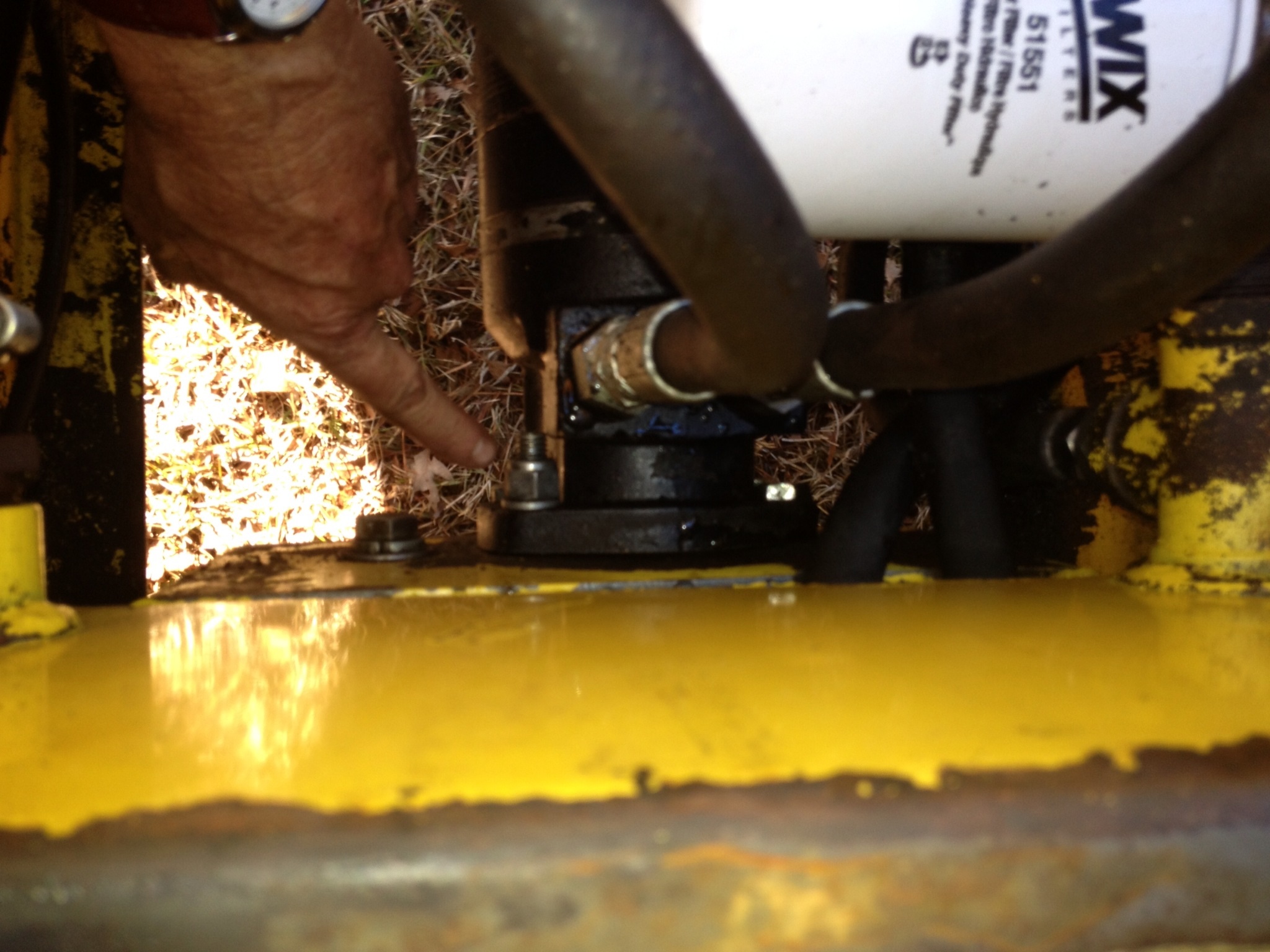

With the deck cover off today, I noticed the bolts on my hydraulic rear motor was loose and it was moving every time I went forward or back. Make sure these bolts are tight. I suspect this is something you should check several times a year. image.jpg

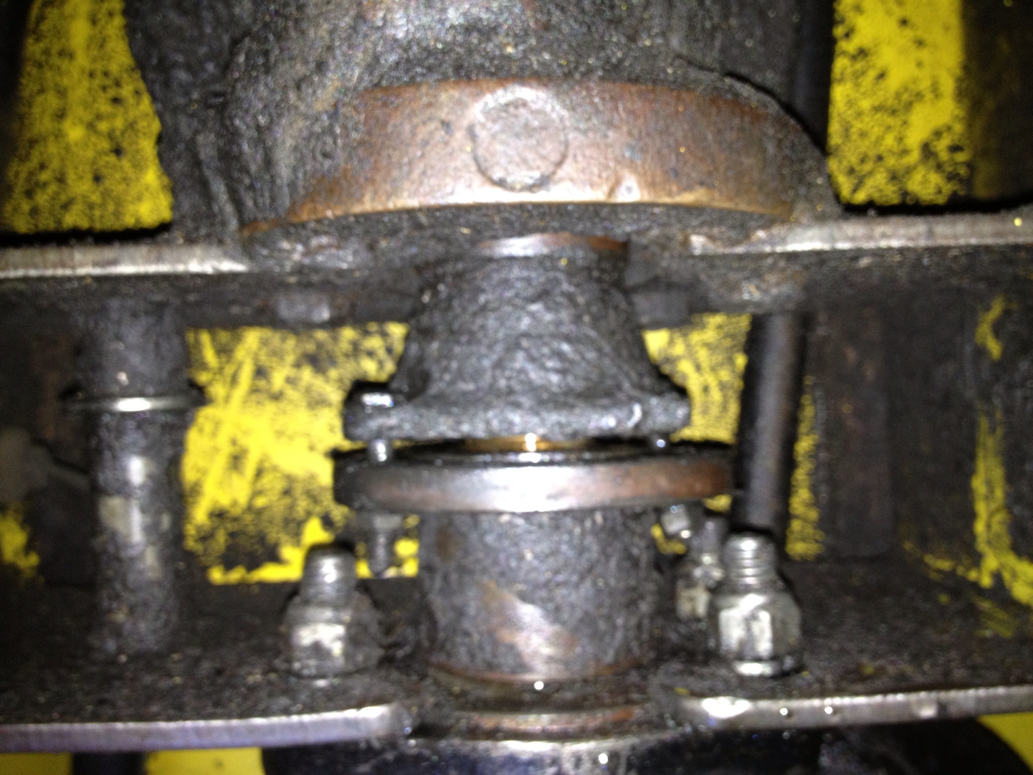

Also check the companion flange ( where the hydraulic motor attaches to the rear transmission)- make sure the bolts are tight and the ears are not broken. This is another item you need to periodically check to make sure these bolts are tight. image.jpg the cost of the companion flange and slinger parts will be around $205 to $250 dollars.

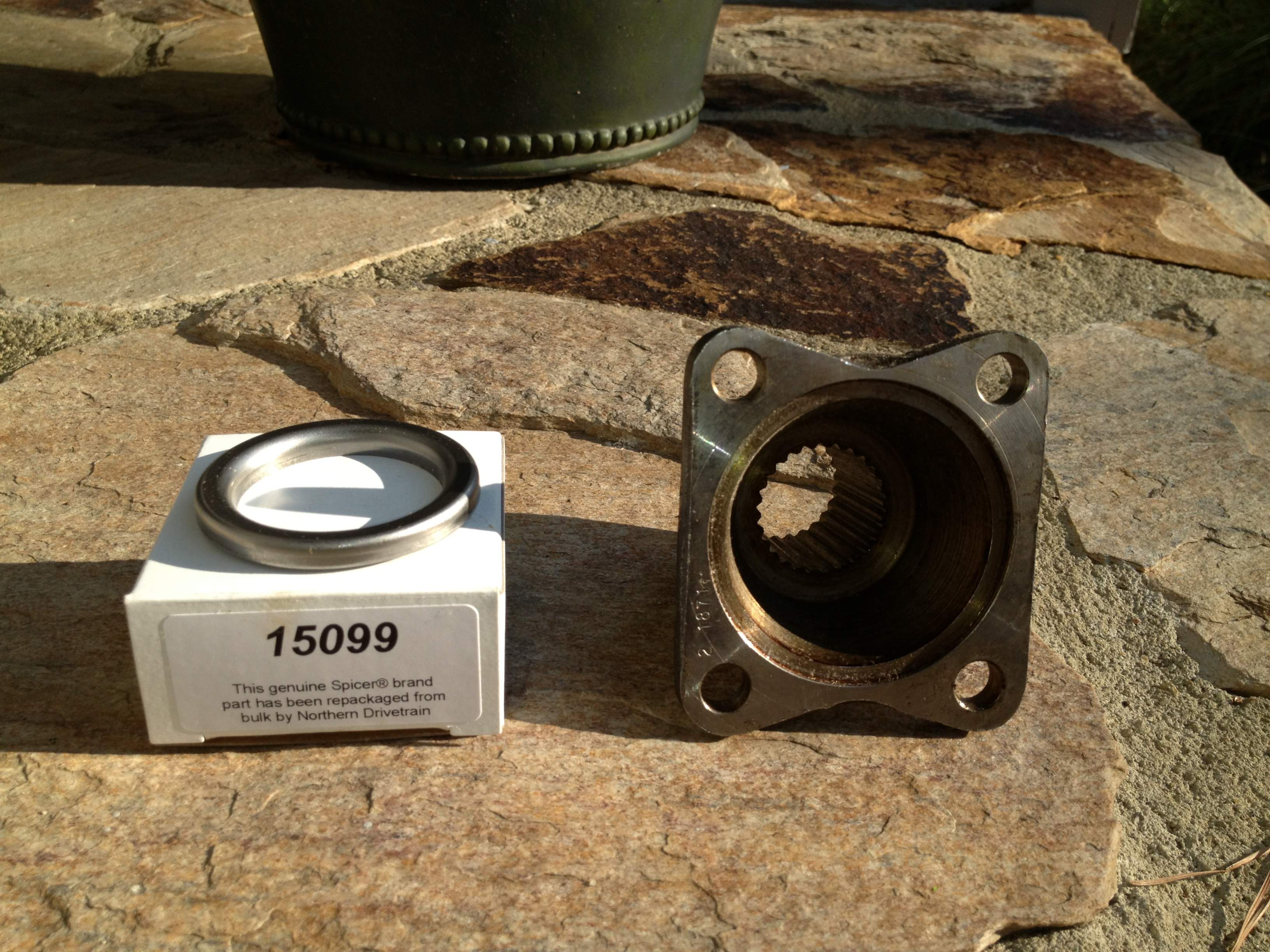

Here is a picture of the companion flange and the slinger. These parts will run around $200 to $255. You can buy them seperately or as a package. When I get the time, I will replace my damaged ones. I will go ahead and use new bolts when I do replace them, you need to buy grade 8 24 fine - probably 1 1/4 inch is my guess on length. Make sure you use something to help keep the bolts from coming loose.
