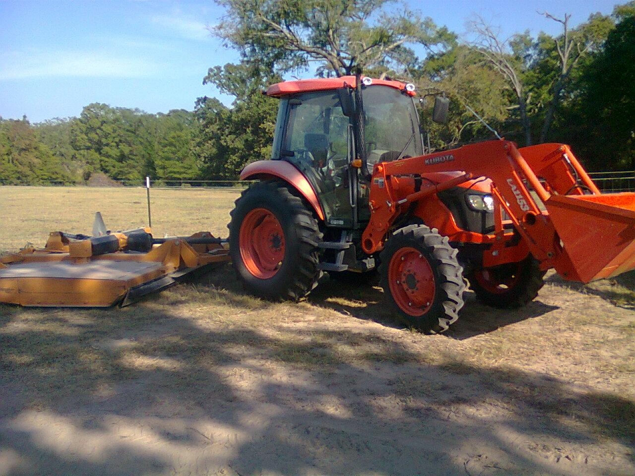

Yes sir it will pull it No problem!!! I pull a Woods DS1440 WITH MY 7040 and pull a 8ft land pride with my 5040.
One thing youll love with the Woods is the flat deck,really easy to clean up!!
Just an est.my mower has 3000ac. behind it without no problems what so ever

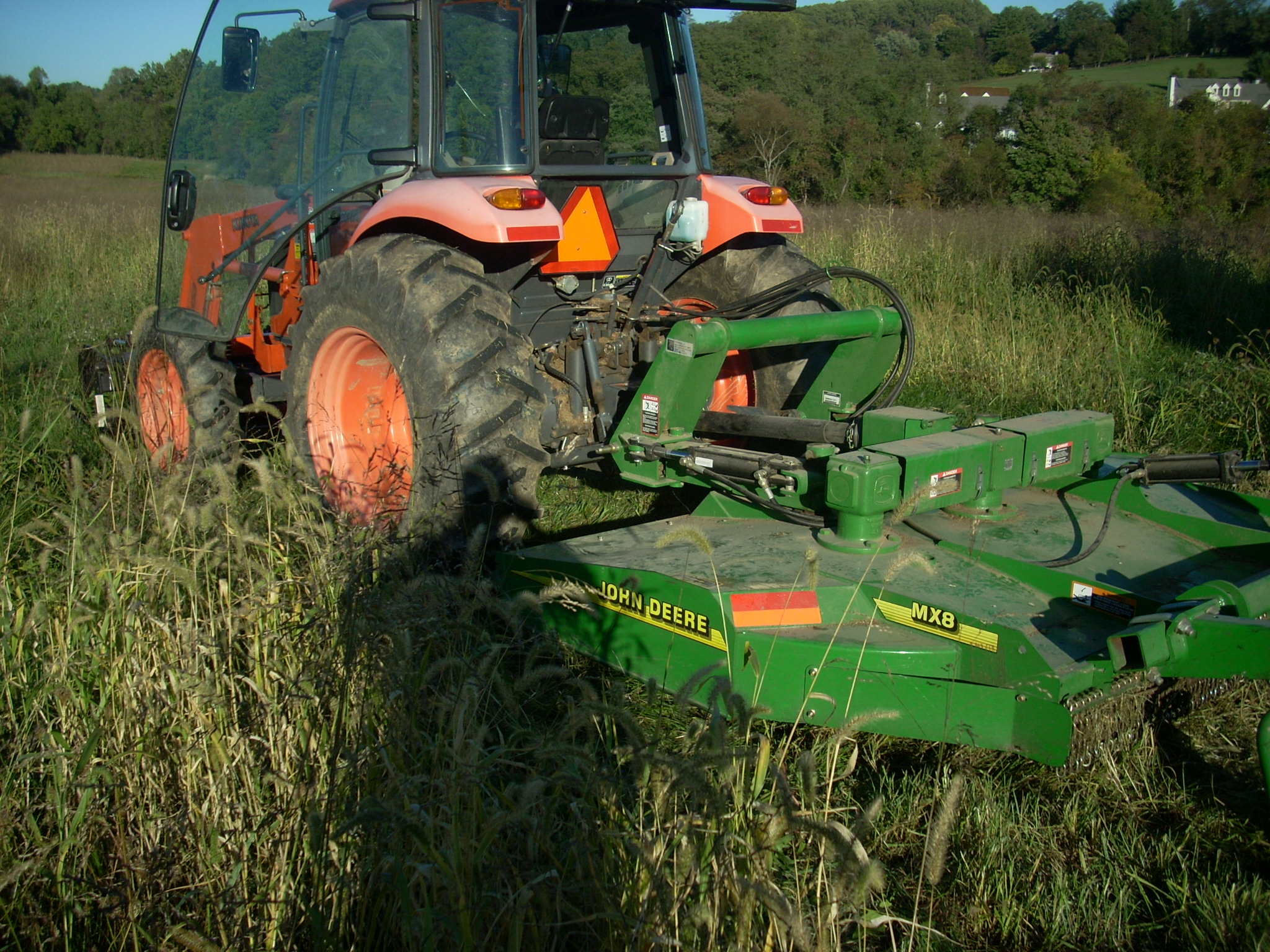

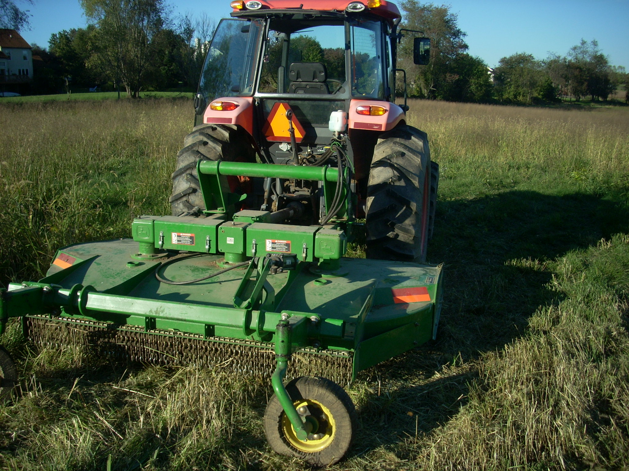

This Woods mower weighs 5,400lbs! That's as much as some 15' batwings.
My MX-8 weighs only ~ 1,800 lbs. :laughing:

Builder, do think that a 55 hp tractor would run that mx8 that your running with what 70 hp? that side shift thing looks perfect for me.
oh i forgot you must have made a mistake putting that green mower on that orange tractor?
   / Think an M-7040 can handle a Woods BW1260?
#20
Yeah, sure. 55HP will run it with no problem. I don't bog down until I have the mower set low in really thick wide-bladed grass that's 6 feet tall and even then, it only bogs down maybe 100 RPM.
The side shift is the bomb! just that extra 2' of manueverability makes it easier to transport, get through gates, avoid stumps, etc.
Ha! I'm not really brand loyal, so the green hooked up to the orange is Okay for me. So far it's been a great cutter.
