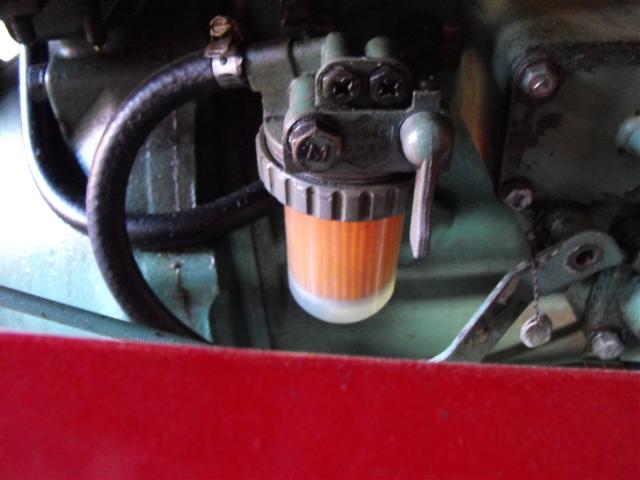

The problem was the fuel bowl. Somehow when I changed the filter and put on a new bowl the bowl did not seat all the way. It wasn't leaking any fuel but apparently was sucking just enough air into the fuel to cause the power loss and rough idle.
I'm glad you found the problem.
Looking at your photo - the line from the tank should go into the filter at the top left; ie the input to the filter assembly is the side nearest the rear of the tractor. Is yours plumbed that way?
You want the input water and crud to be visible in the bowl on the external surface of the filter, not concealed inside the filter as it loads up.
Those hoses appear to loop around to the opposite connectors.

The shut off valve on mine is on the right side looking straight at the filter. According to my manual, the tank comes in on the right to the shut off valve and the line to the pump is on the left. May be different on other models. If I put the tank line on the left I would have no way to shut off fuel to change the filter.
Something is not right with that filter assembly. Has it been disassembled and re-assembled incorrectly? The shutoff valve is on the opposite side of all others.

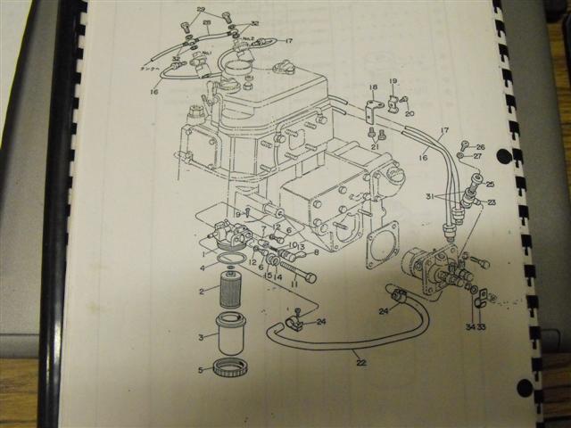

It must be something about the 1900 and 1600 tractors. The parts manual shows it on the right side with the fuel line going from the left side to the pump.

   / Think I have a fuel injector problem #28
That's really strange. I would have thought Hoye's pic came directly from the YM1900 parts manual, although it does look identical to the YM2000.

The YM1900 seems to have been a sort of fill in model between model changes. Most of the tractor is the same as 2000 but every now and then I find something a little different. I think it was used as a test platform and later refined in the following models.
I have run into a few problems with Hoye's parts for the 1900 not matching my service manual drawings. Maybe they used the drawings available to them at the time and never updated them. Still, at least they have always been able to find the right part or just let me send it back.

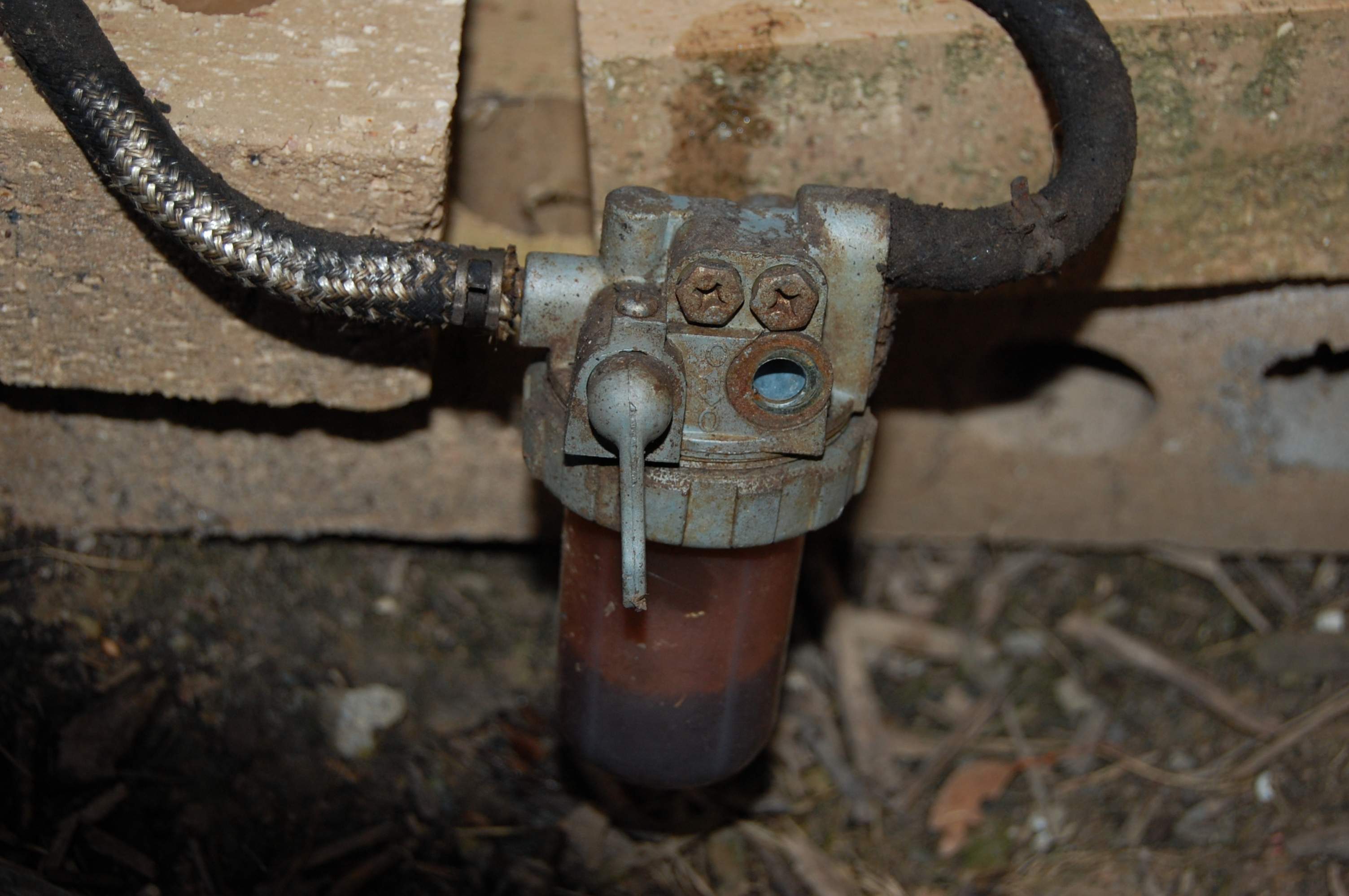

Mmm bit strange. i just checked the one i took off the YM14 and it is on the left.
