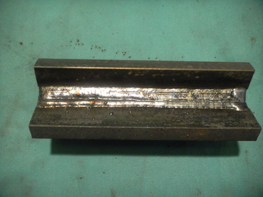

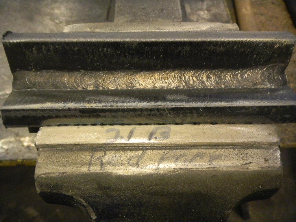

If you're going to weld outside much, I'd get a Lincoln K-126 flux core gun with the Miller adapter. And if you're not going to do any seismic code work like FEMA 353, where you can avoid T-8 wires. I'd go with Hobart's Fabshield 21-B. I can't tell you how many 1-inch V-butt side bend tests I passed with that wire. Very good general purpose wire. :thumbsup:

Good joint prep is always the key to good welds. I've never used .035 flux core, smallest is .045. I don't think they make a dual shield wire that will run on a CC only machines! I'm sure you'll need a CV machine. Just about all T-8 wires require CV. The picture I posted of the 21-B was ran with a 48-year old CC engine drive. So make sure your power source has CV!;)

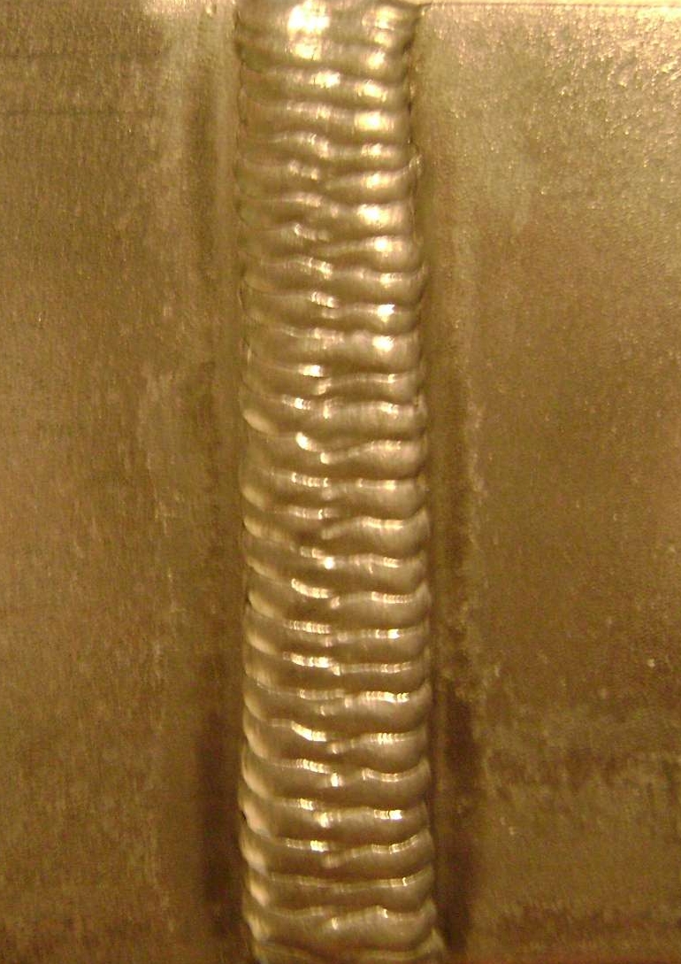

   / Thinking about a Miller 12VS Suitcase MIG unit... #17
Also remember Tom majority of dual shield wires are voltage sensitive, if the manufacture says 3/4-inch stick out, they are not kidding, do it! Another thing, dual shield wire will pick up moisture just like 7018, so store your wire in the plastic bag and in a warm place. If it does pickup moisture you can bake it in an oven just like 7018.
Dual shield can give you worm tracks, either by to much voltage, or moisture in the wire.
ESAB has a good article on worm tracks.
Worm Tracks - Causes and Cures

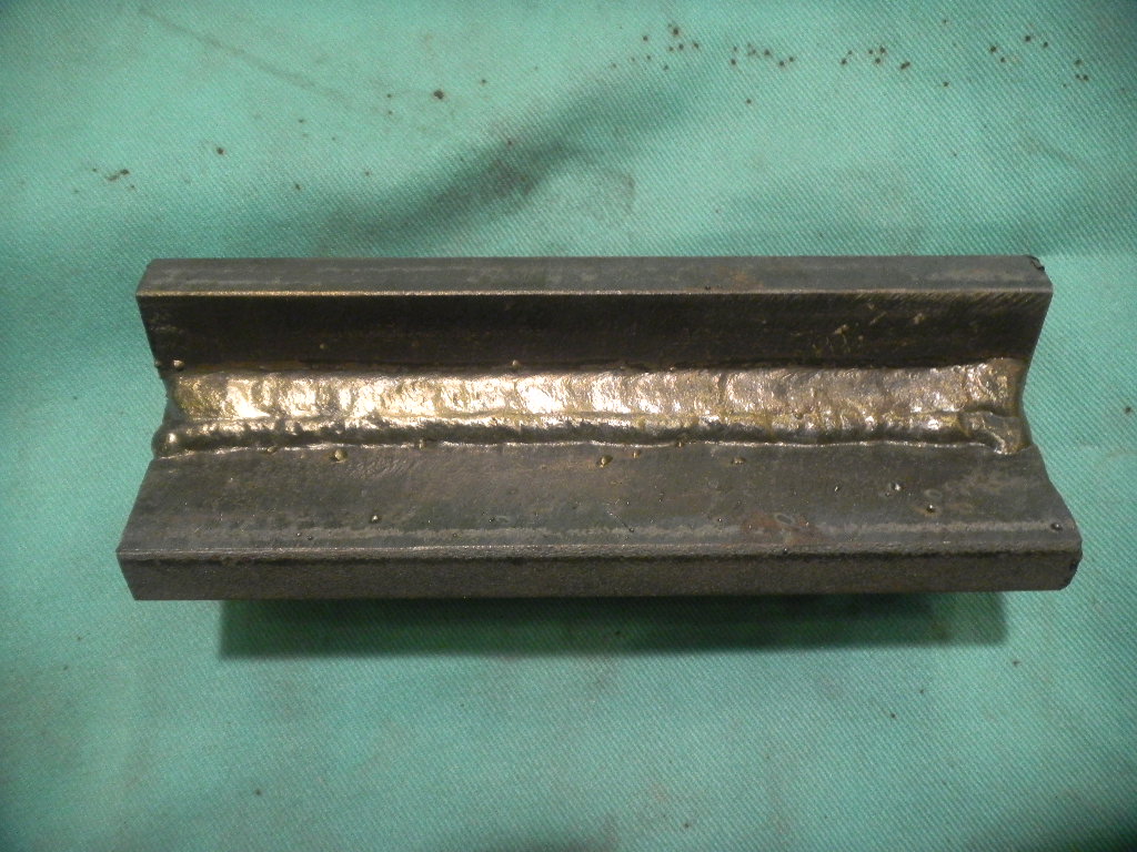

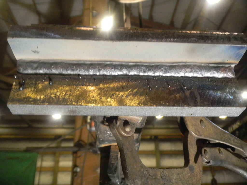

   / Thinking about a Miller 12VS Suitcase MIG unit... #20
I really like running dual shield, I always thought it was very fast. Here is an over head weld, and a vertical up I made with ESAB's 710X dual shield.
