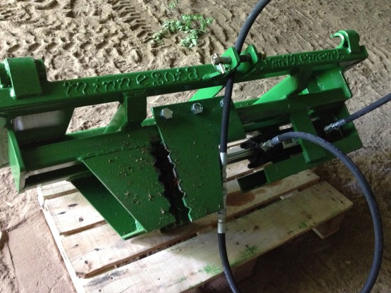

I recommend a Ratchet Rake bucket attachment for pulling out brush, NOT TREES, by the roots.
VIDEO: ratchet rake brush clearing - YouTube
Ratchet Rake will also open land for a small garden.

Tractor Supply Co. stocks the narrowest width Ratchet Rake.
The two wider width Ratchet Rakes can be ordered from the TBN Store, button at the top of this page.
