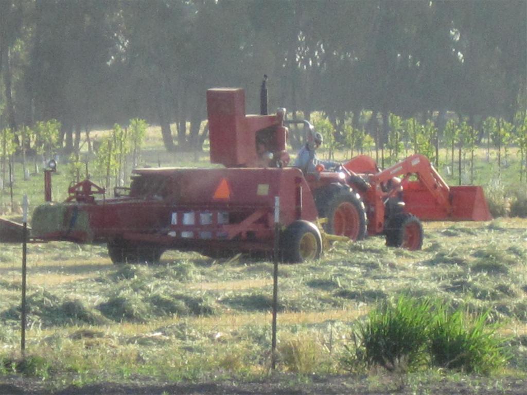

Large square? Is a 3-twine square large enough (100-120 lb bale)? If so, what my neighbor has may work for you. He bales oat hay with a 3-twine square baler that has it's own on-board drive motor (about 20 hp). He tows it around the hayfield with his Kubota L4400.

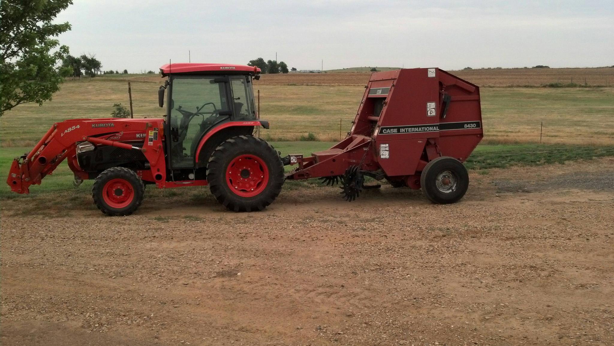

Ok I Found A Case Ih 8430 That Has New Belts, Tires,Tubes And 8 New Bearings. Looks Like A Good Unit. Electric Tie As Well. Got It Home This Weekend Hoping To Try Her Out Soon.

Good luck! Post a pic when you get the baler hooked up to the 5740.

I got her home. works great, plenty of HP. makes a nice bale. does need a little TLC.
