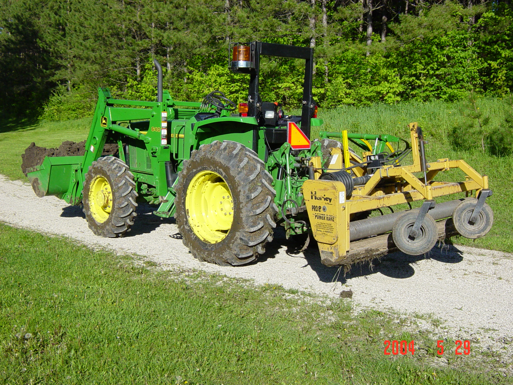

I would like a Harley rake, auger, and a few other attachments that don’t do as well on a tractor.

I have moved piles of dirt, driving over and through some, with my harley and tractor that I am not sure a SS mounted unit could have done.
My neighbour that skoffed at me having a tractor over a SS did get a harley albeit without an enclosed cab on the NH SS. The dust the operator has to endure in dry conditions is indescribable.
