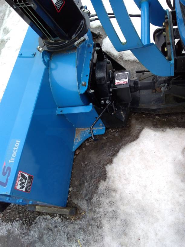

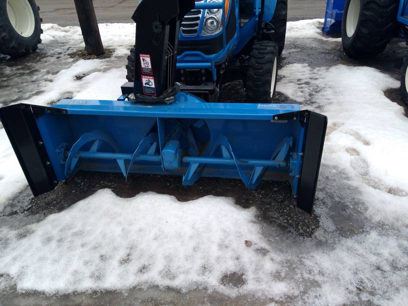

One thing is I never seen a LS front blower in person, are they comparable to name brands? Has anyone used one? Would be nice to have a factory blower for fitting and looks
   / Thinking of a XR4140HC #7
Chances are good that they use RAD or some other OEM like Kubota, Massey, Deere, etc do.
Aaron Z
   / Thinking of a XR4140HC #8
One or more members have the front blower and claim it works well and is well built. I haven't seen one and couldn't afford it at time I bought mine. Mid PTO option wasn't cheap either. In fact, I believe there is a member selling his front blower that fits my model but he's too far away. If the forks are standard SSQA they will fit.
   / Thinking of a XR4140HC #9
There is a LS dealer near work, if I have time and am bored on a lunch break, I will swing over that way and look at their snowblowers.
