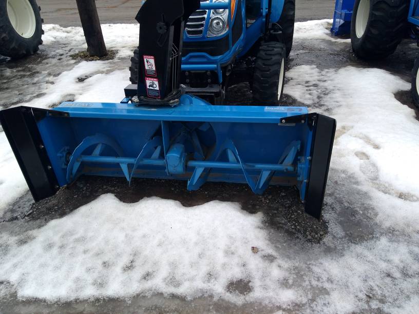

Just curious, are you getting a front snowblower? I flirted with that but decided I am going with a 3pt blower, probably inverted but not sure. I don't want to lose the use of my bucket in the winter.

Can they not coexist? The LS I looked at on the dealer lot had a snowblower, but it looked like you would just need to pop the blower off and you could put the loader back on.

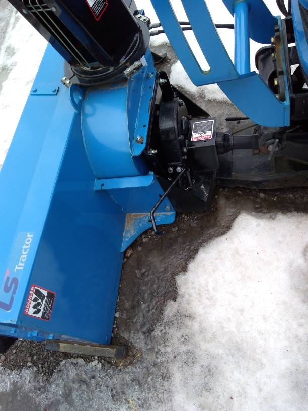

No. The blower has the subframe and PTO shaft (blower side) that has to come off (again, blower side). If you were only switching them 3 or 4 times all winter then maybe I'd think about it (probably not :) ) I would not want to do it every storm for sure. It is not a quick detach at all.

Couldn't you drop the blower, leaving the subframe and the tractor side of the blower frame on when you put the loader back on?

The dealer told me 10 minutes to attach and another 10 minutes to detach. I doubt it is that quick and easy, I have a tough enough time with the rear PTO...I am dreading a mid PTO. Doing it on my back in the cold. I am considering a SSQA blower from Bercomac but it is more money and has a gas engine. Pluses and minuses with that concept for sure.
I think I can get by without the FEL for the winter, so putting the blower on in October and keeping it on until April might be what I wind up doing. The FEL is a nice to have in the winter but a blower is a necessity. At least in my situation

We have a BX2660 which uses the same system to attach the front blade and 10 minutes sounds about right if you take your time and leave the subframe on.
It generally takes me about an hour to drop/clean the mid mount mower, remove the grill guard and install the front blade.
