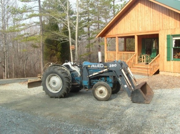

   / Thinking of an Old Massey Tractor Purchase #22
Tony, I'm just down the road in NC. Around here any 135 with PS will bring 4500-5500. Having power steering is a big plus. You have to remember that in the late 60's-early 70's, people bought tractors for farming only and few would spend the extra to get power steering. around here any tractor with PS will bring a premium price. A 135 w/o ps will bring 3500-4500. I have a gas 3000 ford with a QC Allied loader. It has ps and LPTO and I would have some harsh words for anyone who seriously offered me 6000.00 I would probally tell him where the bus stops. I understand this tractor is at a dealers lot, and we feel free to insult a dealer anytime, but just keep in mind he knows what he has and what it's worth. HTH, later, Nat
