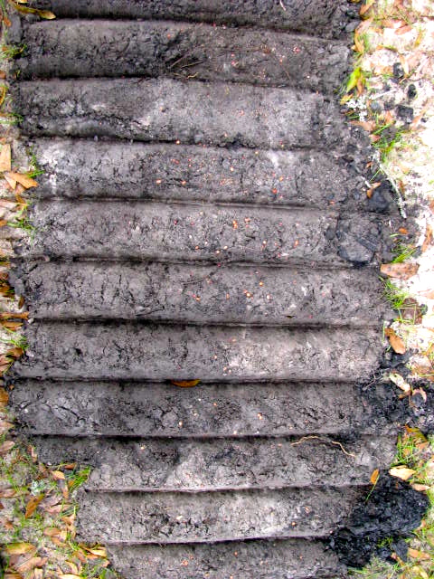

A Disc Harrow will chop up existing cover and do some leveling with each pass. Disc Harrow is a good mixer.
A Cultipacker, to roll in seed and PREVENT EROSION should be on your list.
The Disc Harrow can chop up each season's remains. Most seed for food plots are also used in Green Manure/Cover Crop seed mixes, usually very strong germinators.
Disc Harrow, not quite a plow, not quite a tiller; faster than both.
