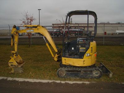

Thanks for the Thumb advice, I have looked on EBAY, and other websites and have found numerous vendors, and then JD sells one....
Can anyone recomend a good reputable vendor? Or should I get the JD one?

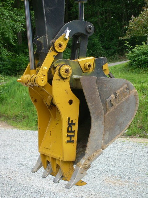

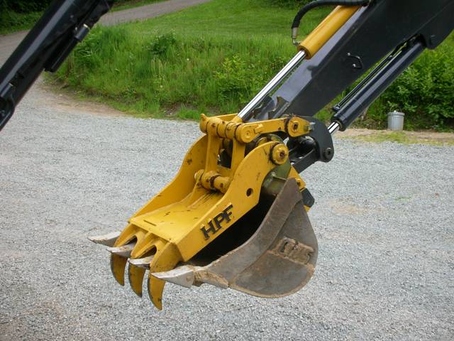

I did check with the JD dealer, the entire "JD thumb kit" is $1,500.
   / Thinking of Buying Mini Excavator--Need Help #24
If you're on a budget than JD will do. However, if you can spend 3-4k then the above thumb by HPF is great for minis. The JD thumbs are ok but they aren't as strong IMO.
   / Thinking of Buying Mini Excavator--Need Help #25
On the thumb, you need to know what you want it for. Might sound dumb but I do not like the one shown above. Not sure I have ever seen a flat thumb used and there may be a use where it is great. But if you will be lifting rounded stuff (trees or stumps) think such design will limit you. Local shop who builds thumbs built mine with a curve (buckets are not curved that I have or seen) so I could cradle a log or logs between the thumb and bucket. It works great. For little stuff (like 3 inches or less it does not clamp them tightly but I can grasp and wrap around a tree of about 18 inches and not depend on just the teeth to hold it. Again on the thumb design above for some stuff it probably is the best, just don't think it would be larger rounded items.

Kthompson is correct to a degree.
It really is personal preference. You generally don't grab trees in the middle of the thumb. You clamp down on the tree with the teeth of both the thumb teeth and bucket teeth. But again, it's more personal preference. I've never had a problem with the HPF or CWS thumbs, both of which are similar in design. I actually don't like curved thumbs too much but again, it's personal preference.

Well, sorta...
If you want to use the tree trunk for any purpose other than firewood or pulp, you do not want to grab it between the bucket teeth and the teeth on the thumb. The immense pressure exerted by the small area of the teeth will splinter the log internally -- been there, done that, when clearing my lot. We lost three nice white pine sawlogs of 24" plus, because the trackhoe operator squeezed them too tightly with the bucket teeth. Though there wasn't much damage visible from the outside, when we sawed the first slab off each one, we could see that the whole inside was cracked and splintered...
There's a reason why most logging equipment and knucklebooms use curved "fingers" instead of teeth...
IMO, you only grab a tree trunk with the teeth when you're trying to pull something out of the ground (but why, since nosing it over away from you generally works better?) or if you're trying to bite/break it into. You can snap 8" to 12" pines like pencils, to pile them, with a decent sized trackhoe...
