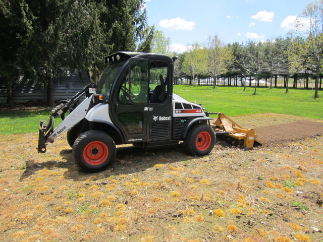

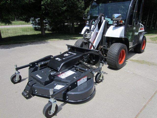

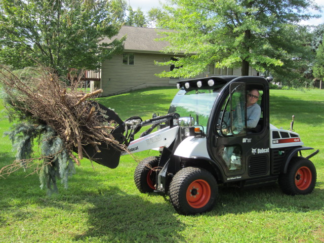

This is why I traded my tractor in on a Bobcat 5610 Toolcat. It has a built-in loader arm and is only about 11ft long with no attachment. I have hi-flow and it runs my 72" front finish mower. Out back it has a 3pt hitch so I can run my rear snowblower, tiller, rear blade, and rotary cutter. It has 4 wheel steering and turns very sharp without disturbing the yard. They are not cheap though.
View attachment 615645View attachment 615648View attachment 615649
That just might be the best solutioin for those that want to afford it. Most of the power of a large tractor in a small package and more maneuverable than a track loader. 4 wheel steering and real 4wd too.
