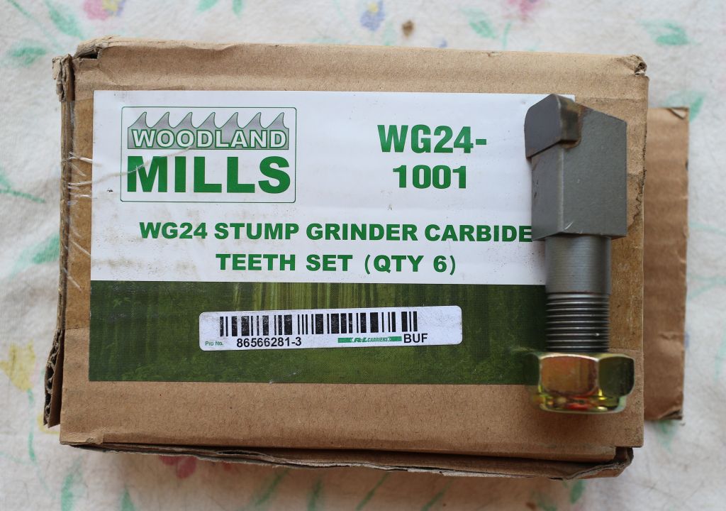

Do you know what brand of cutting teeth are on it? I have heard the green teeth brand seems to hold up well and are reasonably priced?
   / Thinking of getting into stump grinding #36
The spare teeth come in a generic box (I got a dozen extra). I do know that the carbide can generally be had for three bucks per, if you are the sort to braze them onto the teeth, and you can certainly sharpen these a time or two.
