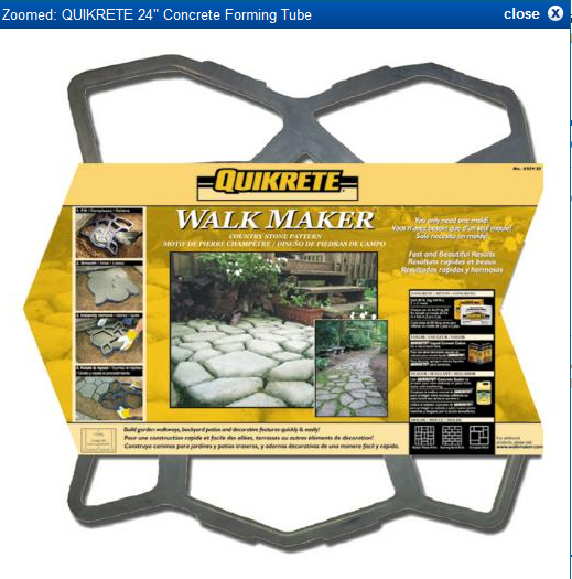

There is another option using concrete that will let you work at your own pace and give a paving stone appearance.
I used these forms to make a sidewalk. I bought a little electric ement mixer so didn't have to mix by hand in wheel barrow, used 3 forms after I got started. Fill each form and let set until concrete sets enough to hold shape the move and repeat until done. After it set and dried over the week, I used dry mix portland (cement), masonry, and little sand poured it over the blocks swept into the cracks then misted it down with garden hose sprinkler.
You can get more creative by adding color to the concrete and/or the grout.
