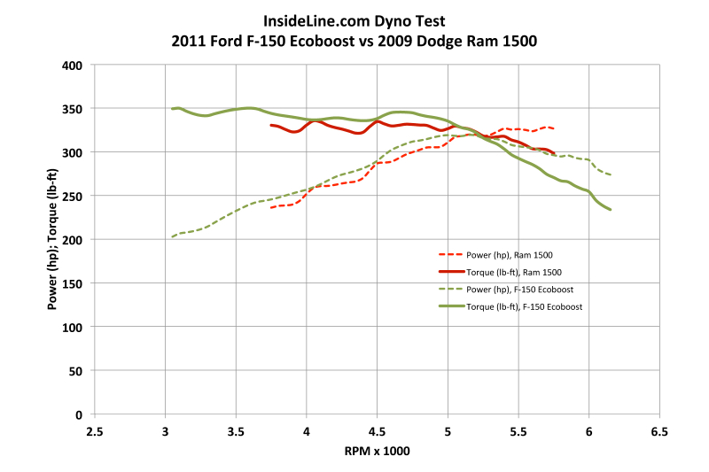

How many did you build from the castings up, direct injection, variable valve timing, etc? I guess you are saying the ford engineers figured out something you couldn't in "hundreds" of attempts.
You are completely WRONG in your HP and torque comparison. You have it completely backwards. Maybe now I understand why you are often misquoting and not grasping this. A dyno measures torque. HP is calculated from this torque number. The formula is HP = (torque * rpm) / 5252. If you look at a dyno printout, HP and torque are always equal at 5252 rpms. This is why your beloved hemi makes more HP but less torque than the ecoboost. The hemi is revving high to produce HP and the ecoboost is producing torque at much lowers revs. The hemi will benefit with the new 8 speed by allowing the engine to stay at high rpms but who wants to listen to an engine run at high rpms towing all day. I am surprised you don't understand torque is measured and HP is calculated after your "hundreds" of engine builds.
The HP formula also explains why diesel engines HP to torque spread is so wide, very few can rev up to 5252 rpms. Diesel engines benefit from many gears because of their narrow rpm range. Torque at low rpms is good for towing and torque at high rpms is good for racing.
Here is a copy of the two dynos on the same scale. Unfortunately, the dyno isn't showing the hemi below 3700 rpms because that is where it flounders and the ecoboost shines.

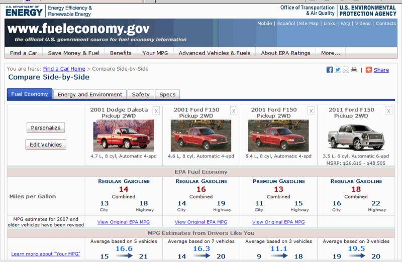

Comparing 2001 engines:
Dodge 4.7 liter 230 HP/ 295 torque
Ford 4.6 liter 248 HP/ 294 torque
Ford 5.4 liter 260 HP/ 350 torque
WTH was I thinking back in 2001? The f150 was better then too. Lol. I just liked the look of the Dakota quad cab and didn't look at mpg.
The point being, why is the 4.7 liter even offered in the ram when it gets worse mileage and less power? Answer: they have to have an upgraded engine it offer.
