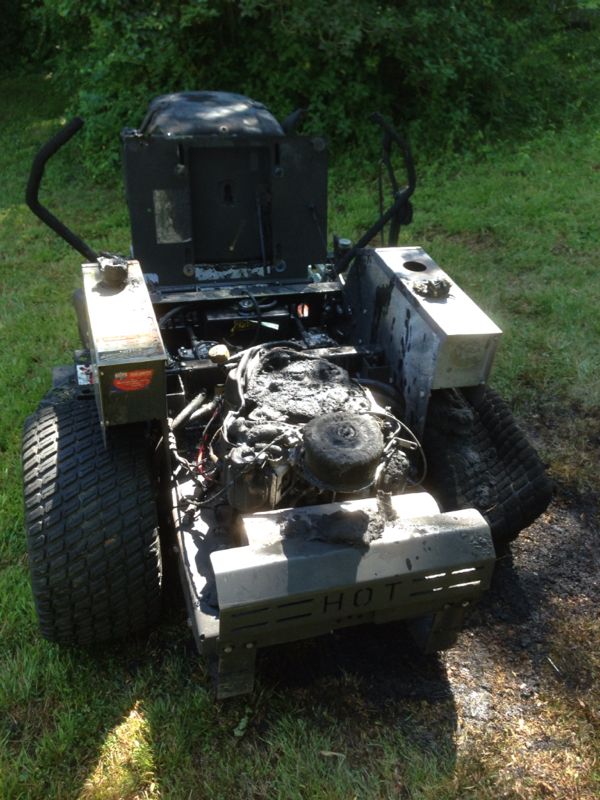

Yes. See here for an example. I mowed my lawn for many years with a Cub Cadet riding mower given to me by a neighbor. Somebody had filled it with a metal can, and rust particles had destroyed the fuel pump. I replaced the filter, lines, and pump and it was fine. I won't have a metal can on my property, and my one current vehicle that has a metal tank will have it replaced with plastic when (not if) it needs it. I don't plan to ever have another steel tank. Plastic doesn't rust.
But they do melt. This fire would have likely been contained had the plastic tank not dumped onto the fire.

Yes, they do melt. Probably a better option than having a seam rupture or worse, exploding, as metal tanks are prone to do.
