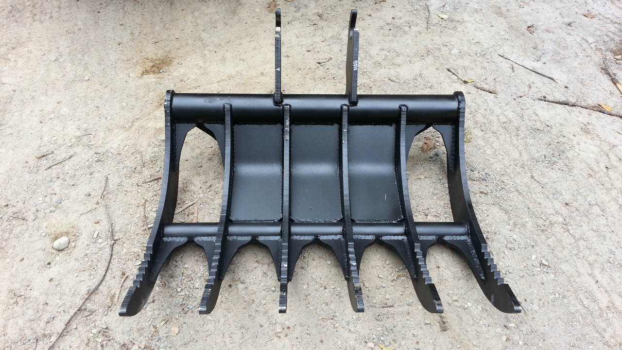

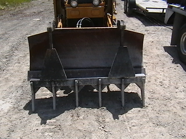

You're doing the same thing I'm doing, cleaning up the land. My Mitsubishi is also a grey market unit which correlates to Caterpillar, and yes, there isn't one single label or nameplate that I can read :laughing:. I installed a hydraulic thumb and a quick-hitch for the different buckets and the rake. It's a 3.5 ton machine and can do a ton of work, yet light enough to be hauled around with my 1-ton pickup and 14,000 lb. trailer.
Grey market units are almost always cheaper to purchase because of prejudices, unfounded fears, and preferences. FWIW, my little Chinese dozer with the root rake on the blade makes short work of underbrush, but the rake I got for the mini-ex combined with the thumb is the bomb.
